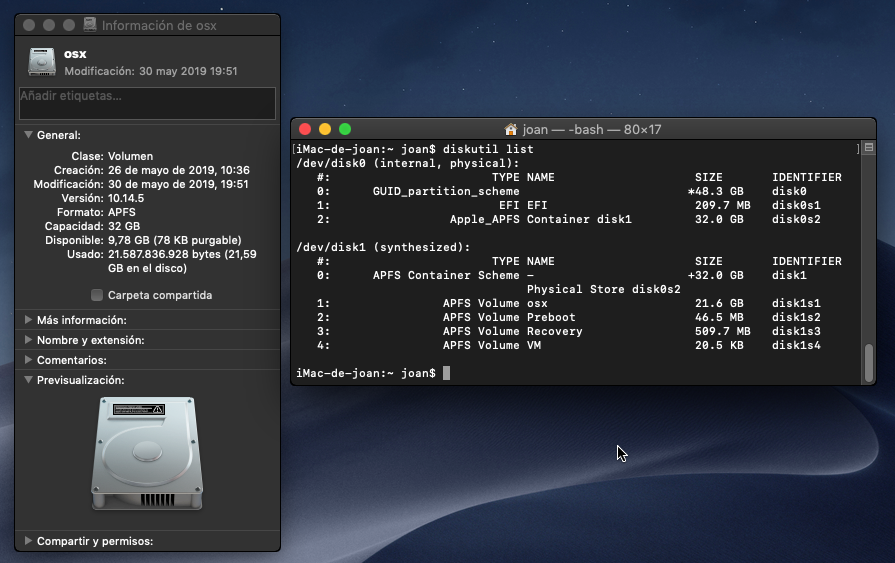

15 hours ago, zzgus said:
About Catalina...
After downloading catalina I'm unable to install because I have not free space on hd.
I have increased vdisk with this command:
"qemu-img resize /path_to_vdisk/vdisk1.img +15G"
and I can see on unraid vdisk has increased from 30 to 45GB.
But how do I increase the hd inside mac os?
Thankyou
Gus
diskutil apfs resizeContainer disk0s2 0
In this case, diskutil automatically claims all available free space on the physical storage device, but you can also replace 0 with a size value, if you want a specific one

I have run the comand and I have seen a progress bar but when I see the hd inside vm has the same size as before.
Thankyou
Gus
**** SOLVED ****
As @glennv pointed with:
diskutil repairDisk /dev/disk0
diskutil apfs resizeContainer disk0s2 48G
Edited by zzgus
run it with specifying size. Using a zero never worked for me.
So for example : diskutil apfs resizeContainer disk0s2 48G
rem: if you get an error complaining about partition map too small, run "diskutil repairDisk /dev/disk0" and then retry the resize. You typicaly get this error if you use the diskutil gui version to resize the container. Running this command before fixes that.
