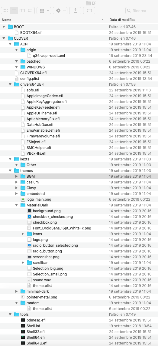

Here is my EFI folder structure, and kexts (my kexts are installed is /Library/Extensions/):
As far as I know, the "scanning entries" issue can be related to:
- Clover is not able to load drivers <-- Incorrect folder structure
- AudioDxe is in your Drivers64UEFI folder <-- At the moment it seems not to be compatible

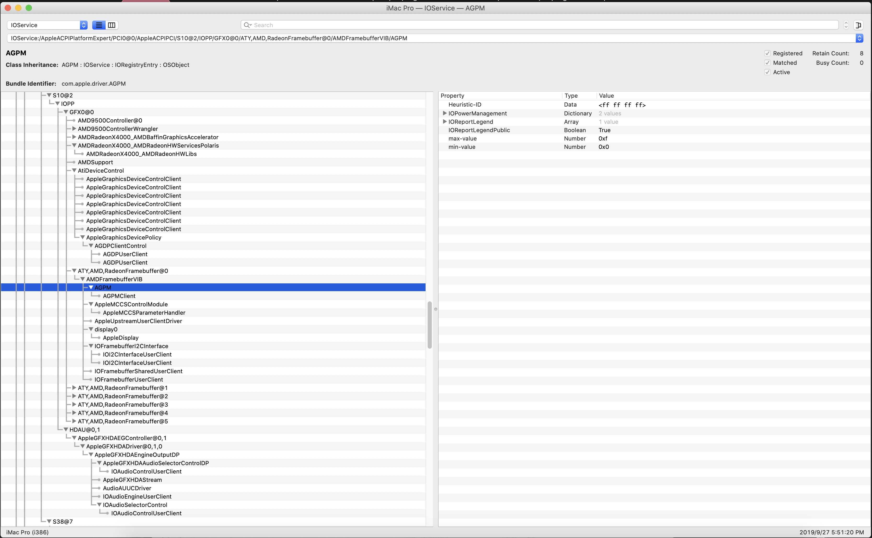

  1. smbios is definately import for those who want GPU acceralation works. For Hackintosh VM (which don't have iGPU), the MacPro7,1 and iMacPro1,1 is best choices.
  2. you need clover patch to avoid black screen for amd graphics(see the post before)

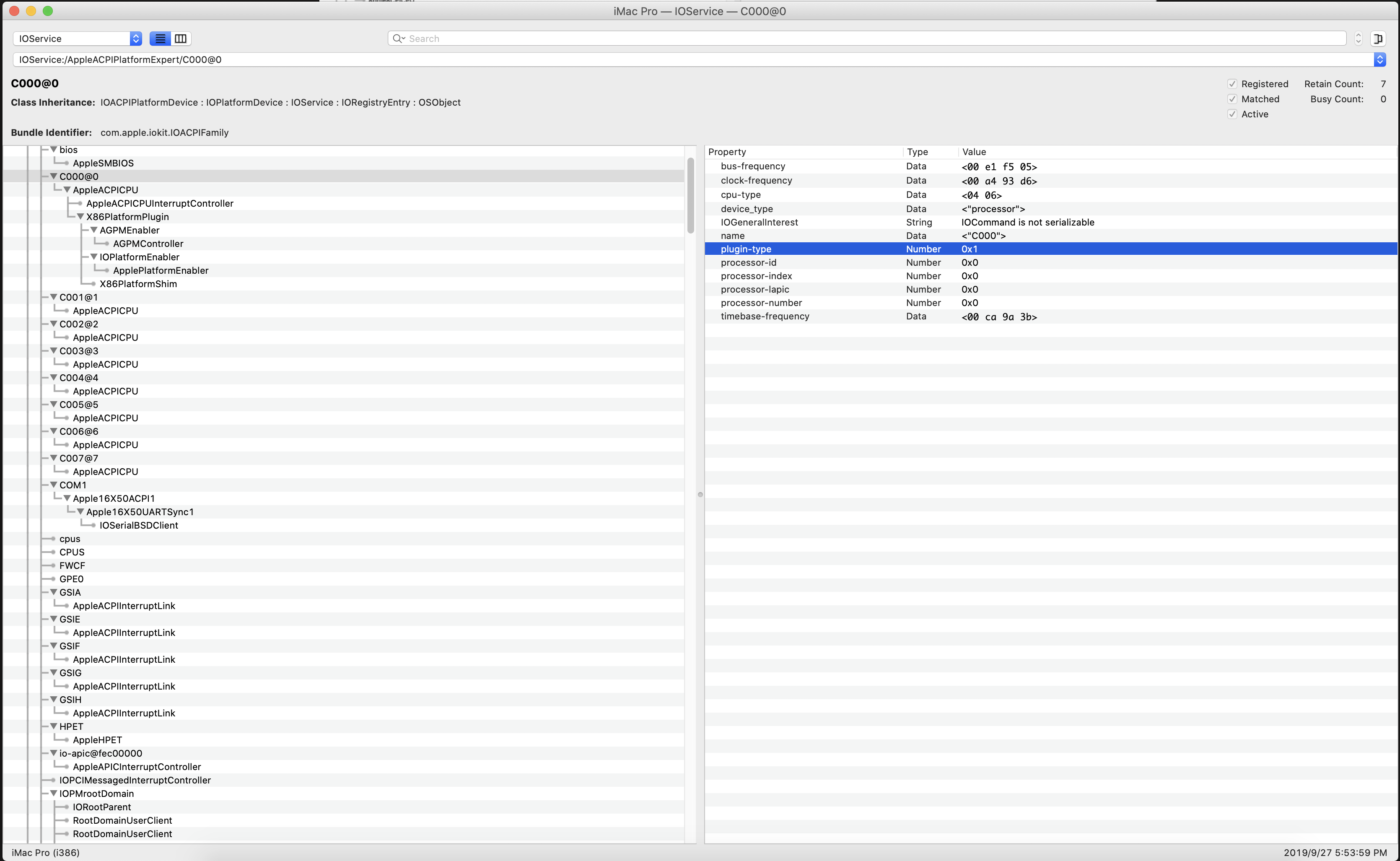

  3. you need select "Add DTGP" and "Fix dispaly" to make sure you graphics is under GFX0 position of ACPI, this will make HW Acceralation happened.
    1. WEG won't work fine in VM, because the ACPI is different compared to Native MB.
    2. Check you graphic position using IORegistryExplorer
    3. If not under GFX0, the HEVC will not work.
  4. If something wrong, then Lilu and WEG is needed.

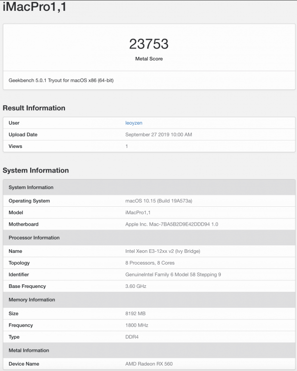

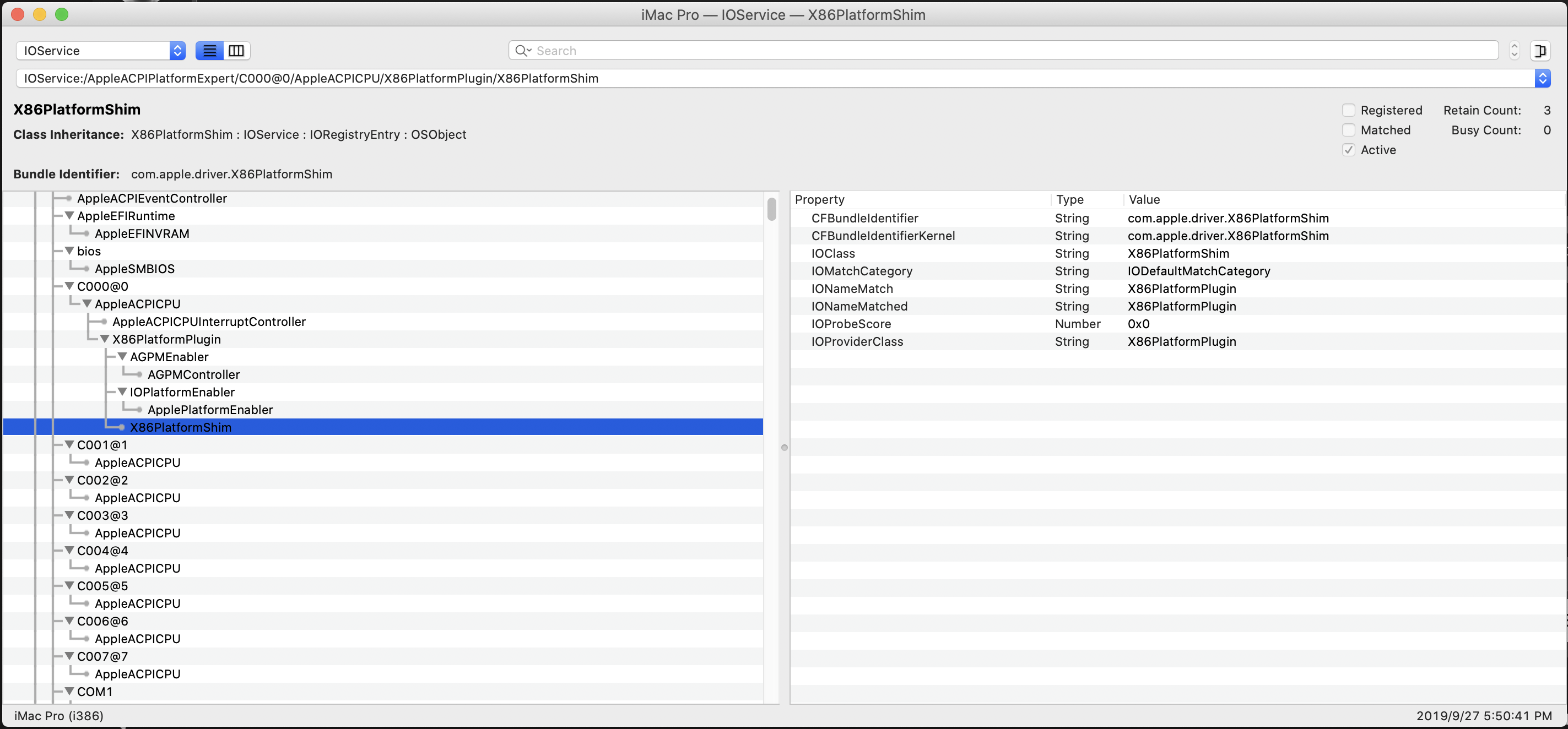

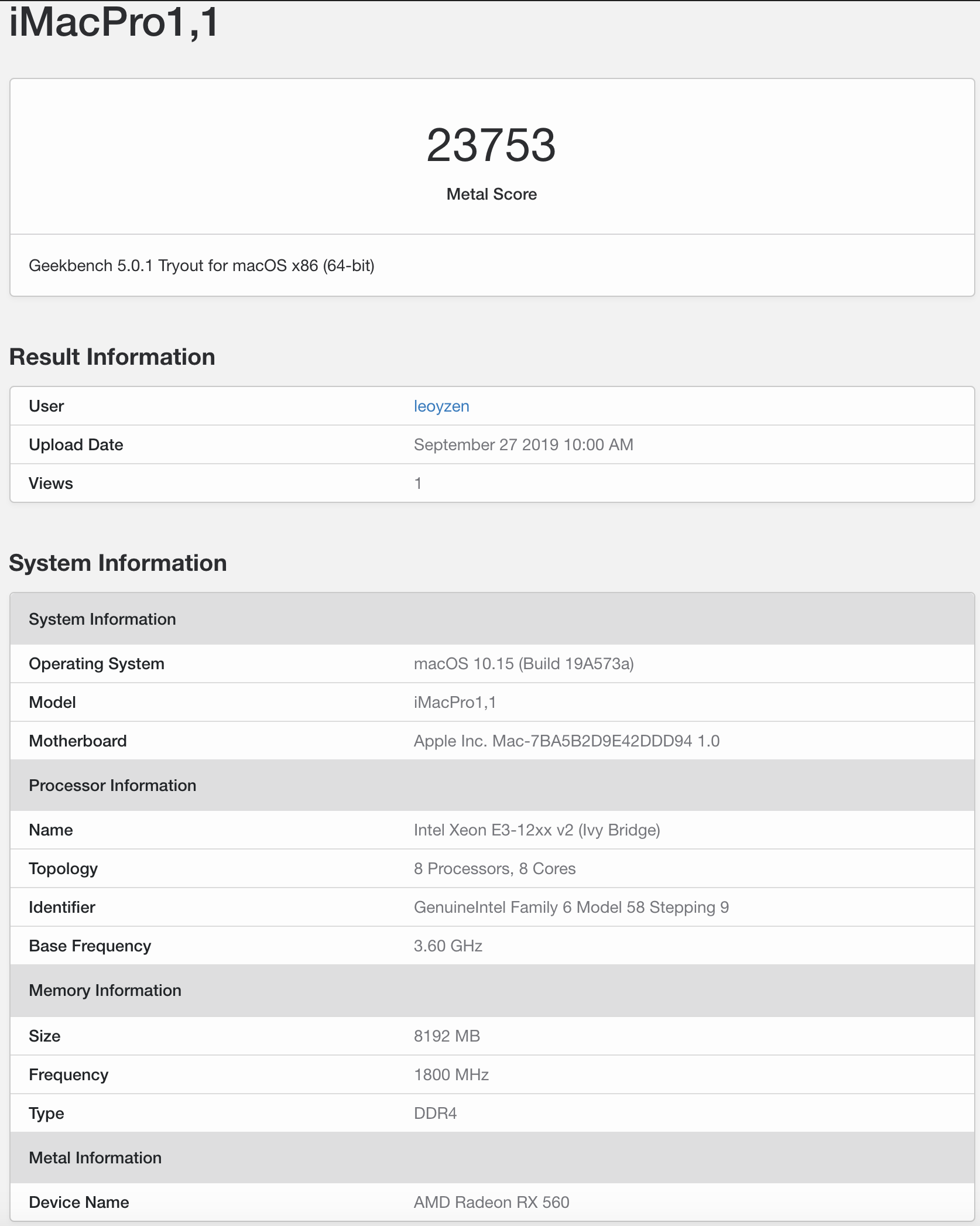

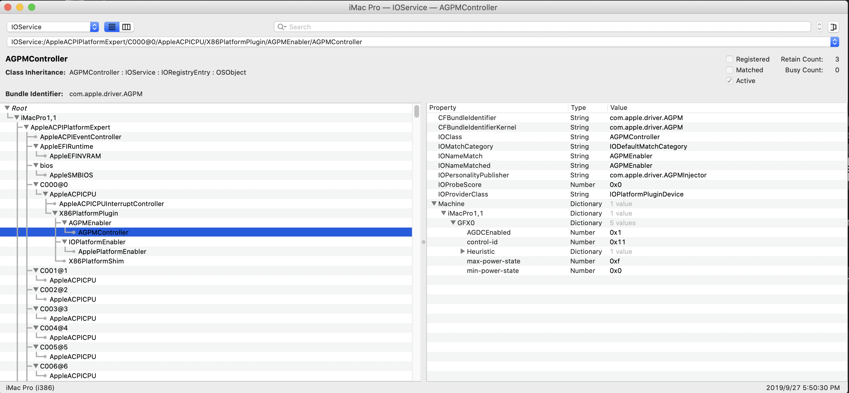

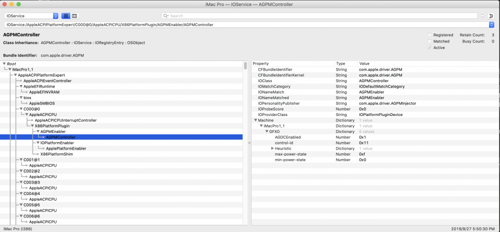

Got my VM running the opencore right now and added all my SMBIOS stuff from my clover to it. Reading up on it using the opencore vanilla guide.

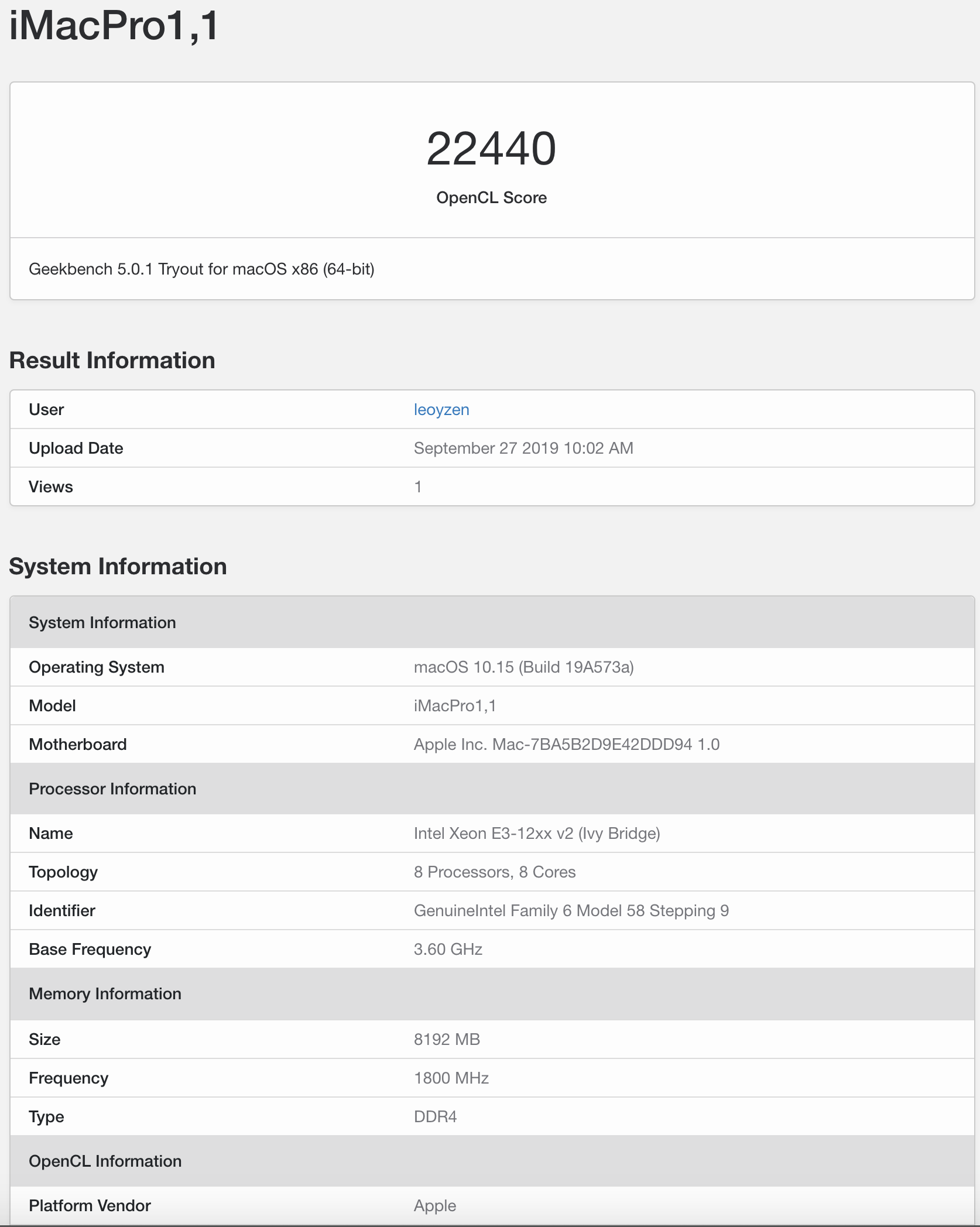

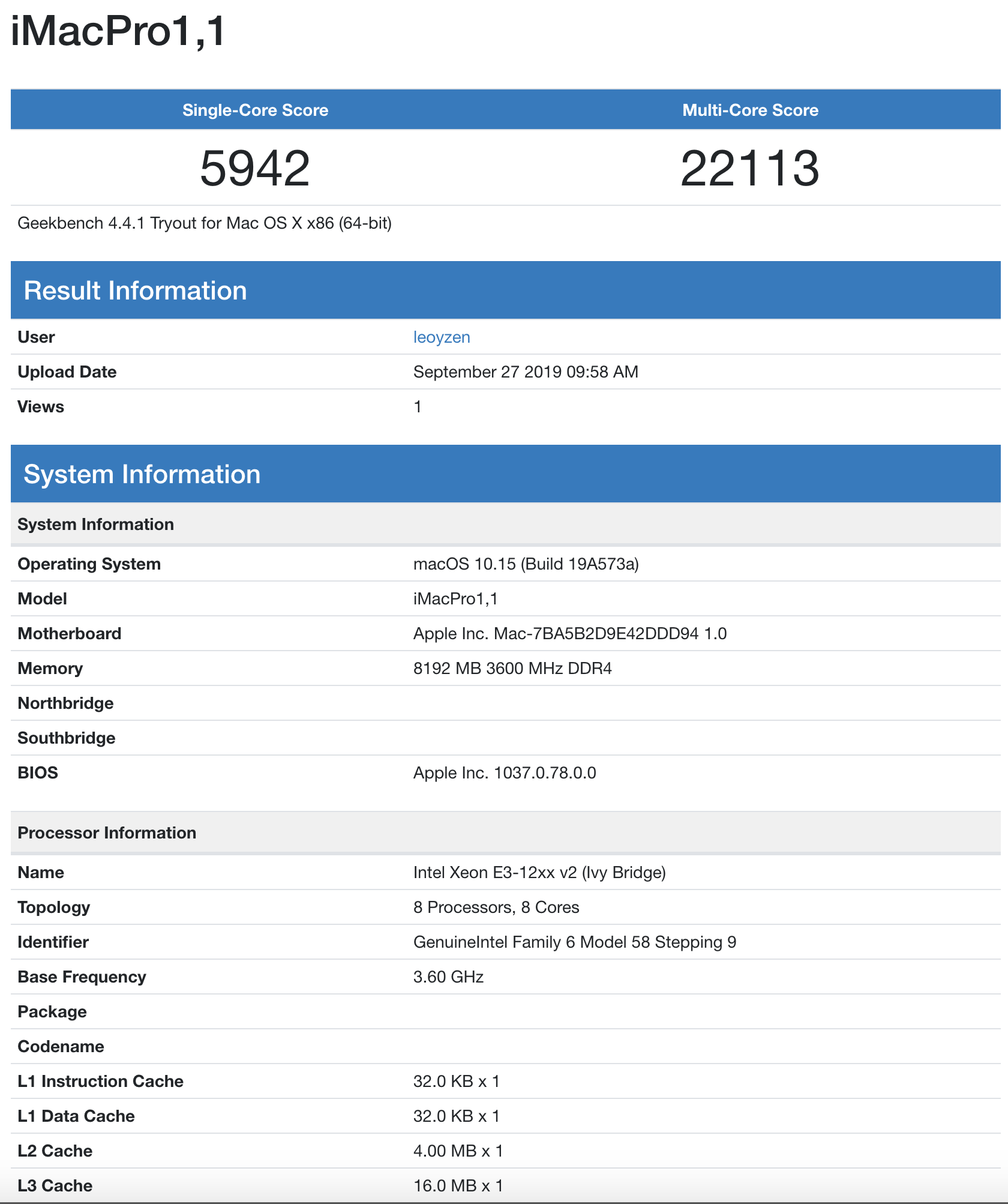

Finally get native Discrete Card Power Manager works....Will see if there is any problems.
Fan speed finally get spins and works....Let's see if there any performance gains.
Edit:
After all, we finally get a nearly bare metal performance, I'm very happy with that.
I will go on vocation for about 2 weeks.After that I will make a turtorial about all these days works. TO BE CONTINUE!
Edit:
The attachment is my opencore efi qcow2 image, works properly both mojave and catalina.
All you have to do is make sure your graphics is under ACPI S08 and make sure SMBIos changes to yours.
If not under S08, you have to modify the SSDT-1.aml to your graphics location.
Have fun!

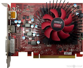

I have the same card but I don't use it for now....
The card is strange after flash rx560 bios....I don't know if the card or rx460 work or not....My rx460(flashed rx560 BIOS) works fine for now.
