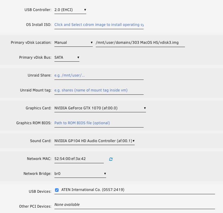

I was able to get the cloned MacOS vm up and running with Mac a flashed Nvidia GTX1070 GPU.
How to passthru USB devices? I see no option on "Other PCI Devices". Ticking "ATEN ........" did not change anything.
Cheers,
Frode
USB Devices would not show under Other PCI Devices unless you were passing through a USB controller card and had specified something like vfio-pci.ids=xxxx:xxxx in the bzimage append line on the boot flash drive.
