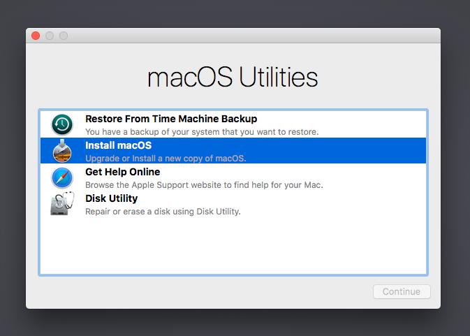

Hi guys, I've gone through the video and double checked everything, I've done the Disk Utility Erase and I'm at the point where you select 'Install macOS'. The problem I'm having is after I press continue, it does nothing but the continue button is greyed out. For example I can click other selections but nothing ever seems to happen. I'm using High Sierra. Looks like this:
How do I get it to move on? I've tried restarting several times, tried double clicking instead of select then continue. I don't know what it's problem is.
Edit: one thing I note is that because I tried APFS the first time, I can't go back to HFS for whatever reason. The vdisk is on an NVMe cache though so I thought that APFS would be fine.

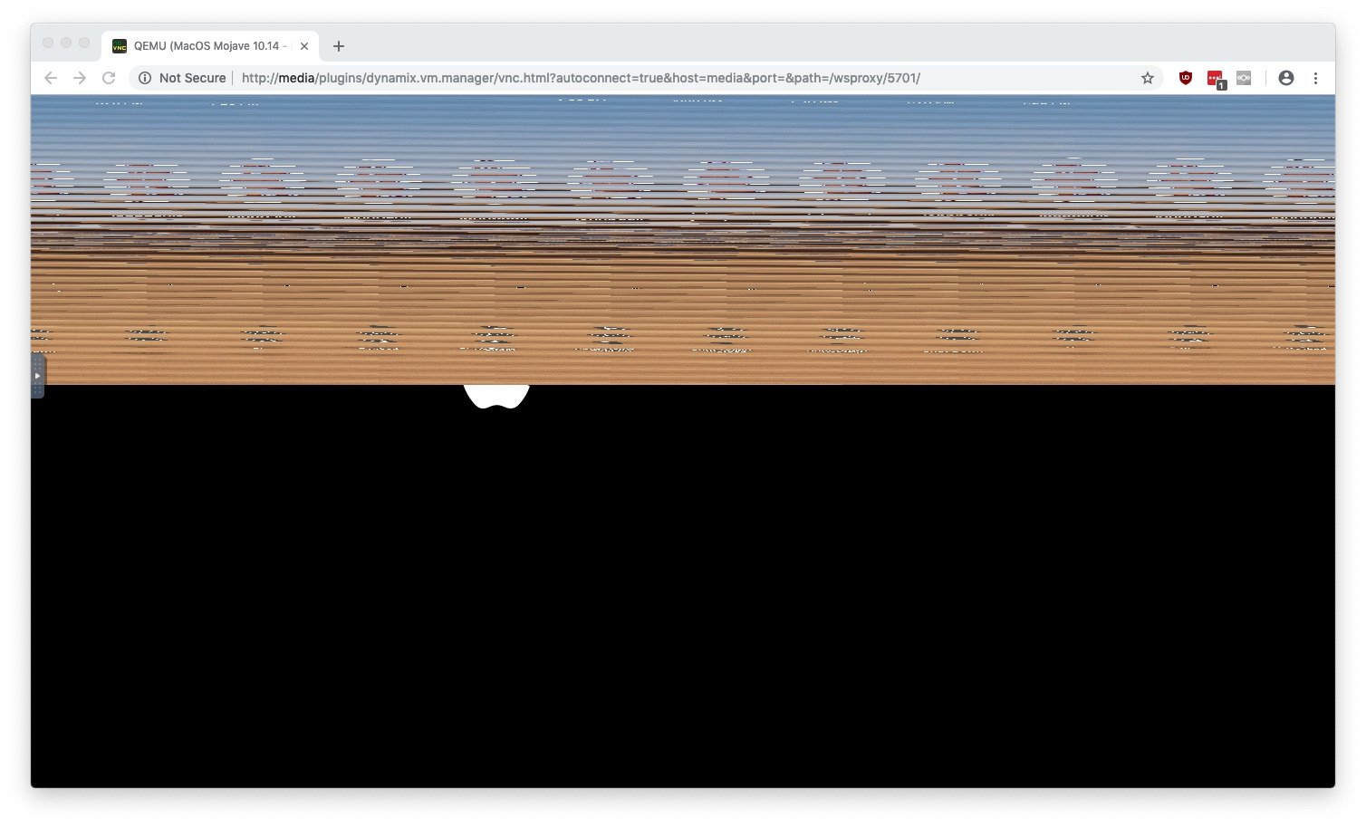

I followed the video and had Mojave working fine. I've since upgraded to 6.7.0 and tried to start the VM today. When I connect to it, I see like 10 copies of it. I'm not sure what caused this or how to fix it.
Go back and check your resolution in OVMF. Make sure it matches your clover resolution.
