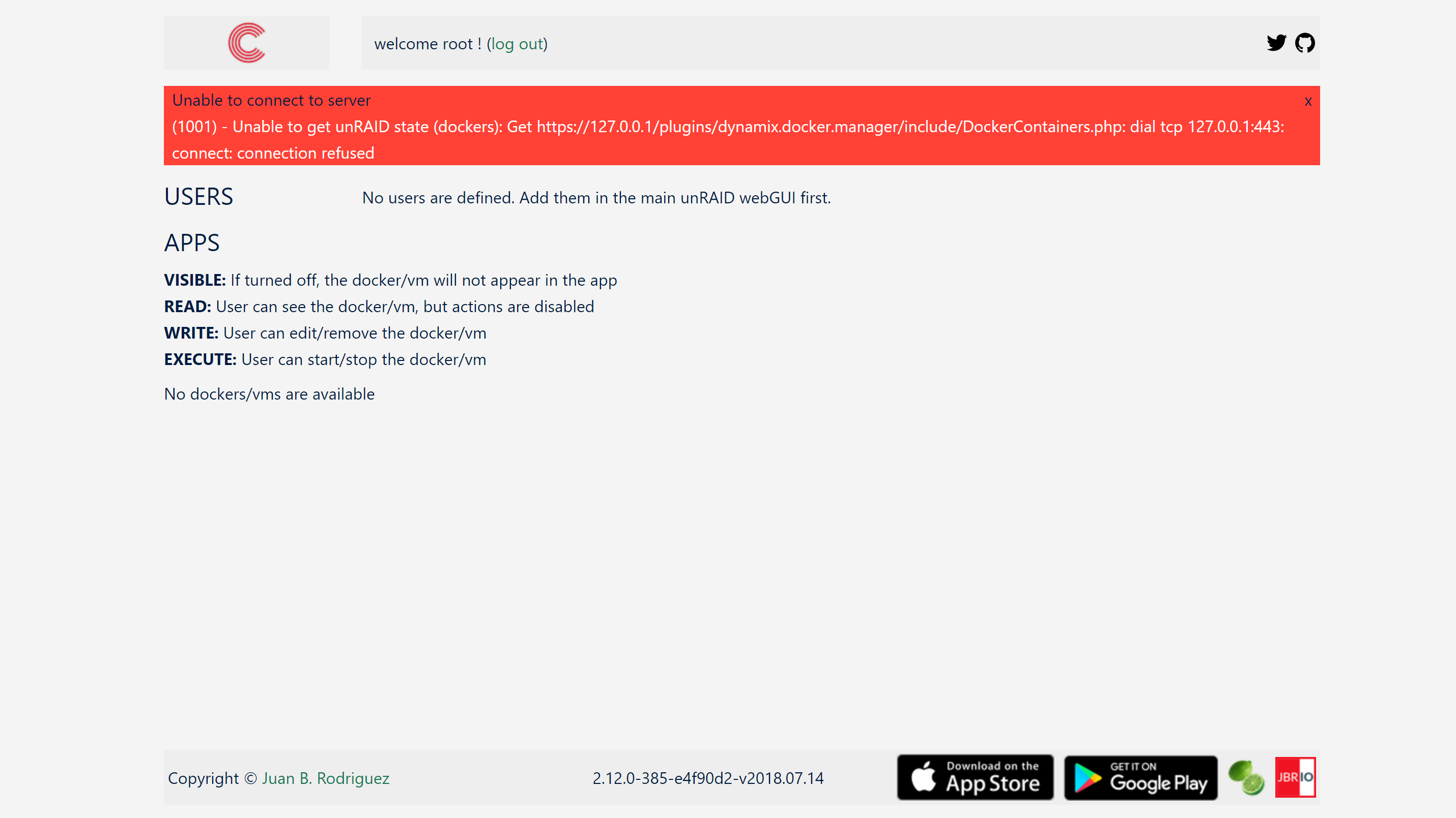

jmello Posted August 8, 2018 Share Posted August 8, 2018 (edited) I may be having the same problem as plantsandbinary, I'm unable to connect to controlr from my server. I have attached a screenshot and copy of the log file. edit: Running unraid 6.5.3. controlr.log Edited August 8, 2018 by jmello Quote Link to comment
jbrodriguez Posted August 8, 2018 Author Share Posted August 8, 2018 Hi, thanks for the shots/logs. I'm a bit confused about the 127.0.0.1 address. Do you access the server from the server itself ? What I mean is, it looks you're running a browser on the server itself (maybe a docker ??) If you access the webGUI from another machine (desktop, laptop) does it work ? Quote Link to comment
jbrodriguez Posted August 9, 2018 Author Share Posted August 9, 2018 I was looking into it some more. The localhost address is fine. Can you tell me - your SSL settings (auto/yes/no) - did you change the https port (443 by default) ? - your unRAID version Quote Link to comment
VirtualL Posted August 21, 2018 Share Posted August 21, 2018 Hi. I have same problem like @jmello I am using Unraid : 6.5.3 ControlIR webgui 2.12 controlr.logUse SSL/TLS: Auto logs : in files have been NOT changed the Unraid access management ports 433 or 80 But i am using NGINX with the Let Encrypted Container. And changed pprt 443->1443 80->180 p.s As you can see in the second pic , the port that the Web UI is using its 2379 and not 2378 (I am not change it ) THANK YOU Quote Link to comment
jbrodriguez Posted August 21, 2018 Author Share Posted August 21, 2018 Thanks. So, it seems to be some kind of port detection issue. I'll take a look. Quote Link to comment
jbrodriguez Posted August 22, 2018 Author Share Posted August 22, 2018 So, I'm trying to figure out who "owns" port 80/443 (and 180/1443). Can you run (on the server) lsof -i :80 lsof -i :180 lsof -i :443 lsof -i :1443 also, can you send me your /boot/config/ident.cfg ? (it has no private info except for the server name if I recall correctly, but delete anything you want except port numbers and ssl settings if you please) Quote Link to comment
VirtualL Posted August 23, 2018 Share Posted August 23, 2018 11 hours ago, jbrodriguez said: So, I'm trying to figure out who "owns" port 80/443 (and 180/1443). Can you run (on the server) lsof -i :80 lsof -i :180 lsof -i :443 lsof -i :1443 also, can you send me your /boot/config/ident.cfg ? (it has no private info except for the server name if I recall correctly, but delete anything you want except port numbers and ssl settings if you please) 1 root@Server:~# lsof -i :80 COMMAND PID USER FD TYPE DEVICE SIZE/OFF NODE NAME nginx 2738 root 7u IPv4 15415 0t0 TCP *:http (LISTEN) nginx 2738 root 8u IPv6 15416 0t0 TCP *:http (LISTEN) nginx 2739 nobody 7u IPv4 15415 0t0 TCP *:http (LISTEN) nginx 2739 nobody 8u IPv6 15416 0t0 TCP *:http (LISTEN) nginx 2739 nobody 17u IPv4 55508 0t0 TCP HassServer:http->192.168.1.235:51962 (ESTABLISHED) nginx 2739 nobody 18u IPv4 48831 0t0 TCP HassServer:http->192.168.1.235:51930 (ESTABLISHED) nginx 2739 nobody 20u IPv4 51788 0t0 TCP HassServer:http->192.168.1.235:51938 (ESTABLISHED) nginx 2739 nobody 21u IPv4 55509 0t0 TCP HassServer:http->192.168.1.235:51963 (ESTABLISHED) nginx 2739 nobody 22u IPv4 55510 0t0 TCP HassServer:http->192.168.1.235:51964 (ESTABLISHED) root@Server:~# lsof -i :180 COMMAND PID USER FD TYPE DEVICE SIZE/OFF NODE NAME docker-pr 3803 root 4u IPv6 18102 0t0 TCP *:ris (LISTEN) root@Server:~# lsof -i :443 COMMAND PID USER FD TYPE DEVICE SIZE/OFF NODE NAME python 3283 root 58u IPv4 56247 0t0 TCP HassServer:51164->fra15s11-in-f10.1e100.net:https (ESTABLISHED) python 3283 root 59u IPv4 60182 0t0 TCP HassServer:43772->ec2-54-77-241-118.eu-west-1.compute.amazonaws.com:https (ESTABLISHED) python 3283 root 62u IPv4 59486 0t0 TCP HassServer:49470->149.154.167.220:https (ESTABLISHED) docker-pr 3336 root 6u IPv4 60412 0t0 TCP 172.18.0.1:36690->172.18.0.2:https (ESTABLISHED) docker-pr 3336 root 11u IPv4 60416 0t0 TCP 172.18.0.1:36700->172.18.0.2:https (ESTABLISHED) root@Server:~# lsof -i :1443 COMMAND PID USER FD TYPE DEVICE SIZE/OFF NODE NAME docker-pr 3791 root 4u IPv6 18087 0t0 TCP *:ies-lm (LISTEN) and this is the file /boot/config/ident.cfg # Generated settings: NAME="Server" timeZone="Asia/Jerusalem" COMMENT="VirtualL Server" SECURITY="user" WORKGROUP="WORKGROUP" DOMAIN="" DOMAIN_SHORT="" hideDotFiles="no" localMaster="yes" USE_NTP="yes" NTP_SERVER1="time1.google.com" NTP_SERVER2="time2.google.com" NTP_SERVER3="time3.google.com" NTP_SERVER4="time4.google.com" DOMAIN_LOGIN="Administrator" DOMAIN_PASSWD="" SYS_MODEL="Custom" SYS_ARRAY_SLOTS="4" SYS_CACHE_SLOTS="2" USE_SSL="auto" PORT="80" PORTSSL="443" LOCAL_TLD="local" BIND_MGT="no" USE_TELNET="no" PORTTELNET="23" USE_SSH="yes" PORTSSH="22" START_PAGE="Dashboard" the way my server is using SSL is Via letsencrypt (https://hub.docker.com/r/linuxserver/letsencrypt/ ) and my domain menage by CloudFlare Quote Link to comment
