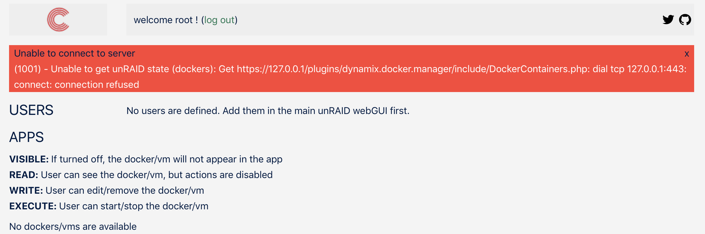

Shyrka973 Posted August 30, 2018 Share Posted August 30, 2018 You are right. SSL Settings Is set to "auto". But I can't add the server with port 443 ans SSL on in app. If I connect to http://tower:2378, i am redirected to https://tower:2379/#/permissions and I get this error after login: welcome root ! (log out) Unable to connect to server (1001) - Unable to get unRAID state (dockers): Get https://127.0.0.1/plugins/dynamix.docker.manager/include/DockerContainers.php: dial tcp 127.0.0.1:443: connect: connection refused controlr.log: I: 2018/08/29 22:55:21 server.go:173: Server started listening http on :2378 I: 2018/08/29 22:55:21 server.go:185: Server started listening https on :2379 I: 2018/08/29 22:55:21 api.go:46: Starting service Api ... I: 2018/08/29 22:55:21 api.go:90: Api started listening https on :2382 I: 2018/08/29 22:55:21 app.go:85: Press Ctrl+C to stop ... W: 2018/08/29 22:56:06 core.go:153: Unable to get unRAID state (dockers): Get https://127.0.0.1/plugins/dynamix.docker.manager/include/DockerContainers.php: dial tcp 127.0.0.1:443: connect: connection refused SSL Settings is set to 'auto' and https port to 443. Why can not I connect to unraid on port 443 ? This may be the problem that prevents the proper functioning of Controlr. Quote Link to comment

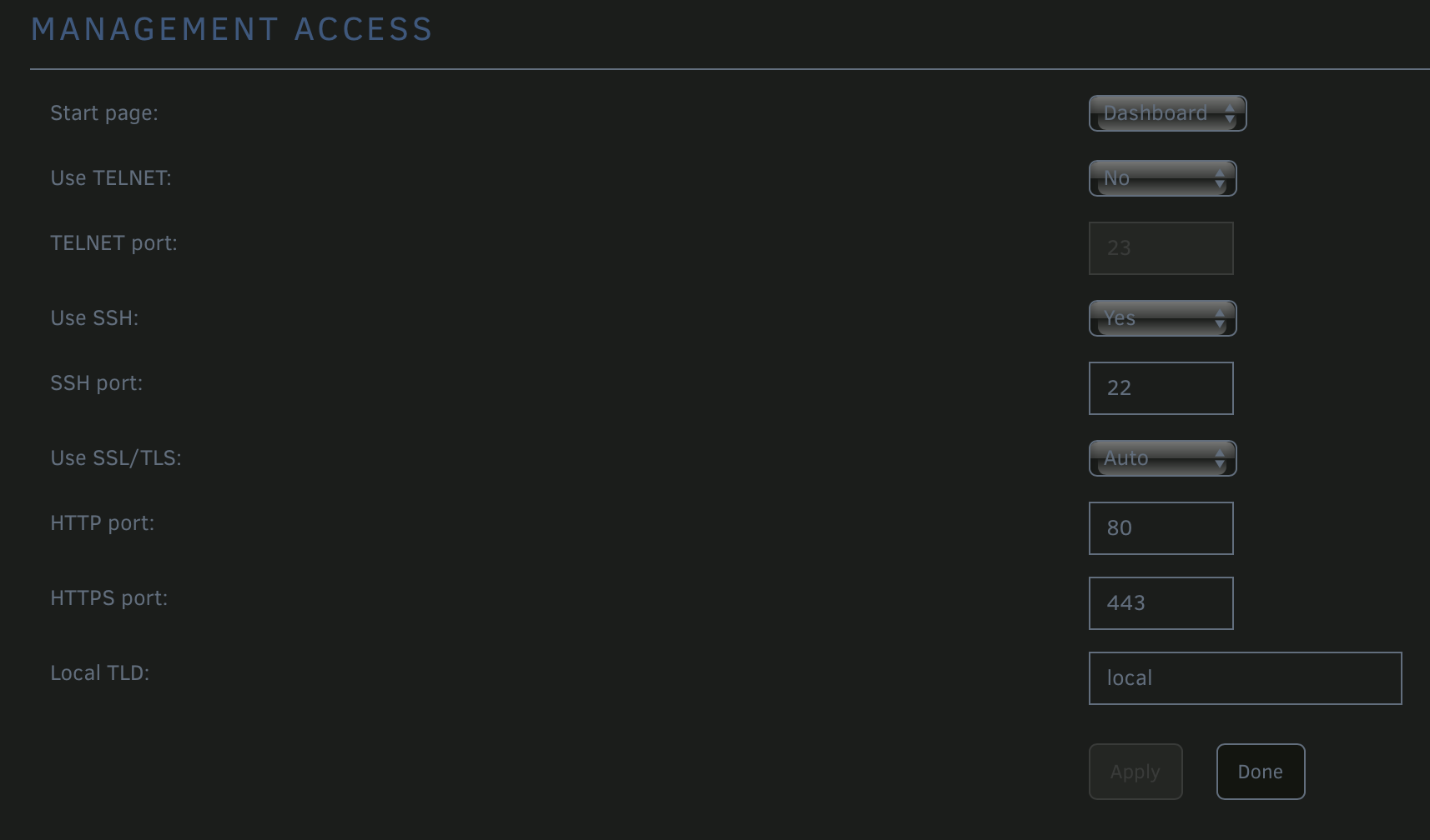

jbrodriguez Posted October 4, 2018 Author Share Posted October 4, 2018 15 hours ago, Shyrka973 said: With this latest version, I have the same access problem. Hi, Yes, I didn't address this issue because I'm not sure how to solve it from my end. If you go to Settings > Identification, what port is ssl is set to (I guess it's grayed out) ? Quote Link to comment
Shyrka973 Posted October 5, 2018 Share Posted October 5, 2018 18 hours ago, jbrodriguez said: If you go to Settings > Identification, what port is ssl is set to (I guess it's grayed out) ? Quote Link to comment
jbrodriguez Posted October 11, 2018 Author Share Posted October 11, 2018 It looks fine. Yet the plugin can't connect to port 443 (connection refused). It seems that the webGUI isn't actually listening on 443, but I can't really tell. Quote Link to comment

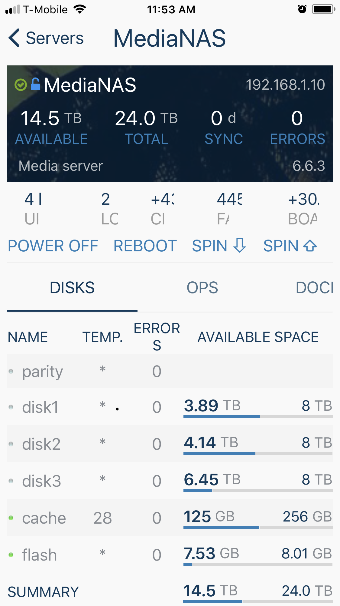

Hoopster Posted October 30, 2018 Share Posted October 30, 2018 As seen in the attached iPhone (iOS 12.0.1) screenshot, the scrolling summary data displays only partially. If I close the app and reopen it, the text begins to scroll normally and all information is visible for the first time through. After it begins repeating (on either the second or third cycle), much of the text is cut off and the labels and data only partially appear. Quote Link to comment
jbrodriguez Posted October 31, 2018 Author Share Posted October 31, 2018 Hi, thanks for the report. This just started happening ? Did you upgrade iOS ? Just looking for something that may have triggered it. I'll take a look. I've been thinking to make that section fixed, but scrollable, for a while, mostly considering battery consumption. If I can reproduce the issue, I'll probably end up doing it. Quote Link to comment
Hoopster Posted October 31, 2018 Share Posted October 31, 2018 (edited) 6 hours ago, jbrodriguez said: This just started happening ? Did you upgrade iOS ? Just looking for something that may have triggered it. I upgraded to iOS 12.0.1 a couple of weeks ago, but, I cannot recall if I noticed the scrolling problem immediately after the upgrade or not. I did notice it about a week ago, but, just reported it yesterday. If I recall correctly, I do not remember seeing the scrolling text problem until recently. Updating now to iOS 12.1. I will update this post with the results post upgrade. 12.1 iOS update did not change anything. First time scrolling through everything is readable, starting with the second cycle much of the text is cut off. Edited October 31, 2018 by Hoopster Quote Link to comment

jbrodriguez Posted November 13, 2018 Author Share Posted November 13, 2018 I've published an update for the app, this should fix the issue with the scrolling stats. They will not auto scroll anymore (if there are enough separate stats), you now scroll it manually. 1 Quote Link to comment
Hoopster Posted November 13, 2018 Share Posted November 13, 2018 5 hours ago, jbrodriguez said: I've published an update for the app, this should fix the issue with the scrolling stats. They will not auto scroll anymore (if there are enough separate stats), you now scroll it manually. Works great! I like it better than the auto-scrolling stats since I can manually scroll to the info I am looking for and it does not scroll away. Quote Link to comment

sudodrew Posted November 14, 2018 Share Posted November 14, 2018 (edited) On 10/3/2018 at 6:33 PM, Shyrka973 said: Hi, With this latest version, I have the same access problem. I'm having this exact same problem. Nothing is installed except controlR, my windows VM. No dockers, no other plugins. Also I'm runing version 6.6.5 I seemed to have fixed this issue by forcing SSL from auto to Yes in Identification. Have to enable HTTPS when adding the server from the phone app. Seems to be working okay. Edited November 14, 2018 by sudodrew Quote Link to comment
