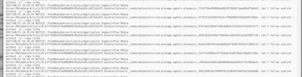

I decided to try and use RClone to backup my appdata, which contains the Plex database.
A large portion of it is copying but also it looks like it doesn't like some file types and has a large number of the following errors:
Any advice on why or what to do with this?  I see there is an appdata backup that is part of community applications and may just try to go that route.

The Plex data must be using symlinks. Did you use -L or --copy-links like the error suggests?

Not knowing what "symlinks" are or being familiar with the -L or --copy-links , I didn't want to go add swtiches into the script without checking first.
I'll see if I can find explanations of the switches on the Rclone page this evening but any help with symlinks or what this really means is appreciated.

Symlink / hardlinks in English (vastly simplified)
Imagine a file named "x" that requires 100Meg to store.
Such and such program wants to store a copy of that file under the filename "y"
Without symlinks / hardlinks, the copy would take up another 100Meg.  With links, the copy doesn't take up any extra space, as the "y" filename simply points to the exact same data that "x" does.
Plex makes very extensive use of them, and any backup of Plex's appdata without handling symlinks / hardlinks is pointless.  Either add the switches, or use CA's appdata backup.

So Plex, rather than having an extremely large database hog of a file, is saving all the image files used for the cover art etc in individual files and then referencing those locations in the database.   correct??
Do I need to add both switches as they are written? or is this an either / or situation?
I looked at the CA backup and if I can handle this in a single line for Rclone I'll do it.  If not I'll go investigate the settings I need to learn in CA Backup.
Yeah.  Multiple files all referencing the exact same picture.
Honestly, I would assume just add the switches. (don't use rclone - I did the appdata backup plg, which may or may not suit your purposes depending upon the destination)
