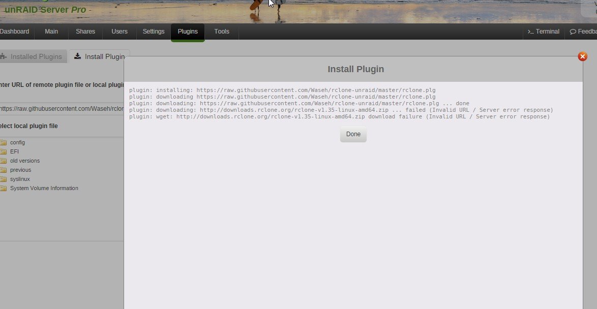

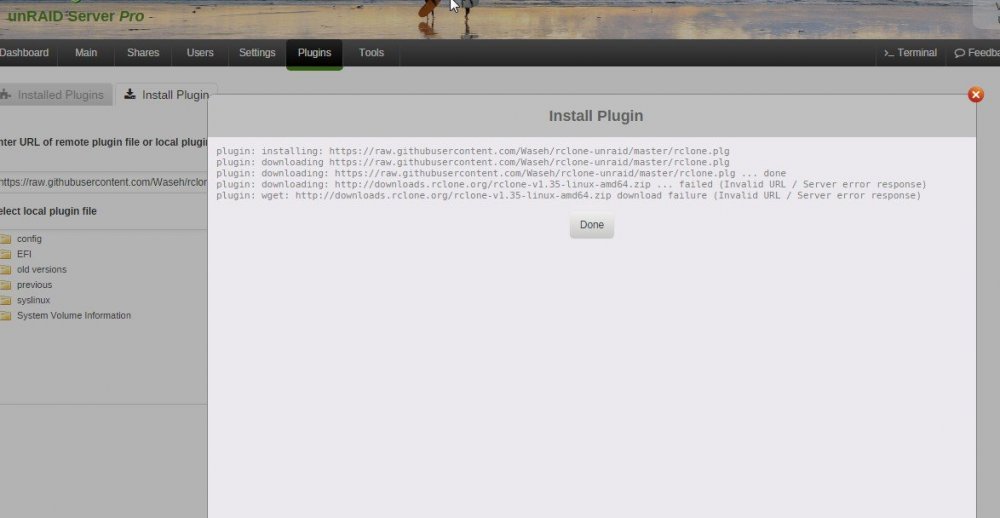

Is rclone working with unraid 6.5.3?  I cannot get it to install using the plugin URL. Screenshot attached.
I've tried somewhat manually using rclones' "Linux installation from precompiled binary" instructions, but I can't get past the Amazon verification.  Tried using unraid GUI mode, but the link returns an Amazon error page.  Also, rclone never shows under unraid's plugins.
Because it didn't install.  Unless you're talking about after a reboot, then with this particular plugin, that is perfectly normal -> It by design does not reinstall it self at boot up.  Install Community Applications (you really should be using that for all add-on installations anyways), and there is a linked post on rclone that details why and the work around.
Besides, troubleshooting plugin installations is easier if CA does or does not install for you.
Installing CA and then rclone through apps did the trick (thanks), but when I try to create the rclone config, when I get to the Amazon authentication, the unraid browser brings me to an amazon page, 'Error Summary: 400 bad request,' plus a bunch of other stuff.  I've tried it with the Client Id & Secret ID blank, and filled-in through the terminal config process.  I've tried manually loginng in to Amazon before the link also.

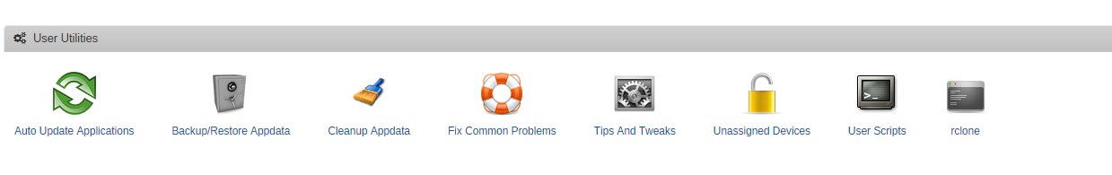

On 2/15/2018 at 11:20 AM, JimB66 said:
I just installed rclone as I get ready to transition away from CrashPlan. It's working great so far, connecting to Backblaze B2. I did notice a minor GUI issue however; the icon on the Settings page seems to be a default icon rather than the rclone one. The icon is correct on the Plugins page.
I saw there was an issue a while ago with the icon size, but since I installed rclone a couple of weeks ago I'm not sure if that's the issue. I have restarted my browser (Firefox) a couple of times since the install (browser & PC updates) with no change. I'm running unRAID 6.4.1.
Thanks for your help,
Jim
I am also seeing this - is there a fix?
