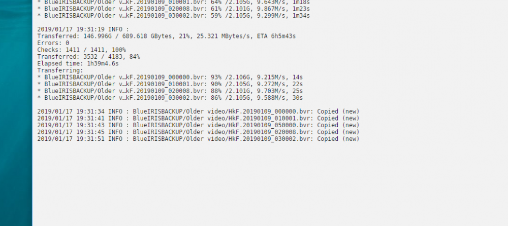

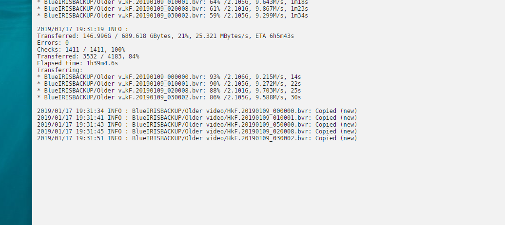

Trying to have unraid back up to a NAS(1 drive) Anyways I told it to exclude Older video which is my blue iris NVR.  However I show its coping the files anyways.
Script:
rclone sync -v /mnt/user/backups/ NAS:adehaan86/unraidbkup/ --exclude "/Older video/**" --exclude "/Work/**"
Screenshot:
Edit: I got this script working using the following below:
rclone sync -v /mnt/user/backups/ NAS:adehaan86/unraidbkup/ --exclude "**/Older video/**" --exclude "/Work/**"
Edited by scubieman
