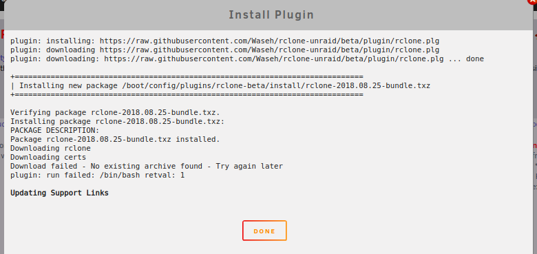

can anyone help me everytime i try to install rclone or the bata i get this
I just tried it and it works no problems.  Maybe try a reboot and then an install.
I've been getting exactly the same error. Tried multiple reboots and still says that
Anyone have any suggestions on solving this issue? Help would be appreciated.
