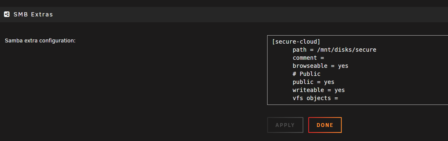

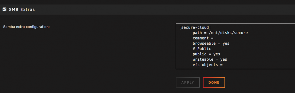

I need some help, please.
I have rclone working with an encryted folder in krusader but when i mount the folder in windows i get this error
WriteFileHandle.Write: can't seek in file without --vfs-cache-mode >= writes

Thanks for the reply.
I have this mounted with write enabled, as in the picture.  Id be gratful for some help with this.
