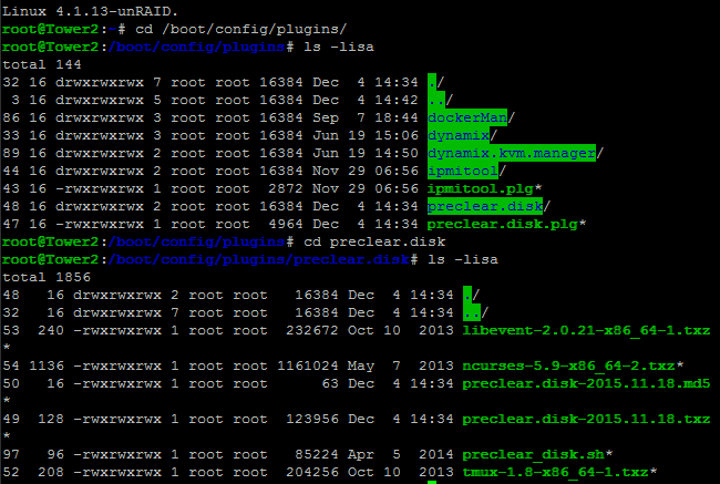

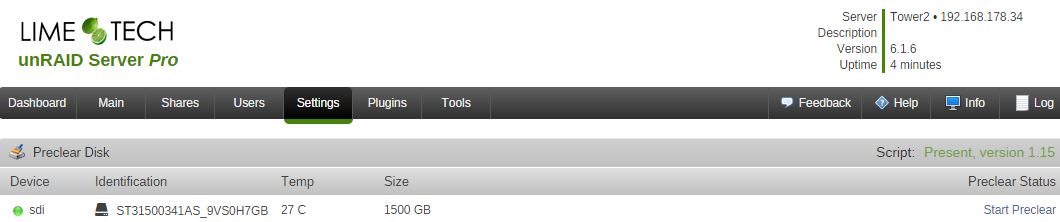

I'm having an issue where my system is saying the script isn't present.  This is on a system that I started building in the spring, but it got put on the back burner until now.  At the time, I precleared 4 drives, with the script, and I'm still using the same flash drive.
When I try running the plugin, I get script not present.
Any way to diagnose why it's not seeing the script?
Is it in the right folder?
It doesn't come with the preclear script itself, which can be found here. Please put a copy of the script to /boot/config/plugins/preclear.disk/ directory.
Again, love this forum.  That fixed it.  I didn't see the different path required for the regular preclear vs the plugin.

Used the plugin with the fast post-read and notifications enabled version from host site listed. Shows as ver. 1.115c, plugin worked great as has been the case, and pre clear of three new 4TB drives were successful also. 10 hours quicker for each drive than ones done in the past, however I never received any notifications. I had set for both the web GUI pop ups and email. i tried the 25%, end of each step, and end of cycle and never got anything.
My notifications are working fine for unraid. Is something broke or did i not do something correctly in setting it up?
According to your sig you are not running 6.1.x. This is likely the problem, and you should upgrade anyway. Nobody can support 6.0rc6
There's a version hosted here: http://bit.ly/1G44UhZ . This version have fast post-read and notifications enabled.
You can add this with this command:
wget http://bit.ly/1G44UhZ -O /boot/config/plugins/preclear.disk/preclear_disk.sh
readvz is already downloaded by the plugin.
Sorry, hadn't changed that yet. Was on 6.1.4 while preclearing. Now updated to 6.1.6
I also realize now that updating which required a restart wiped any logs that may of been useful correct? It appears to be working for those that use it so it must be unique to my setup. I have a small drive to test with but can't get to it for a week or so. When I do I'll run a single pass with the fast option and the 25% setting and post back results then.
