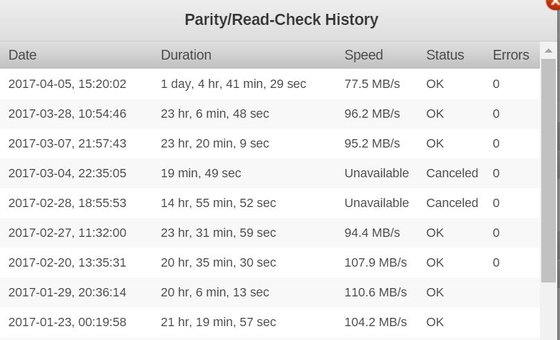

My parity check speeds are fairly consistent, it takes a while but it's usually around about the same speed each time
Using dual Seagate Archive 8TB drives for parity, no idea if they affect the speed
Edited by sdamaged
Not really, unless something changed, especially on the last one, there's over 5 hours difference, I consider consistent when they within 15 minutes of each other.
Well yeah, the one on 5th April was very slow - i've no idea why, unless the Plex docker was hammering the CPU and doing disk / library scans

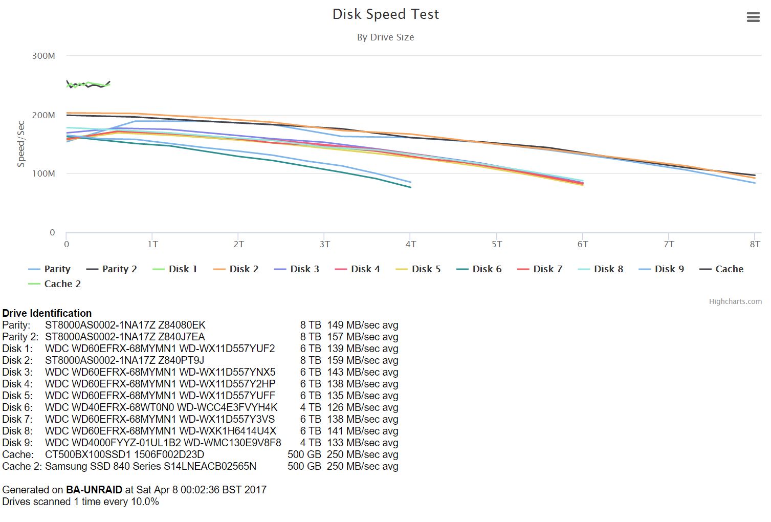

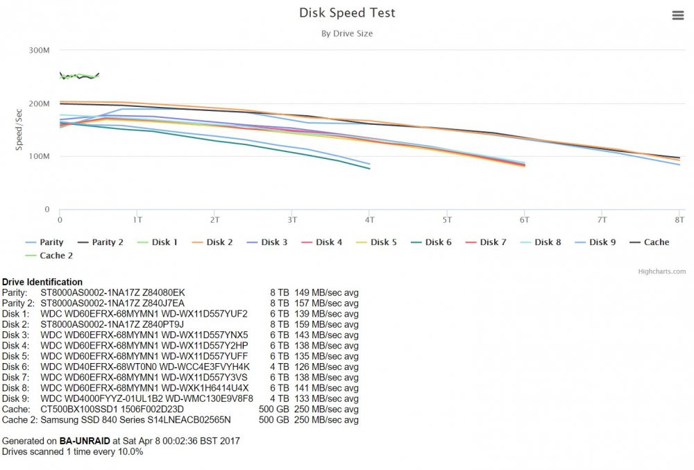

You can run this to see if there's a disk with slow sectors, although not always visible if it's mild in the standard test as it only scans a very small percentage of the disk's surface:
Thanks Johnnie
This is my result

7 minutes ago, Benson said:
You using dual Seagate Archive 8TB drives, why haven't show in the diagnostics file ?
So,problem should be cause by those SMR drive, disk were internal busy during wrire (even read).
The chart shows the ST8s as the fastest, but curve for parity isn't very smooth. Don't know whether it means anything.

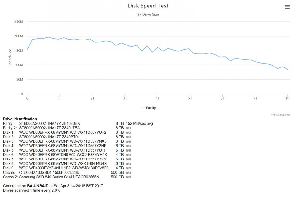

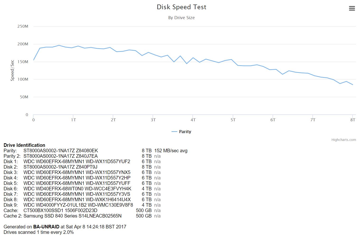

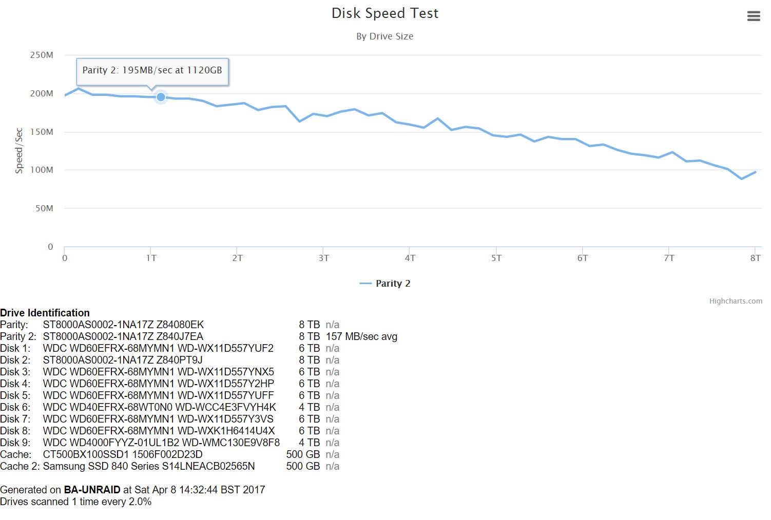

Yes, could be something, could be nothing, you should test your parity only with more sample points, e.g.:
diskspeed.sh -s 51 -n sdX
Replace X with parity letter.
OK results below
Not very smooth, but no long dips either, so doubt that is the problem.
