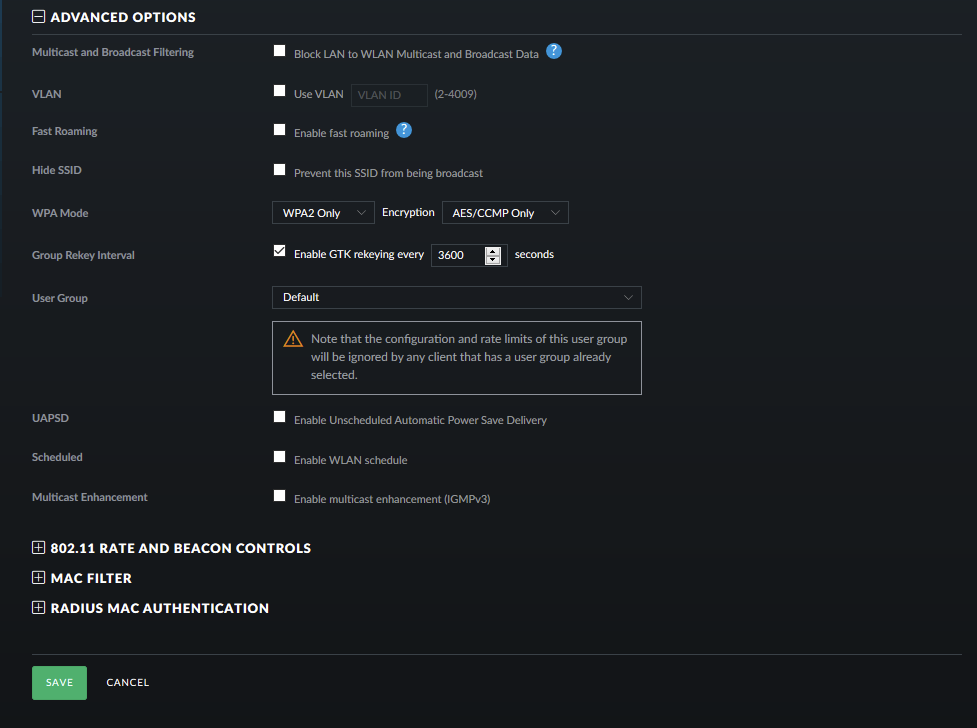

My money is on the AP blocking multicast. I *think* I had to fiddle with a setting on my Ubiquiti AP to have my Squeezeboxes work properly (no radios, just a boom and a SB3 on wifi). Do you have the Unifi Controller Docker (or similar) to take a look at your settings?

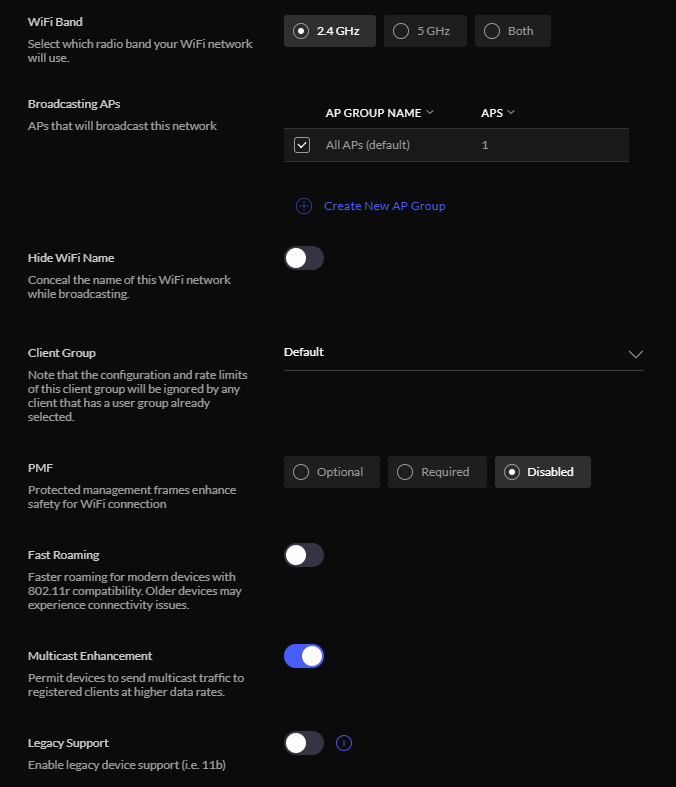

If it's any help, here's a screenshot of mine (from Settings > WiFi > [SSID] > Edit > Advanced):
Thanks Jademonkey - here's what my settings panel looks like:
Only thing that seems interesting is that the tooltip seems to indicate that I should keep the multicast and broadband filtering option disabled:
Looks like you're on a different version to me (I'm on 6.0.22), but my memory now recollects that that is _exactly_ the option that I had to allow (as in, allowing multicasting by un-checking that option) to get my Squeezebox to work properly: they rely on multicasting to work. I think the warning about proper controls is really only problematic in corporate networks where traffic is plentiful. I've had no problems.
So, if multicasting was already allowed on your network, then my advice isn't related to your problem.
Edited by jademonkee
