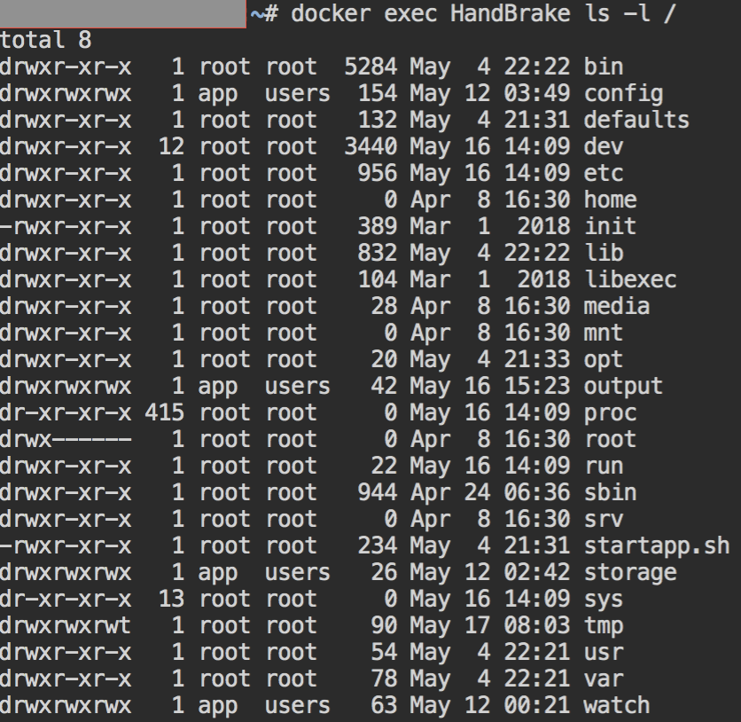

15 hours ago, DrAwesome said:
OK, so I tried deleting the container and all cache data and even the directories themselves. I remade them, starting from scratch and opening up the permissions again to 777. I can now get the GUI version to work when setting the destination output to /output as described above, but the watch folder still does not work. Same error as before. This makes me think that maybe one of my routes is bad for the watch folder, but I can't see it myself. Any help?
What is the output of the following command?:
docker exec HandBrake ls -l /
On 5/17/2019 at 8:05 AM, DrAwesome said:
No sure why you are getting permission errors.  Everything looks good.
Other than changing mappings to /output and /storage, did you made other changes to the template?
As a last resort, your could try to re-create your docker.img to see if it helps.
