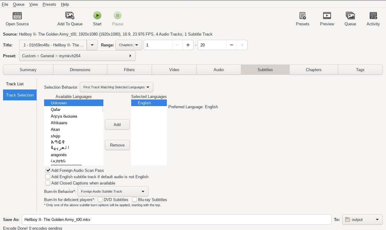

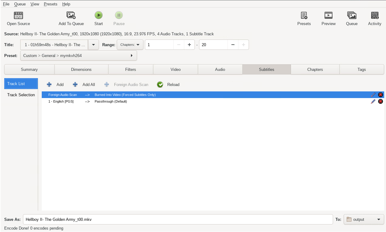

So I saw this question posted a few months back but it didn't seem to go anywhere regarding subtitles. I have HandBrake set to transcode to an .mkv container with H.264 encoding. I am burning foreign audio subtitles and grabbing the first English subs found. HandBrake is defaulting those subtitles on and I don't see any way to disable that. I would prefer to have the subs included but left off until I enable in Plex/VLC.
Any ideas?
Any ideas?
In the track list, if you click the pencil icon for your English track, try to uncheck "Set Default Track" to see if it helps.
Thanks. To clarify, when using the GUI to initiate a transcode I can and have unchecked that box to remove the default tag. When I do this the file works properly and no subtitles display by default in playback. However, I am setting this up to be automated through watch folders and the preset I have created does not maintain that subtitle status. Anytime I load the preset it checks the default box back on. I don't see any way of getting that to be maintained when HandBrake starts a new transcode.
