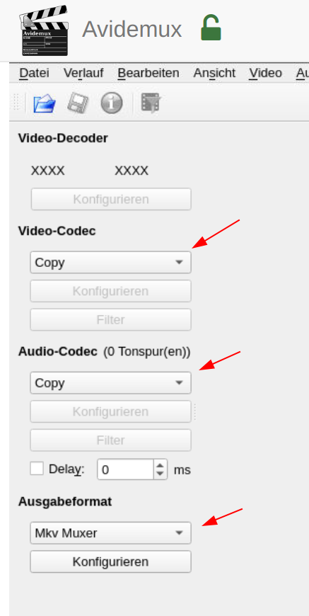

may also take a look at avidemux
i use it to remux my records after com cutting, from .ts to mkv, but should also work from avi to mkv ...
oh ok ill check it out too.. I did try the mkvtoolnix.. only issue is if I have 100 avi I import in, I thought it do each one..  not it takes the first file..  and takes the audio tracks of all 100 and sticks it all in 1 file lol
didn't create 100 files ..     reason I liked handbrake  I  can copy my home movies cam corders into the folder and it would process
but ill give this one a try too..

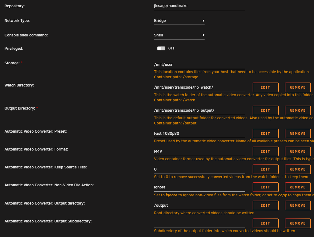

Hello, I've just set this docker up to watch and auto process a folder.  I keep getting an error "Invalid preset Fast 1080p30".  I get this for any preset that I select in the docker settings.  I'm not sure why... can somebody help?
Snippet of the log file

Attaching a screenshot of my docker settings:
Just as an FYI, i'm trying to use this in conjunction with the plex post processing script https://gist.github.com/jlesage/06d8024d510b630025814fa5b776fef9
Exactly the same here. Was working before the docker was updated. No idea what the previous version was.
Where you possible to fix it?
No I haven't gotten it working yet.  You're saying it worked before, so maybe something in the new update broke it?  This is the first time I've tried so I had assumed that I had something set up wrong.
