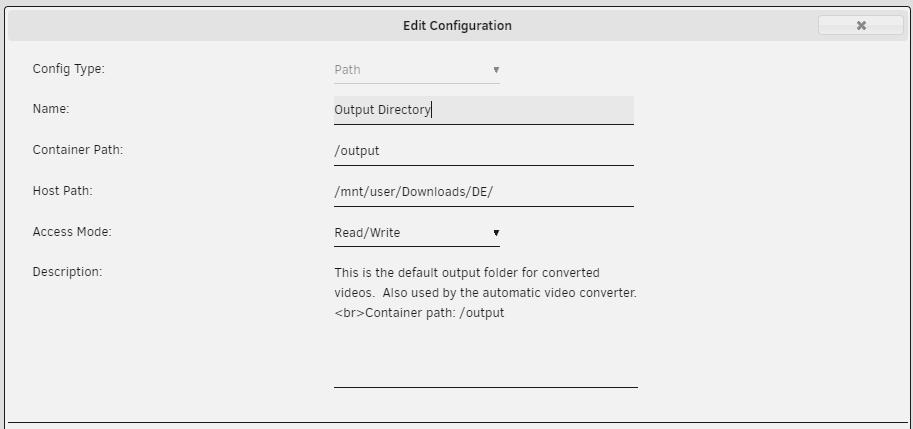

Didn't work.  I tried doing it manually again and says it doesn't have read/write access to that file folder.
I changed the settings - just for S&G's - it looks right in the fact that the correct folders are being given rw status
'AUTOMATED_CONVERSION_SOURCE_MIN_DURATION'='10' -e 'AUTOMATED_CONVERSION_CHECK_INTERVAL'='5' -e 'AUTOMATED_CONVERSION_MAX_WATCH_FOLDERS'='5' -e 'AUTOMATED_CONVERSION_NO_GUI_PROGRESS'='0' -e 'AUTOMATED_CONVERSION_HANDBRAKE_CUSTOM_ARGS'='' -e 'AUTOMATED_CONVERSION_INSTALL_PKGS'='' -p '7803:5800/tcp' -p '7903:5900/tcp' -v '/mnt/user':'/storage':'ro' -v '/mnt/user/Downloads/TBE/':'/watch':'rw' -v '/mnt/user/Downloads/DE/':'/output':'rw' -v '/mnt/user/Downloads/TBE/':'/mnt/user/Downloads/TBE/':'rw' -v '/mnt/user/Downloads/DE/':'/mnt/user/Downloads/DE/':'rw' -v '/mnt/user/appdata/HandBrake':'/config':'rw' 'jlesage/handbrake'
d138e76b84388eb56b27d97e7df4611bca9bbb1e895673173d763f52d4b6e6e3
and I made a change so I don't get the same file processed with error -
[autovideoconverter] Change detected in watch folder '/watch'.
[autovideoconverter] Processing watch folder '/watch'...
[autovideoconverter] Waiting 5 seconds before processing '/watch/Rocketman.mkv'...
[autovideoconverter] Starting conversion of '/watch/Rocketman.mkv' (f736caed3663af737ce46609b5e92f94) using preset '4K process'...
[autovideoconverter] 1 title(s) to process.
[autovideoconverter] Conversion failed.
if I manually try to start the encode it gives me a can't read or write error...  I'm not sure what else to check.
Edited by cbr600ds2

Did you check the ownership and permission of /mnt/user/Downloads/DE in unRAID ?
I'm an idiot...how would I do that?
ls -l /mnt/user/Downloads
ls -l /mnt/user/Downloads/DE
root@Skynet:~# ls -l /mnt/user/Downloads
total 0
drwxrwxrwx 1 nobody users    0 Mar 26 14:39 DE/
drwxrwxrwx 1 nobody users   16 Mar 26 14:39 TBE/
drwxrwxr-x 1 nobody users  908 Mar 26 14:35 complete/
drwxrwxrwx 1 nobody users 3046 Mar 22 10:54 incomplete/
hmm... I thought maybe it was because I created the folders through my windows 10 machine so I deleted and then used krusader to create the folders but stilll same errors.

/config/mnt/user/appdata/HandBrake
I assume you meant
/storage => /mnt/user/Plex Media/Converted Videos/
/watch => /mnt/user/Plex Media/Converted Videos/
/output => /mnt/user/Plex Media/Converted Videos/
/config => /mnt/user/appdata/Handbrake
If not, then you'll have to explain a bit more.
I'm not sure docker will let you munt the same directory three times with different permissions. /storage is normally read-only. /watch normally is, but doesn't have to be. /output is obviously read-write.
Also, if your input and output containers are the same type, you're going to shoot yourself in the foot.

Forgive me I am a complete noob with Docker.
I have experience with handbrake on my main PC but not in UnRaid.
Any guidance on how to set up my mappings would be greatly appreciated.
I don't really know what's "normal" for /storage, I'm not completely sure why it's there at all. But I generally make it a parent directory of all the video-related things I want to operate on.
Then I have subdirectories that map one-to-one with the container. My original config looked like this:
/storage => /mnt/user/Videos/rip
/watch => /mnt/user/Videos/rip/watch
/output => /mnt/user/Videos/rip/output
I use MakeMKV to rip the original media into /mnt/user/Videos/rip/staging. Then once that's done and I've renamed my files to something meaningful, I move the whole directory into "watch". Once Handbrake is finished, I move the watch subdirectory into /mnt/user/Videos/rip/done, and the output subdirectory into my Plex tree. You could, of course, just have Handbrake convert directly into your Plex output directory, which seems to be what you were aiming for, but I prefer to have Plex be ignorant of what's in process until I'm done.
On 3/25/2020 at 7:37 PM, Djoss said:
What about mapping the different watch folders to the same folder on unRAID ?  Make sure that you configure the automatic video converter to not touch the source files.  You can then manually clean the source files once all conversions are done.
Hmm. I've set this up with a single /watch all mapped the same for each converter and, for blurays, this seems like it will work well. In fact, I've set up three instances and assigned different CPU sets to each instance, so they can run in parallel and not fight each other. But....
Only my 480p config makes sense for DVDs. All three instances will try to rip them, and I have a post conversion script that will rename them so they don't conflict when I eventually merge the outputs, but the 1080p config's output won't be any different than the 480p config's output. With the old single instance, the pre conversion script would detect that and move the input to the next queue.
Looking at autovideoconverter/run, there doesn't seem to be any way to veto a conversion except to move the input file.
And...a veto would be much nicer that the move stuff anyway. I really do like that one watch directory for them all. The 480p and 720p configs convert much faster than the 1080p (naturally), so stacking them behind the 1080p partially defeats the parallel setup.
