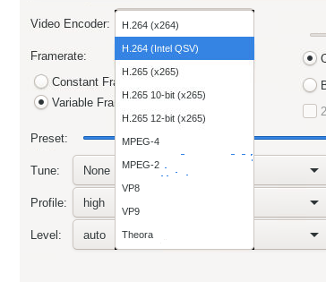

  • Try the latest version, which have Quick Sync support. See https://github.com/jlesage/docker-handbrake#intel-quick-sync-video for more details on how to use it.

2 hours ago, Djoss said:
It's also working fine for me.  Can you tell if you have issue with h.264, h.265 or both ?  Also, which CPU do you have exactly ?
Its just the h.265 that is causing problems. Im using an I7-8700.
Issue is also on github: https://github.com/jlesage/docker-handbrake/issues/118

It's an issue with HandBrake when using the latest Intel Media SDK.  See https://github.com/HandBrake/HandBrake/issues/2858
A fix is being reviewed.  Once, accepted, I should be able to integrate it in the Docker image.

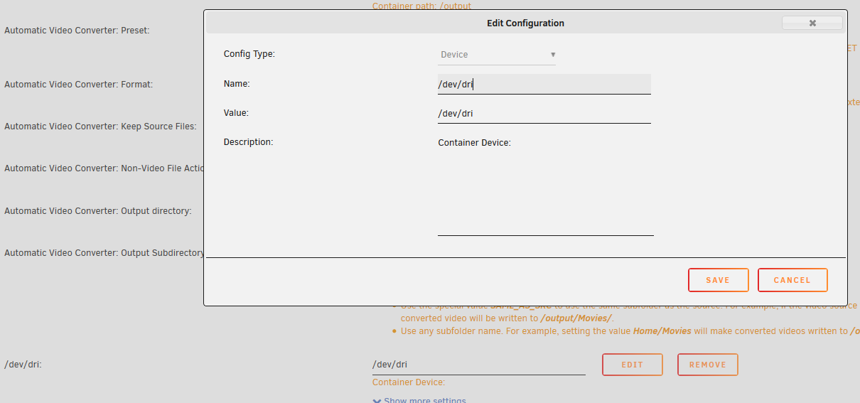

Hi All,
i'm having issue using Intel quick Sync, my driver load thing and the go files configuration is done and i know is working becos my plex is hardwar trancoding using qulcik sync, but when i add the same parameter in HandBrake, it does not seem to work.
The Intel QSV does show up but when i try to encode a video with it, it will end with error.
it will just fail like that.
i add the parameter same as the one i did on plex.
do need help on this to make it work.

On 6/17/2020 at 4:24 AM, Ong Hui Hoong said:
Hi All,
I'm running on a Intel Gen 4 i7 4790 processor.
You should look at /mnt/user/appdata/HandBrake/ghb/EncodeLogs/ to have more details on the failure.

On 6/17/2020 at 10:24 AM, Ong Hui Hoong said:
Hi All,
I made it working with the following entry under extra Parameters (will show up under advanced view)
