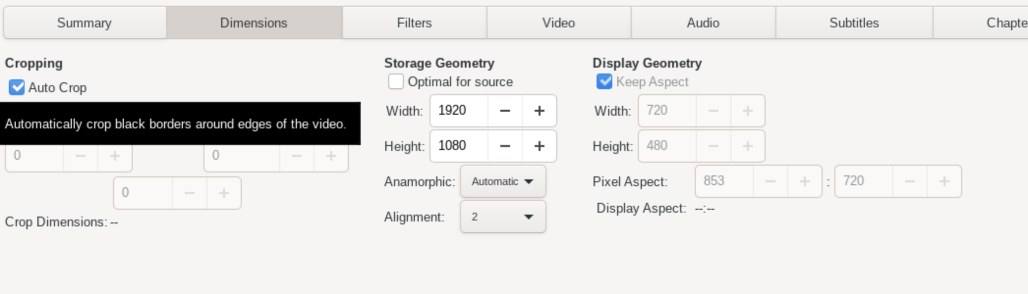

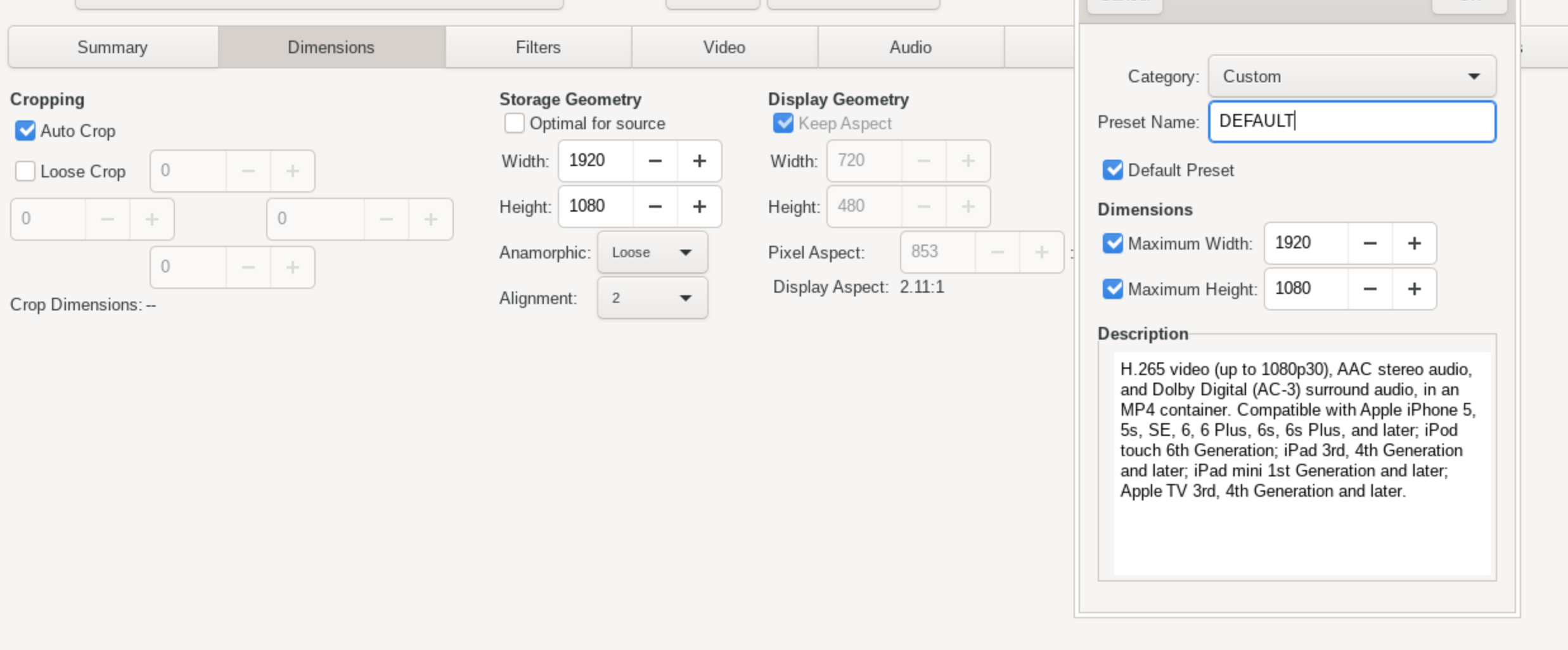

Can anyone tell me how to make this container respect the max resolution settings in my preset?  I want source file larger than 1080P (such as 4k) to be reduced down to 1080P but anything smaller will remain original size.
Edited by flinte
I think changing Anamorphic to Loose has resolved it.
