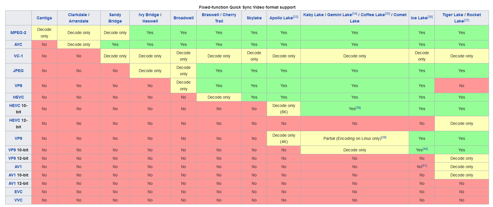

That's your problem.  Yes, the CPU has QSV, but it is NOT capable of dealing with many formats/codecs, especially 4K, as it is an Ivy Bridge generation CPU.   You really need to have a Skylake generation or later CPU before QSV can handle 4K/HEVC.
Ah, ok, thank you for clarifying. Looks like I'll have to wish for some upgrades for Christmas!
Just curious, what is your opinion on Intel vs. AMD these days for unRAID? I have a Ryzen 7 3700X in my gaming rig and I absolutely love it, and am thinking of going with either another 3700X or even a Ryzen 9 if the financial gods are kind to me. However, I don't know anything about Ryzen CPU's encoding capabilities. Does AMD have something similar to QSV that works in this docker, and performs similarly (e.g, encode time, quality, and output file size)?
I do use my server for some VM's, so the extra cores would definitely help. However, if in the long run Intel is better for everything else like Handbrake and other Dockers, I may sacrifice the extra cores for more all around stability and support.
Thanks for your help so far, and thanks in advance for any input you may be able to provide!
AMD has a few APUs (that's what they call CPUs with integrated graphics), but, they do not work for hardware transcoding in apps like Plex, HandBrake, etc.  Technically, they could, but the vendors don't officially support them the way they do Intel QSV.
There are many people in these forums using Ryzen CPUs in their unRAID servers, but, when it comes to hardware transcoding, the only real choice is to use a dedicated Nvidia GPU.
Many have multiple GPUs; one for use by docker containers and one or more to pass through to VMs.
Personally, I have a Coffee Lake generation CPU with QSV and it can be used by multiple docker containers simultaneously.  I have had both Plex and HandBrake doing QSV video encoding at the same time.

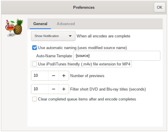

Found out strange behaviour in HB Docker. When using it on webUI. when i copy/move video file to watch folder. it will save file as MP4 file as it should, but if i open video in gui and start it there, it will make it M4V, even i try to change that on bottom text field where it has Save As "New Video.m4v", if i try to rename that m4v to mp4, it lets to change it to mp, but when i add 4, it changes it back to m4v. i havnt been able to find out a way to change that one or way to be able to save in mp4 whyli doing manual in webUI.  Using default preset 1080p30 very fast, i have tried also my own preset by tweaking and saving my own preset and set it as default, no matter what i change wont matter to end file.
for testing purposes, i have old and slow Phenom II X4 955 BE. im trying to find perfect endresult for me. i'm using multiple different files and doing different compression level and quality testing. by adding them in webGUI, i can input options, make files to compress with those settings, then change settings and compress with those and so on. this way i could add all videos with all different settings to queue, but i cannot. now i have to wait until it has encoded those with current settings, then change settings and rename those files in watch folders to trigger new encode.

16 minutes ago, Vertabine said:
Hey.
Hey pretty simple this. on the webui click on file and then prefernces and uncheck use ipod/itunes friendly .m4v  image.png.e1206a597e6a60abd7f45f1d6d0825d9.png
Oh LoL :D. Thanks. i poked that preferences couple of times but didnt even notice that one. spend couple of hours trying to find that out :D in Desktop version HB has never done that m4v conversion as in this from preferences. never late to learn something new :)
