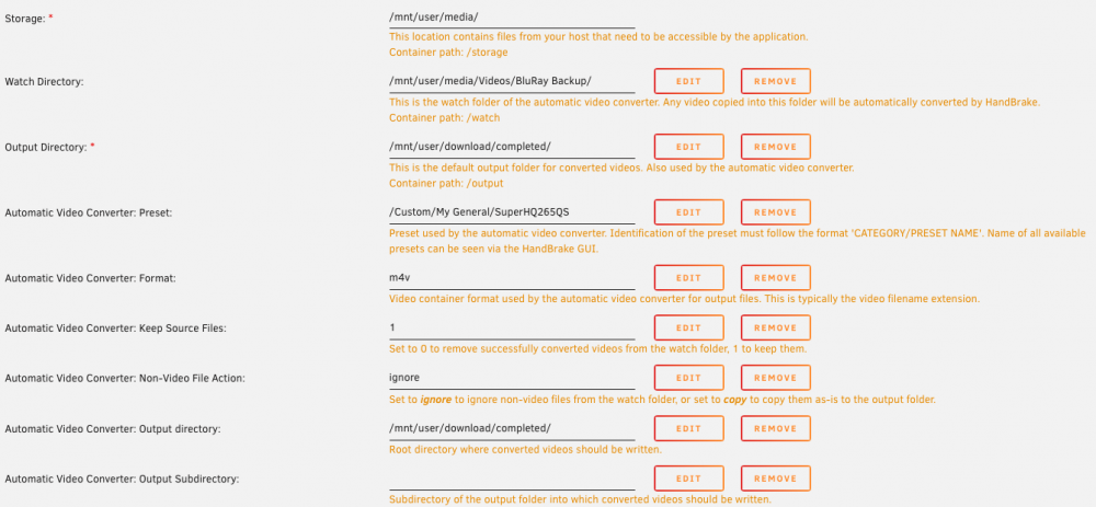

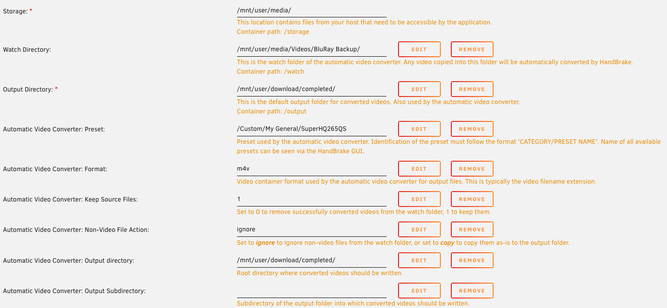

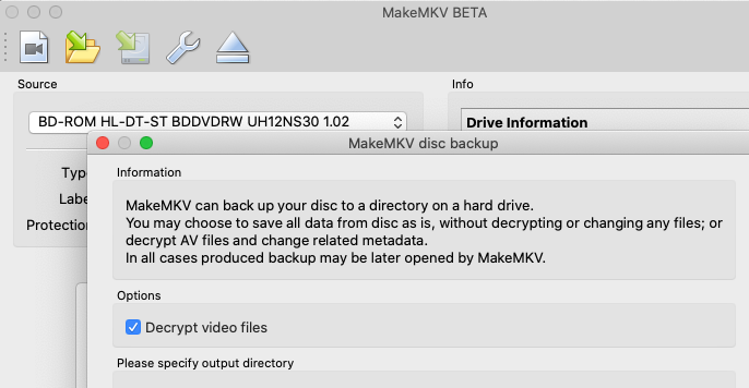

Finally spent some time to get this working and migrating my video conversion workflow to my Unraid box running an i3-9100 vs my desktop running i7-4770k.  QuickSync support is AMAZING.  BluRay encodes now take < 1hr instead of 8 hours.  I would like to start to use the watch folder so my workflow looks like this.
1. Rip BluRay using MakeMKV to decrypt and backup disk using my desktop and store the resulting folder on my UnRaid server in the watch folder.
2. HandBrake to auto apply my custom preset (basically quicksync 265, with passthrough audio)
Problem is that when that HandBrake doesn't seem to be able to find the right file?  Log sees to just skip everything (below is a sample of the log).  The GUI finds the correct title automatically and the preset works.
[autovideoconverter] Skipping video '/watch/INSIDE_OUT/BDMV' (26ed453688fbf87128d42e79e76de3eb): already processed successfully.
[autovideoconverter] Skipping video '/watch/INSIDE_OUT/MAKEMKV/CMAP/00398.cmap' (434574bd9152b47ce57ba69030dada17): already processed successfully.
[autovideoconverter] Skipping video '/watch/INSIDE_OUT/MAKEMKV/CMAP/00312.cmap' (0572d67072f3cf4e128fe5bde3276b53): already processed successfully.
[autovideoconverter] Skipping video '/watch/INSIDE_OUT/MAKEMKV/CMAP/00340.cmap' (56466c20f76b9fdee50e6b387c11be92): already processed successfully.
[autovideoconverter] Watch folder '/watch' processing terminated.
Hey. I dont think you need the "custom" bit in the automatic video convert preset.  My General/SuperHQ264QS should be fine. try that.
Thanks, made that change but same issue.

I’m using MakeMKV to do a BluRay disk backup. Then I use handbrake to make a single file.

on makemkv backup are you decrypting the film?
Yes
Just now, Flyinace2000 said:
Yes
Okay. when you do a backup inside of the film folder you get \BDMV\, \CERTIFICATE\ and \MAKEMKV\ inside of the DBWV is a \STREAM\ folder. that folder has a number of .m2ts videos. its them you need to convert. some of those are the film, some are extras and some are the logo type stuff. But why are you backing the film up? i backed up the Teenage_Mutant_Ninja_Turtles and got 79 .m2ts videos.
Maybe my workflow is wrong. How should I rip a Blu-ray? HandBrake doesn’t support the disk natively (right?).

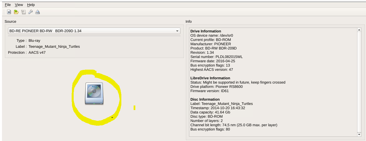

Hey you using makekmv on unraid cointainor or? also when you put a dvd into the dvd drive and makemkv sees it, you get info about the dvd on the right of makemkv the button ive hilighted in yellow will start makekmv to scan the drive for the media and then after that you can see a list of all the videos it found and can pick what ones to rip from the dvd. hope that helps
