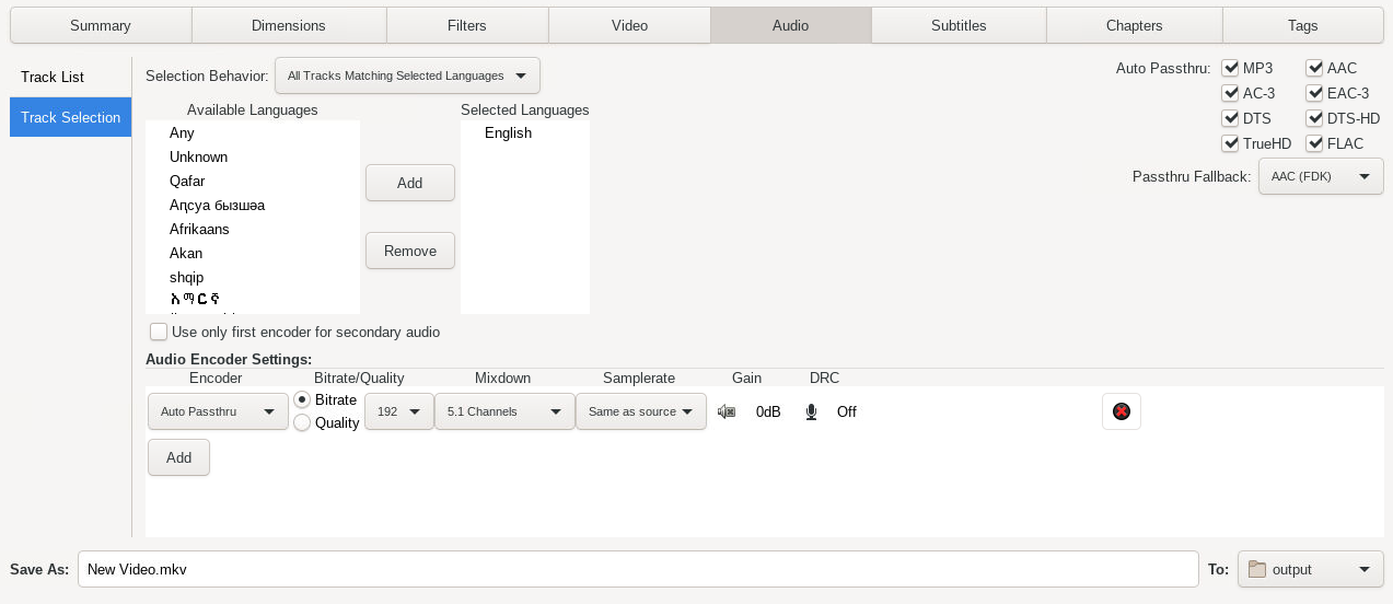

I've been trying to figure out the magic settings to get the audio and subtitles to pass through into my mkv container. So far, nothing is really working....
I can sort-of get there by opening the original rip and looking at all the audio and subtitle stream and setting it up manually, for that particular movie. But that really doesn't work for running things via the watch queue in the background; if I save that setting, it has particular streams selected that might not make sense for the next video. My starting point was H.264 MKV 1080p30 preset followed by clearing the audio settings and adding them from scratch. When playing the original MKV rip, it shows has having a 7.1 (3F2M2R/LFE) English track with dts encoding Yet, if select DTS-HD Passthru 384kpbs, 7.1, same-as-source, as the first encoder, on the audio list, clicking select all doesn't pull in a 7.1 track. It does seem to pull in all of the audio tracks. But I'm clear how that manual setting is going translate to the next video which may not have the same set of audio tracks.
I have a similar issue with the subtitles; I can manually add all the subtitle tracks, but don't see how this translates to a configuration I can save for the automatic transcoding.
Is what I'm trying to do even possible, or do I have to do it one video at at time? That's not really going to work for me since I have quite a few to transcode....

On the Audio and Subtitles tabs you need to go to the Track Selection sub-tab. This specified how you're selecting tracks. I do teh same as you and just passthrough everything. See the attached image, for the Audio settings. You'll notice the audio settings has a config, this is a bug I guess, it's set to Auto-Passthrough and these settings are ignored. Note, this is for English audio passthrough only, you could change it to Any. Subtitles work the same.
Thanks! It took me a couple of tries to get it right for both audio and subtitles, but it's working now.
