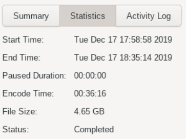

quick and dirty comparison of QSV vs NVENC timings:
With the Nvidia plugin, and this container, I think converting movies could benefit with the speed/offloading improvement.
Just tested a movie:
My Unraid Server, AMD 3700X with 12 threads pinned to Handbrake container standard H264:
36 Minutes @ 4.65 GB
Same movie on my Desktop with 3900X and 2080Ti, using H264 NVENC:
11 Minutes @ 7.5 GB
