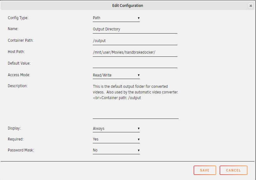

I have been using this docker for a while now and it is perfect! Again Thanks for this.
Today though I am suddenly unable to write to the Handbrake output folder from my Main Rig, nothing has been changed, I have rebooted both my server and Main Rig but still no joy?  I am having to use putty to delete and move files around at the moment.
I run 2 Handbrake Dockers and the output folder on the other one is still accessible.
the output folder is one of 5 subfolders in my Movies share on unraid, I am able to write to the other 4 with no issues
Any ideas?
Edited by mbc0

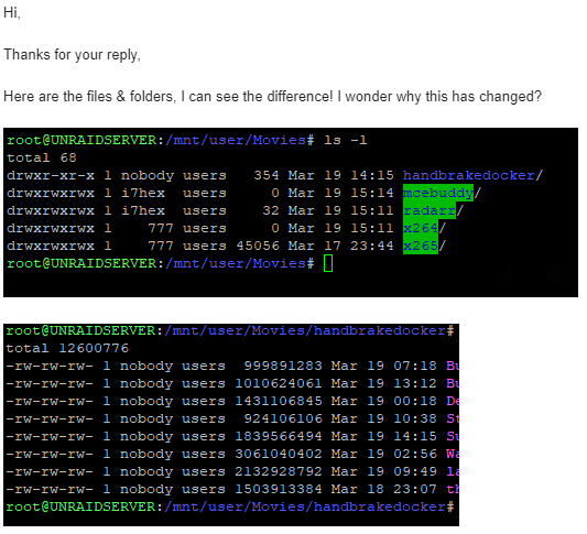

Any ideas?
Are the files/folders have the same ownership and permissions (compare between a working and non-working one)?  Verify with "ls -l".
18 hours ago, mbc0 said:
So your "handbrakedocker" folder seems to have the correct/normal ownership/permissions.  Likely a permission issue with SMB?
Unfortunately a bit over my head to be honest, I just chmod -R 777 and now working fine... All my SMB Shares (I have a lot!) are working normally with correct access except my Handbrakedocker folder so I wouldn't know where to begin!
