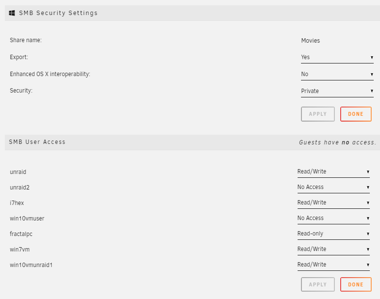

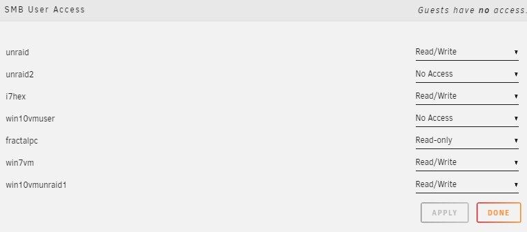

What is the value of SMB security setting for the share?
20 hours ago, Djoss said:
Doing chmod 777 on your folder didn't help?
Hi mate,  sorry if I confused things, executing a chmod 777 does fix the issue but wondering why I am having to do it all the time to the handbrakedocker output folder? never had to before...

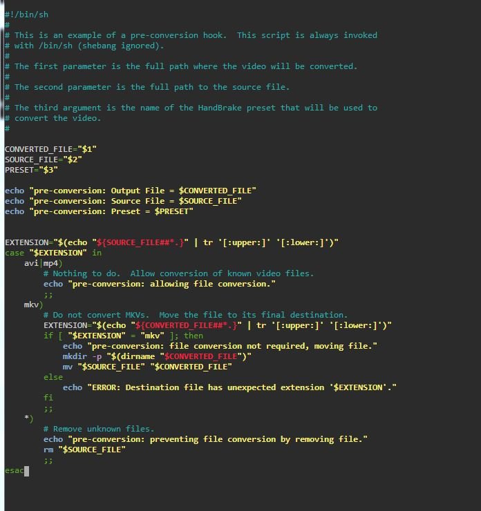

I have checked my code and it is the same as the above, but I am still getting that error 😞
Could you not add a chmod and chown in your script to clean up after the mkdir and mv's?
Can you please give me an example as my level of coding in shell is zero. And the above code was giving to me.
Make sure to download the file.  Sometime, copy-pasting from web browser introduce some undesired, invisible utf-8 characters.
wget https://gist.githubusercontent.com/jlesage/b2770b32bcfb8d1138887d86673ad8a8/raw/b82a2a089e7bd63d74d5d66cff4d8798763c3d1b/pre_conversion.sh
mv pre_conversion.sh /mnt/user/appdata/HandBrake/hooks
thanks that did the trick
