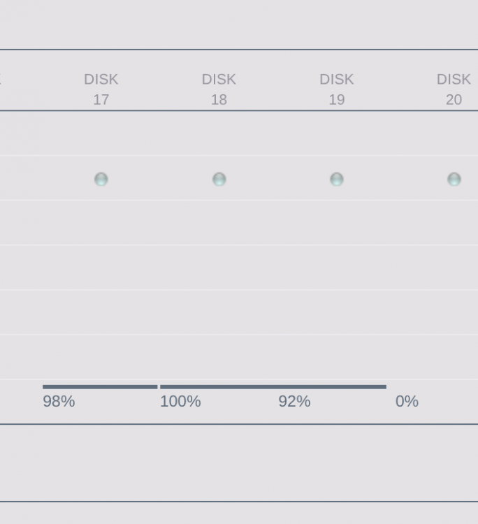

not sure if this is already reported.
I think there is little problem with the spacing. The space bar of drive 18 and 19 fuses together. See screenshot below. This is on the latest Safari.
Ummm, I think they fuse together because drive 18 is 100% full.  The gap on drive 17 represents the 2% space available.  Or are you saying that other drives which are 100% full have a gap after them?
