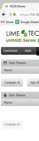

All of my share entries are missing in rc8q. Shares still physically present on the drives, and VMs still working. If I click compute all, nothing happens. If I click Add Share, I get a blank white screen. Any ideas?
Whitelist the GUI, if you are using an ad-blocker, and/or exclude the GUI from firewall / anti-virus processing.
Fixed, thanks.
