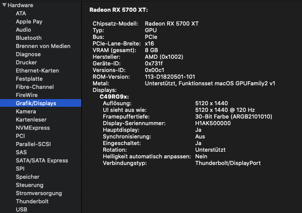

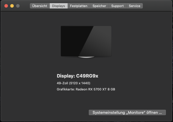

I may have good news for some folks here.
I actually tested to passthrough my 5700XT to my macOS vm and I can tell you it works.
I use macOS Catalina 10.15.7 with clover bootloader.
EDIT: It works half way atm. Restart or a start after a shutdown does not work correctly. I need to start a different vm with an other os started and shut down before the gpu works correctly again in macOS.
I need to investigate that further.
I will keep you updated.
Edited by giganode

In addition, I can confirm that the 5700xt runs just fine with macOS. I just had to reduce the refresh rate from 120Hz down to 100Hz.. This was all I had to do to fix that issue on my setup.
