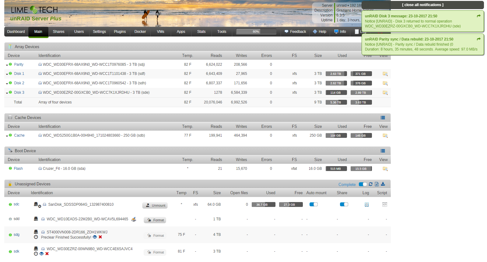

Living Legend Posted October 24, 2017 Share Posted October 24, 2017 First time hard drive fail, so this was the first time I've had to replace a drive. Apparently I did something very wrong as my disk as been "rebuilt" except it's only at 114 GB usage rather than 2.45 TB usage. I've likely already killed off any life lines by formatting the initial disk 3 that had an error This was my order of operation. 1. I wake up with notifications that disk 3 isn't working. I got the red x: I posted on the forums and the recommended action was to replace the disk, but it was mentioned that I could attempt to rebuild with the same disk even though it was unlikely to work. I decided to give it a go. I stopped the array and removed disk 3 from the array on the GUI. Then I started the array up, added disk 3 (my original and broken disk) and selected the option to rebuild. After rebuild, I still had red x. Bummer. I ordered two new hard drives. One to replace, and one to expand. I received the hard drives, popped them in and pre cleared both. Everything looks good. I now stop the array and swap broken disk 3 with my new disk ending in RDHU, another WD 3TB disk. It takes a good 8 hours, but I finally get a message that "Parity sync/Data Rebuild finished". Except one problem. Disk 3 only has 114GB of data rather than the 2.45 it used to have. While all this was going on, I continued to use the array as I've never read of any harm doing so. I continued to read/write to the array. All writing is done to shares, none of which have a specific allocation besides some only to cache drive. Where did I go wrong in my order of operation, and am I SOL on recovering any of my disk 3 data? Link to comment
Living Legend Posted October 24, 2017 Author Share Posted October 24, 2017 Also now realizing that because I use shares which allocated the files, I really have no clue what I'm actually now missing or how to find out. Bigger issue than I initially anticipated. One thing I'm noticing that I don't understand. Why does it say that the last parity check was completed the same time the rebuild ended and found no errors? Does this mean that somehow the parity disk was modified before the new disk was rebuilt? Link to comment

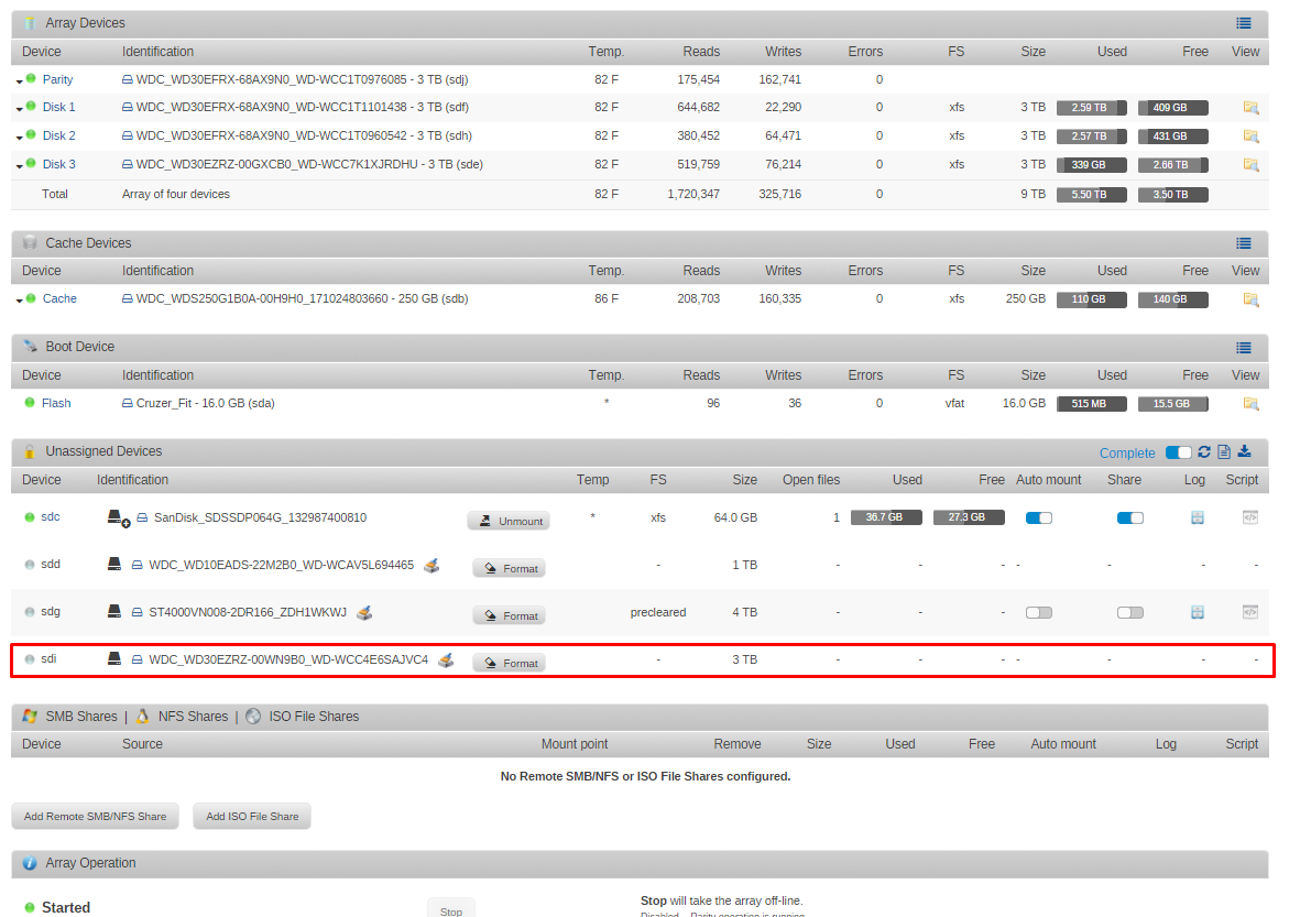

Living Legend Posted October 24, 2017 Author Share Posted October 24, 2017 The disk boxed in red was the original disk 3 of array. It currently shows no file system. Link to comment
JorgeB Posted October 24, 2017 Share Posted October 24, 2017 Depending on what happened exactly the rebuilt disk may contain the original missing data but it was deleted or the filesystem corrupted. You need to use a different computer to run it. Link to comment
