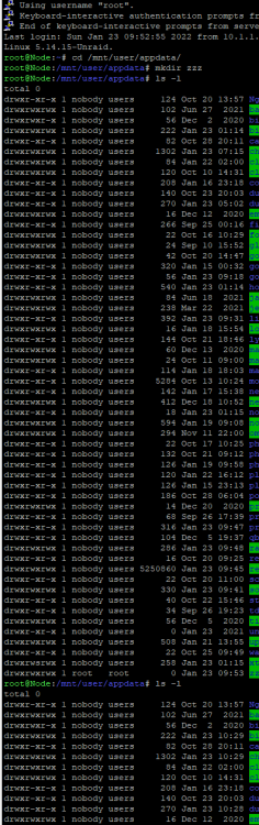

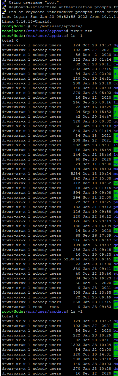

As posted in the other thread(https://forums.unraid.net/topic/47266-plugin-ca-fix-common-problems/?do=findComment&comment=1086953),  I'm investigating cause of the permission/ownership change in my appdata folder.  I ran the backup again last night, confirming the ownership of my test folder have changed this morning again.  Is this is an expected behaviour after running a back up?
before
drwxrwxrwx 1 root   root        0 Jan 19 10:38 test/
drwxrwxrwx 1 root   root        0 Jan 19 10:37 test_delete/
after
drwxrwxrwx 1 nobody users       0 Jan 19 10:38 test/
drwxrwxrwx 1 nobody users       0 Jan 19 10:37 test_delete/
Thanks.
Edited by LeoRX
added link to previous post.

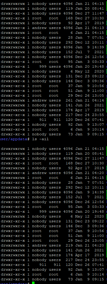

I chmod 0777 the destinations for easy access via SMB.  Source I don't touch.

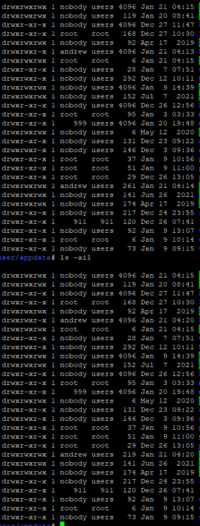

Mine don't change:  Here's my before and after.  The first root:root after andrew:users is a new directory I created, and it didn't change either modify time or permissions.  Are you referencing that test directory in a container anywhere?
The test path is /mnt/user/appdata/test, under Unraid OS.
I just tested it again just to make sure I'm not crazy.
It is very strange no one noticed this behaviour.. which means its either something else that's causing it, something specific to my computer, settings or I'm just crazy.

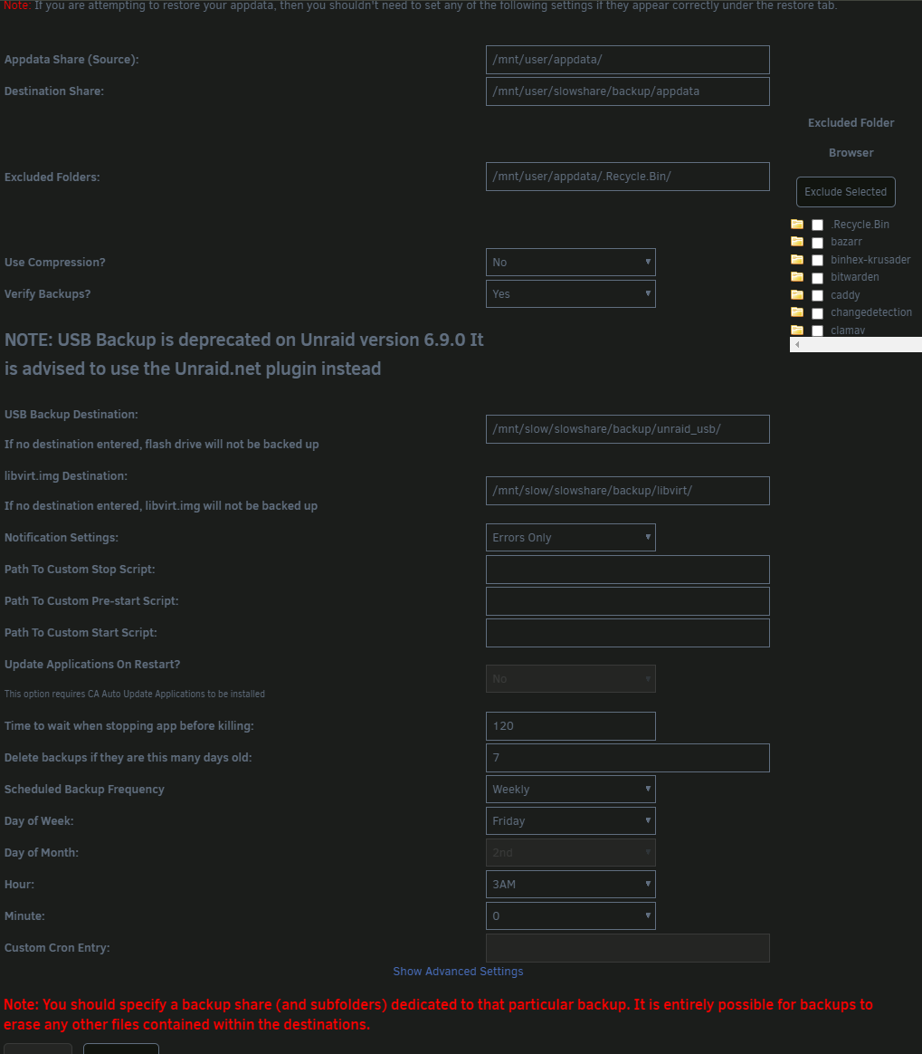

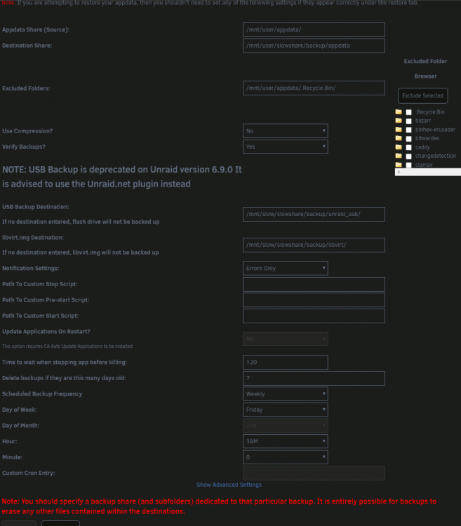

can you please confirm if your destination share path is default or customised path?  If its default, will you mind test it with a custopm path please?
There are no preset paths in the plugin.  They are all user entered (except for the source which is populated by what ever is in Docker Settings - Default appdata)
The way to test is that it is logged the exact command used to backup.  Stop all the containers, look at the permissions, run the command and look at the permissions after its complete.
umm.. I remember seeing the default destination path was something along the line of \mnt\user\CA**Appdata***.

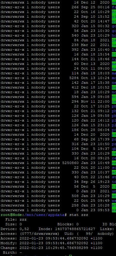

What you've described is exactly how I tested.  I did in the following step.
1. create test folder
2. verify test folder is root
3. run backup using backup now button. wait for it to complete
4. check test folder ownership. and confirm it has changed to nobody.
1.thumb.png.8ef43c5f0417f39d3a21143765b49594.png2.thumb.png.b7966880117a18754f3fc6eb66bab813.png
in this case, test folder is zzz.  as you can see the owner was changed in a short amount of time, after running backup.
oh well.. i'm lost for word.. I understand if it can't be reproduced, it'll be difficult to reproduce.  I've migrated my mariadb and nextcloud container to use linuxserver.io so PUID and PGID can be set so it is not longer of an issue even with the ownership change.
