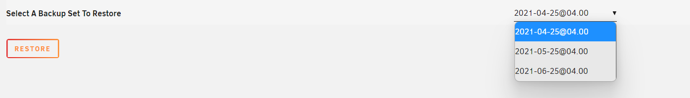

So my monthly backups run on the 25th, and like clockwork I've recived a Pushover notification that it has completed the backup.
I've suffered data loss, and I have no idea what happend. My influxdb appdata folder is suddenly completely empty (no settings, no database). I figured I'd just restore the latest backup, but they apparently haven't been stored for the past couple of months..
Anyone got any idea what could have happend? Both with the influxdb and with this plugin. My settings:
The logs would have stated that an error of some sort happened during the backups.  In an error situation, the old backup sets don't get deleted.  This is why your earliest set 4/25 still exists.  Pretty sure that a notification goes out in the error situation
