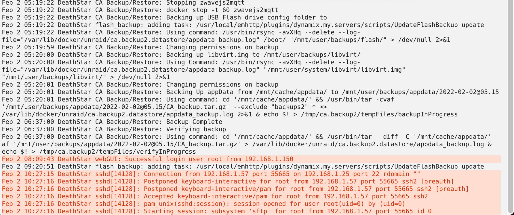

On 11/12/2020 at 1:00 PM, Squid said:
If either /tmp/ca.backup2/tempFiles/backupInProgress or /tmp/ca.backup2/tempFiles/restoreInProgress exists then a backup / restore is running
I realize this is an old post, but I have a backup that is going on 6 hours now and it normally does not take anywhere near that.  I see the backupinprocess and verifyinprocess file in that temp dir but is there any way to see if it hung or there are any other issues?  UI is saying verifying still too... Logs align with that as well.  image.thumb.png.2794b936c1139940964da3149c6b26f8.png
Edited by jbrown705
add more info
The Progress tab should tell you where and what it's doing.
I checked there first and the processing tab and the temp file dir match statuses. However, I was trying to check to see if the verifying step had hung. It did finish but took nearly 10 hours for some reason this time. I was just looking to see if there was a way to see what was happening during that verification stage. Not sure if it’s possible based on how the code works but do you think it’s realistic to ask that maybe in the status tab for a progress bar to be added for each step? They people would be able to see if the bar is not progressing or just moving slowly?

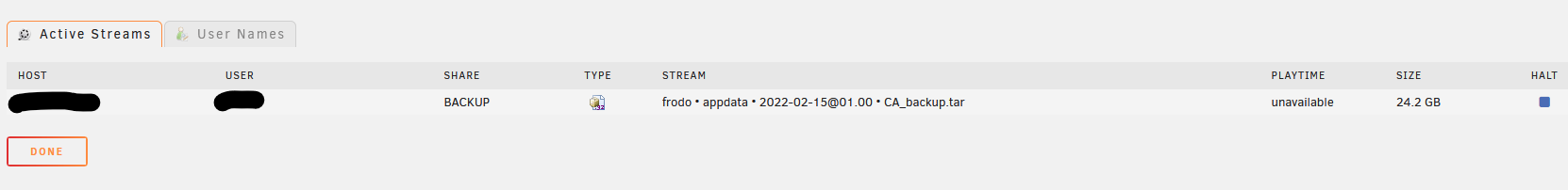

Hello, seeking for help. One of my discs won't suspend. The only active stream is this one:
Seems like hang? What could be causing this behavior?

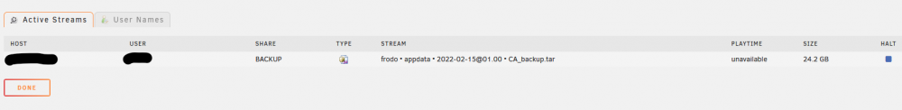

It's either still backing up or verifying

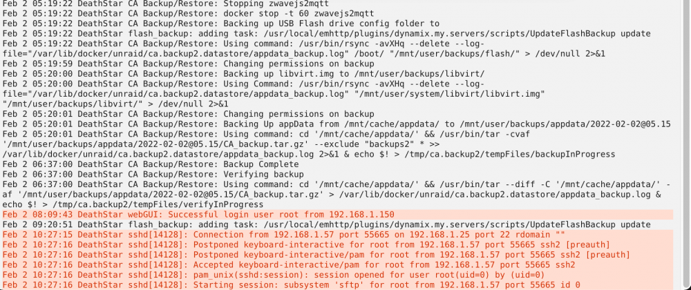

Hello, I've been using this plugin without issue for several months, but last night I ran into a problem. My weekly backup happened to go at the same time that a parity check was running, this caused the backup to run so slowly as to still be running 5 hours later when I woke up (and so all my containers were still shut down). I paused the parity check and the backup and auto-update completed within 20 minutes.
I suggest a solution to this would be an option that would allow us to select what to do if the scheduled backup time arrives and a parity check is also running. Likely options should be pause parity check and resume after, skip backup, delay backup, perhaps more options. I looked for an option like this but I couldn't see one.
Cheers!
@SquidHey Squid, i'm currently still running the v1 backup and restore app and i really like it as when i need to recover a config file or an individual file i can simply hop into the backup and hop into the folder and grab the file without having to restore the whole backup which i believe was what the v2 app does when i originally moved over to it? You mentioned on the first post:
"Due to some fundamental problems with XFS / BTRFS, the original version of Appdata Backup / Restore became unworkable and caused lockups for many users.  Development has ceased on the original version, and is now switched over to this replacement."
Can you explain what the issues with the v1 app were exactly and how it was causing issues? Did it ever crash unraid at all for any users? I'm currently troubleshooting my array and my only warning from the community 'fix common issues' plugin is that i still run the v1 plugin... i'd love to know more.
Cheers!
I might look into what would be needed in the parity check tuning plugin to add such a feature there.  Since that plugin already handles intelligent pause/resume of parity checks it feels as probably the best place to add such a feature.  I recently added an option to that plugin to pause a parity check while mover is running so this seems a similar option.  I would just need to work out the best way to detect if CA Backup is installed (and if not suppress offering this as an option) and if the backup is currently running.
Any thoughts on whether this would be a sensible way to handle this?
