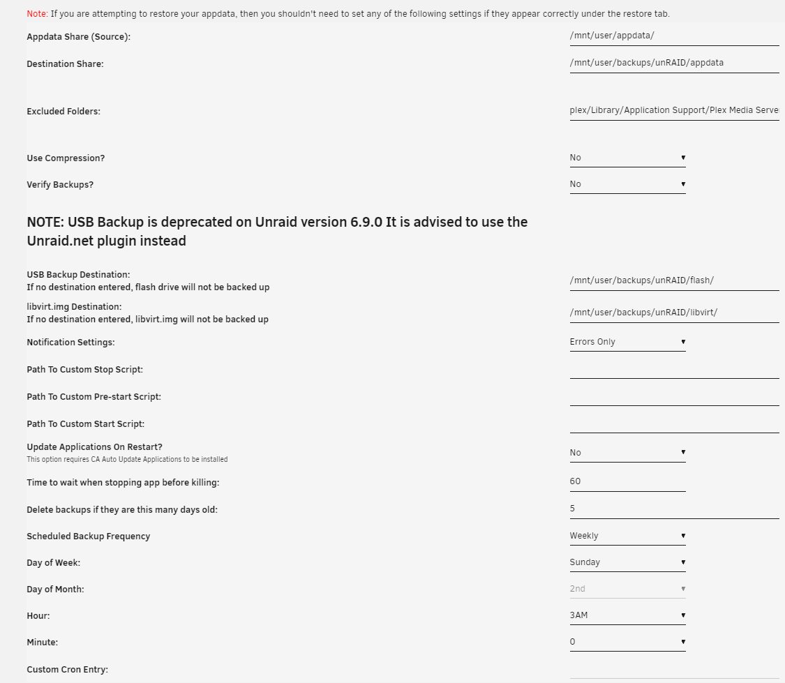

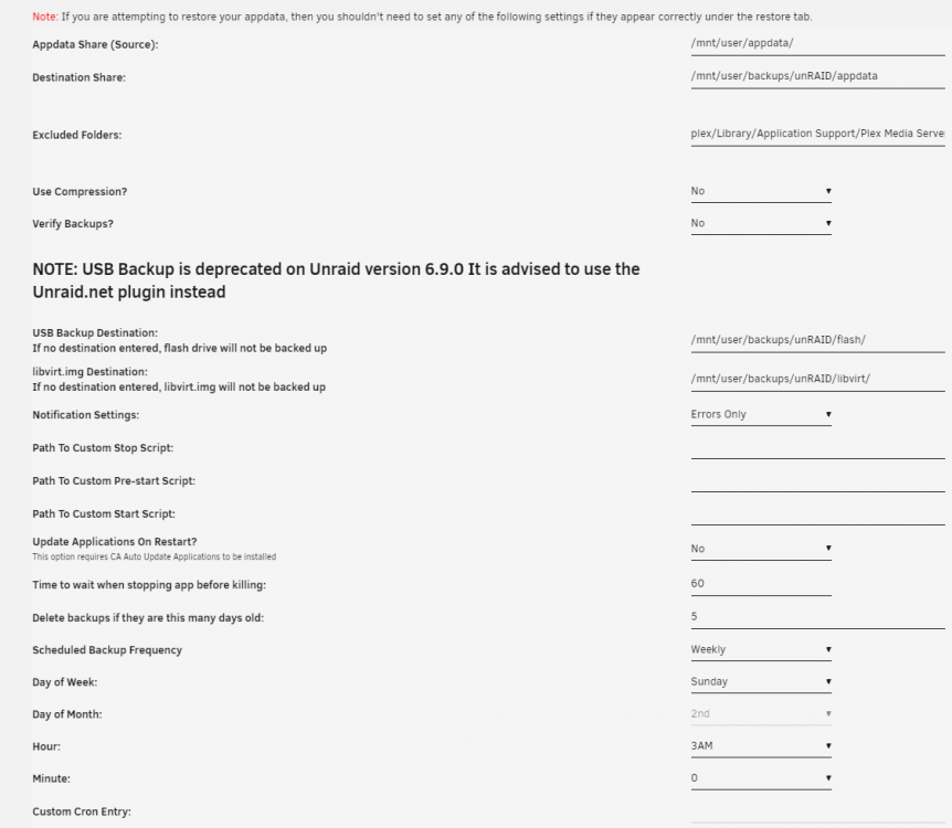

Two weeks in a row now I have experienced a really strange issue.
CA Backups run just fine and my tarball is created at the size I expect, but after the backup is completed my containers restart but many of them end up without any real Internet access, it is very weird.
My reverse proxy stops serving my hosts outside my home, pihole stops being able to fetch DNS requests from the outside DNS servers (like 8.8.8.8), it's very strange.
I have fixed all the odd issues both time so far by just rebooting the server, however I feel like something is wrong at this point since it's happened two weeks in a row.
I did NOT happen ever on 6.9.X, but it is now on 6.10.X
Any help or advice appreciated, my config is attached.

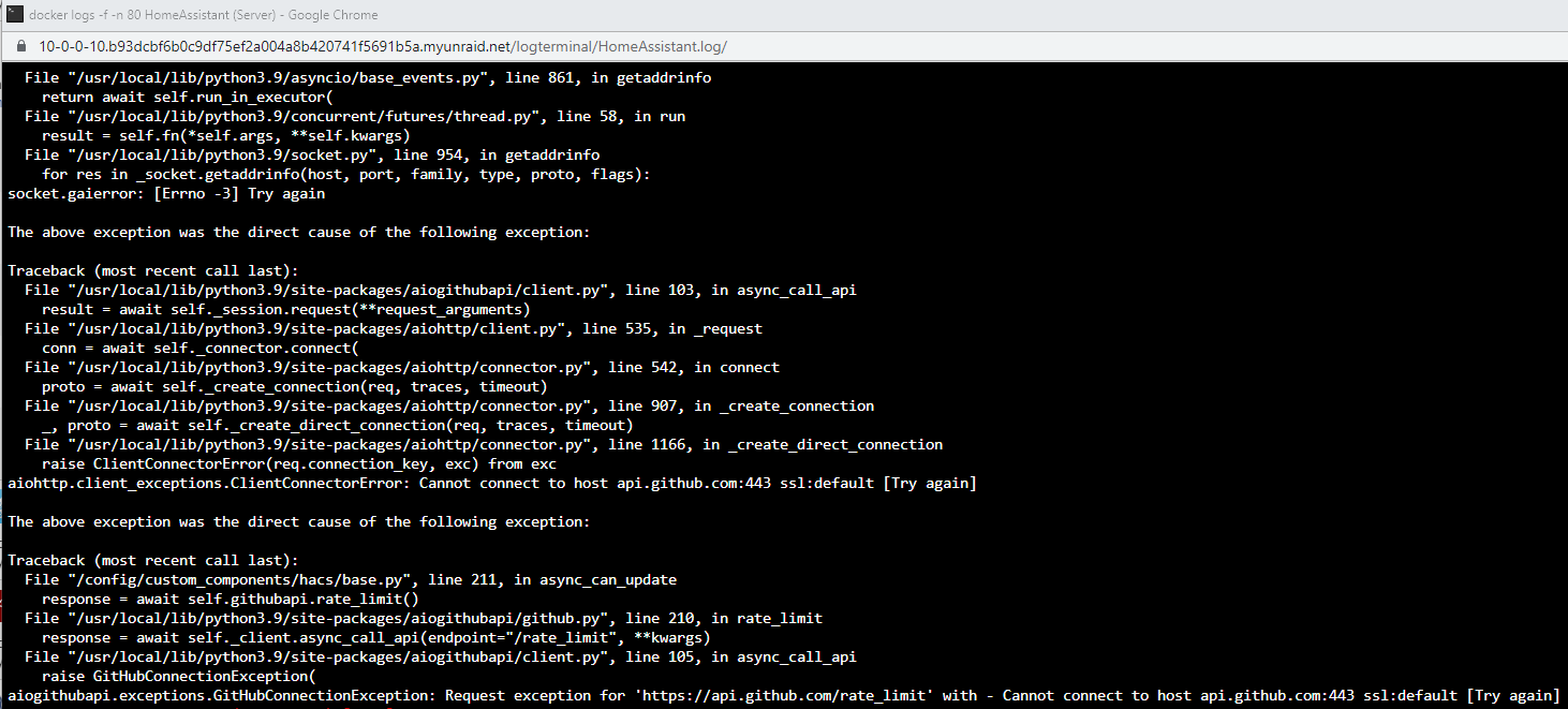

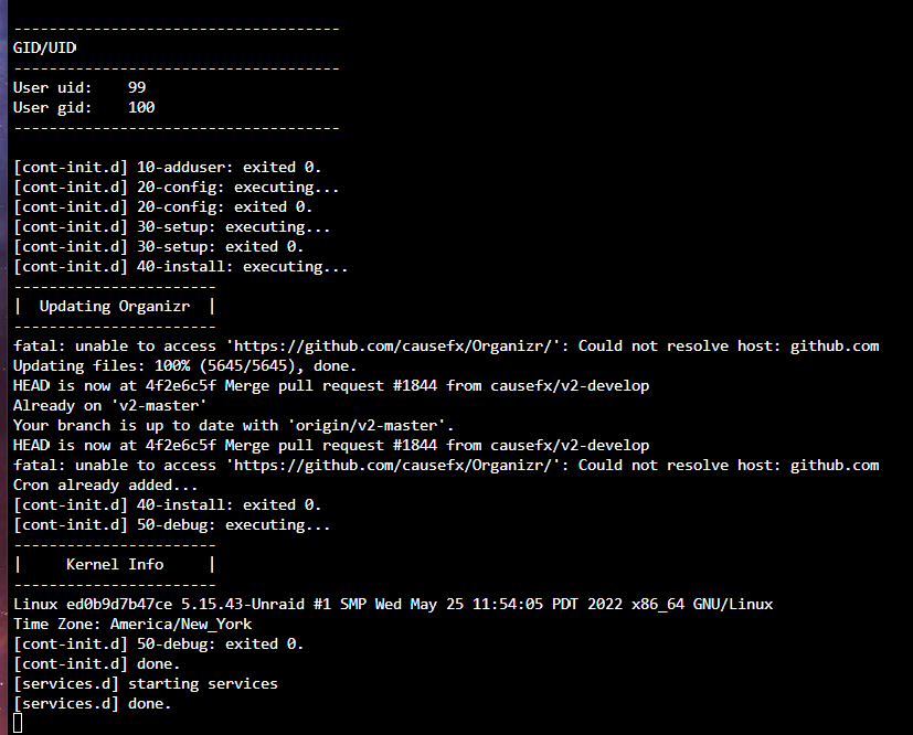

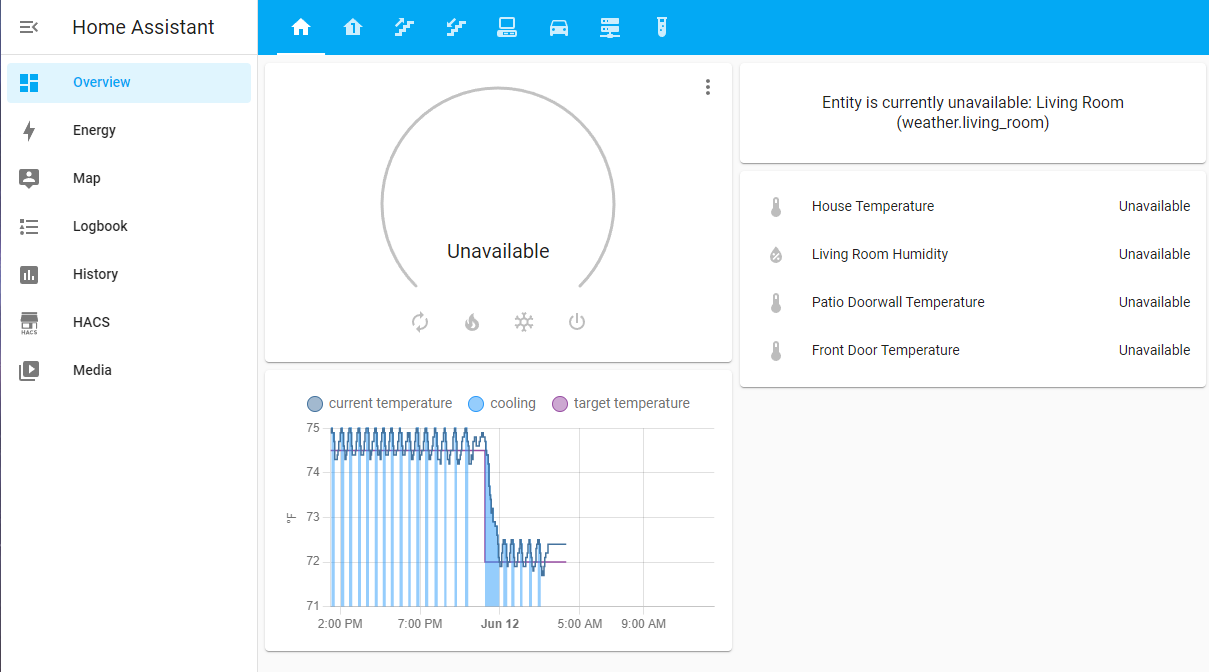

So this is the 3rd week in a row -- my docker containers went down at 3AM on Sunday morning and I didn't get notice that the website served by reverse proxy came back up until 1PM, so for 10 hours it was down.
Not sure what to do or where to look.
I have a few screenshots that may or may not be helpful of a few containers that don't have proper access to things after a CA appdata backup and restarting the containers.
Notably my CloudflareDDNS container doesn't start up properly and homeassistant can't actually communicate w/ sensors
Seems like a networking issue somehow after the 6.10.x updates.
All I've done is change to ipvlan instead of macvlan as suggested to avoid crashes (which I was certainly experiencing on macvlan w/out a docker VLAN setup separately)
Any assistance or advice here is appreciate, or what I could possibly check for in logs to find out what is happening.
Thanks in advance.

Backup / Restore Status: Not Running
Backing Up appData from /mnt/cache/appdata/ to /mnt/user/backups/appdatabackup/[email protected]
Executing tar: /usr/bin/rsync -avXHq --delete --log-file="/var/lib/docker/unraid/ca.backup2.datastore/appdata_backup.log" "/mnt/user/system/libvirt/libvirt.img" "/mnt/user/backups/libvertbackup/" > /dev/null 2>&1
2022/07/03 07:23:06 [10626] building file list
2022/07/03 07:23:06 [10626] sent 75 bytes received 19 bytes 188.00 bytes/sec
2022/07/03 07:23:06 [10626] total size is 1,073,741,824 speedup is 11,422,785.36
Verifying Backup
Using command: cd '/mnt/cache/appdata/' && /usr/bin/tar --diff -C '/mnt/cache/appdata/' -af '/mnt/user/backups/appdatabackup/[email protected]/CA_backup.tar.gz' > /var/lib/docker/unraid/ca.backup2.datastore/appdata_backup.log & echo $! > /tmp/ca.backup2/tempFiles/verifyInProgress
Searching for updates to docker applications
Backup/Restore Complete. tar Return Value: 0
Backup / Restore Completed
Edited by stultus
Is there anything in /mnt/cache/appdata?  Looks like there's nothing to actually backup.
I uninstalled plugin and then reinstalled which forced me to remap path. Now I'm backing up /mnt/user/appdata and it's humming along again!
On 6/27/2022 at 1:01 PM, CorneliousJD said:
I stand corrected on the manual run, I turned on checking for app updates after a backup, and it hangs there too now. Here's relevant system log info below that happens when invoking a CA appdata backup.
I am unable to ping known-good addreses, such as 8.8.8.8 or 9.9.9.9 I just get
From 10.0.0.10 icmp_seq=1 Destination Host Unreachable
EDIT - I decided to make a new thread for this as this seems to be some pretty weird, possibly deeper and/or system related issue, and I don't want to muck up Squid's thread here.
New thread here for anyone who has any suggestions to help me on this.
Just wanted to note that I reverted back to macvlan and a separate docker VLAN for the few containers that need static
IPs set.
so far issue has not resurfaced.
bug report created here. - if anyone is interested in chasing this further.
