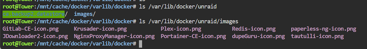

I think I found something which could be interesting for your appdata backup plugin:
If the docker service is stopped and the user install your plugin, it creates the following in /var/lib/docker:
Not sure how important those files are for your plugin, but they aren't present anymore after the docker service has been started (as the mount /var/lib/docker > /mnt/user/system/docker/docker "overwrites" the path).
Now I hope you can help me as well:
I'm working on my own plugin to create a RAM disk for /var/lib/docker/containers. By that this happens after the docker service has been started:
  • unraid mounts /mnt/user/system/docker/docker to /var/lib/docker
  • my enhancement creates a backup of /var/lib/docker/containers
  • then it creates a ram disk through tmpfs of /var/lib/docker/containers
  • then it restores the backup into the ram disk
  • all containers start as usual, but this time they write logs/json files to the RAM instead of the SSD
  • the cache SSDs are sleeping until the backup schedule is executed
This works perfectly, except your plugin creates /var/lib/docker/unraid while the docker service wasn't running. This time, after enabling the docker service, everything seems to work as usual: Unraid mounts the docker path, my enhancement creates the ram disk..., but now the cache SSDs are not sleeping. Everything which is written to /var/lib/docker/containers, is written to the cache SSD's /mnt/cache/system/docker/docker/containers?! I really don't understand why this is happening. Do you?
It's all actually correct.  dockerMan itself creates those icons because the plugin uses them and if the image isn't mounted it creates it in memory.  The same thing that the logs for the plugin are also stored in memory if docker isn't mounted.  By and large, this is a edge case because it's doubtful that anyone will ever run the script without docker running, but it has to handle that situation.

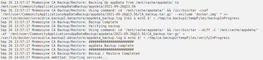

Ok, I'm completely lost. I've got a perfectly generic UnRaid config, trying to back up /mnt/cache/appdata/ to /mnt/user/CommunityApplicationsAppData/appdata/
It runs the backup without errors, and creates the dated subdirectory... but it's empty. No .tar, no nothing. I've tried with compression both on and off. I've got to be missing something obvious, right? Changing it to /mnt/user/appdata/ results in a full backup.. but the data lives on the cache anyway, so I'm not sure why the default value isn't working!
I didn't change anything else in the CA AppData Backup configuration, no excluded folders, etc. It stops the dockers fine, ought to be backing up binhex-plexpass's data. Total size on cache is 2.65 GB.
