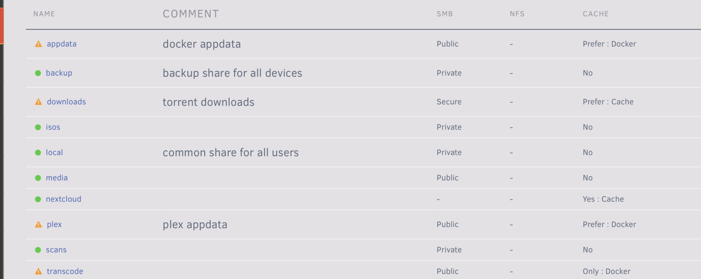

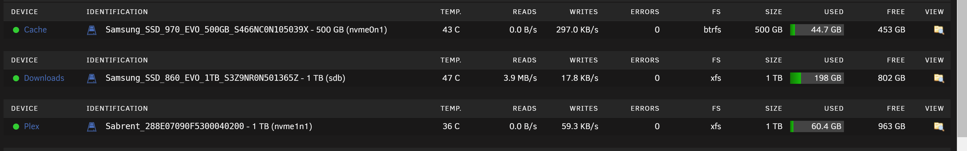

21 hours ago, shiftylilbastrd said:
/disks/cache2
This seems like the path to an Unassigned Device. I mean multiple pools as provided by Unraid 6.9+
Since all pools are part of user shares, you can just backup the user share path to appdata and get all appdata from all pools.

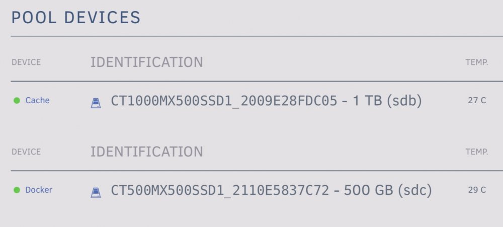

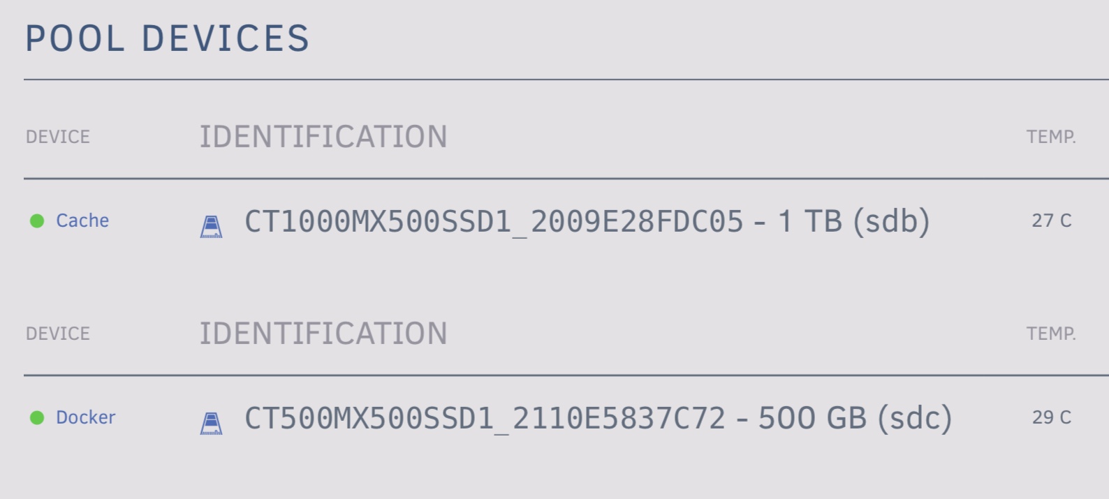

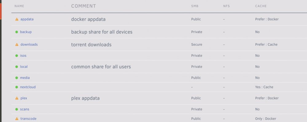

See my current setup in attached pics
Plex appdata on one pool, everything else on the other. Can only specify one source for backup.
Scenarios
Two pools of one drive each
If I only use one share for all appdata I can only specify one pool to send it to
One pool of two drives
All appdata is distributed between the two drives
Neither case allows me to dedicate one drive to Plex only. If I’m wrong please help me understand what I’m missing here.
According to your screenshots, appdata and Plex share are both using the docker pool. You have another pool named cache which is not being used for this.
What I was suggesting is more like what you said you were doing, which is using one pool for plex appdata, and using the other pool for other appdata.
You could put plex appdata on docker pool, and other appdata on cache pool.
plex appdata would be at /mnt/docker/appdata, other appdata would be at /mnt/cache/appdata.
All appdata would be at /mnt/user/appdata, and you could backup all of it using that path.
