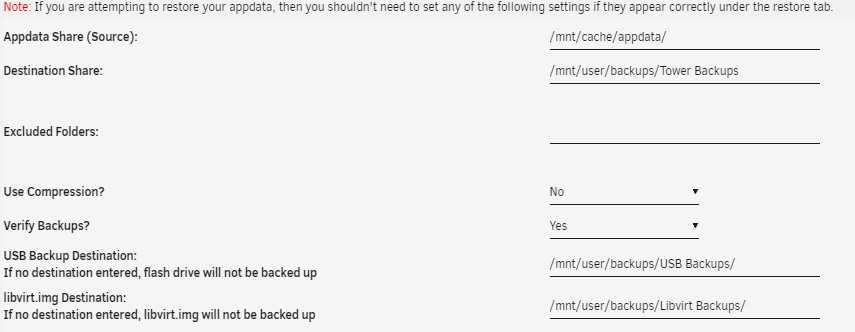

This is what I have for settings
If I browse to \\tower\backups I can access USB and Libvirt folders fine, but not access the subfolders under "Tower Backups". My user does have read/write. I have not done anything for permissions other than what's done on the Shares page within unraid.
The update will probably fix you up

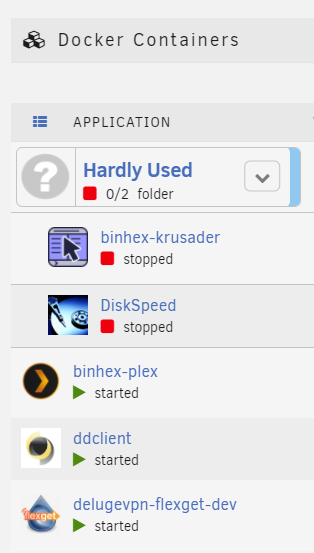

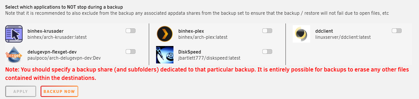

I just setup the CA Backup/Restore for 1st time.
Left all my Docker apps unchecked but binhex-krusader & DiskSpeed didn't get backed up, they are in a Folder done by Docker Folder plugin.
How they look in my Docker tab.

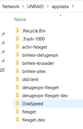

2nd question, does CA Backup/Restore back everything in the appdata share if I don't exclude any?
Even if that Docker is not currently unstalled? i.e. binhex-delugevpn isn't installed but I have a folder for if I installed again.
Edited by Paul_Ber
