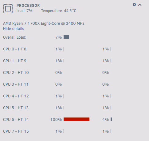

The plugin works really well for the task but is it intended behavior that only one thread is used for compression? I think on a multicore CPU there could be substantial performance improvements if more cores are used for this task.
If there is no better method available on Unraid by default, maybe make it optional if a better compression program is detected (e.g. pigz installed via NerdPack)?
I think anyone can profit from this as multi-core CPUs are the norm nowadays.
It uses the built-in tar.   IIRC, installing pigz via NerdPack causes compatibility problems...

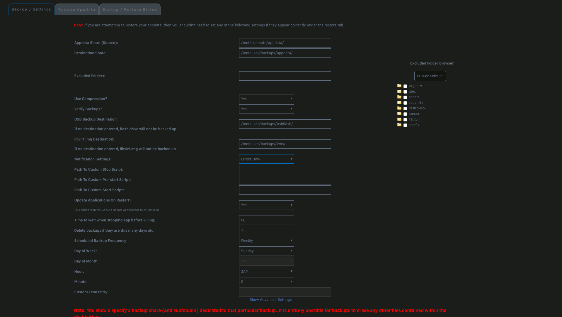

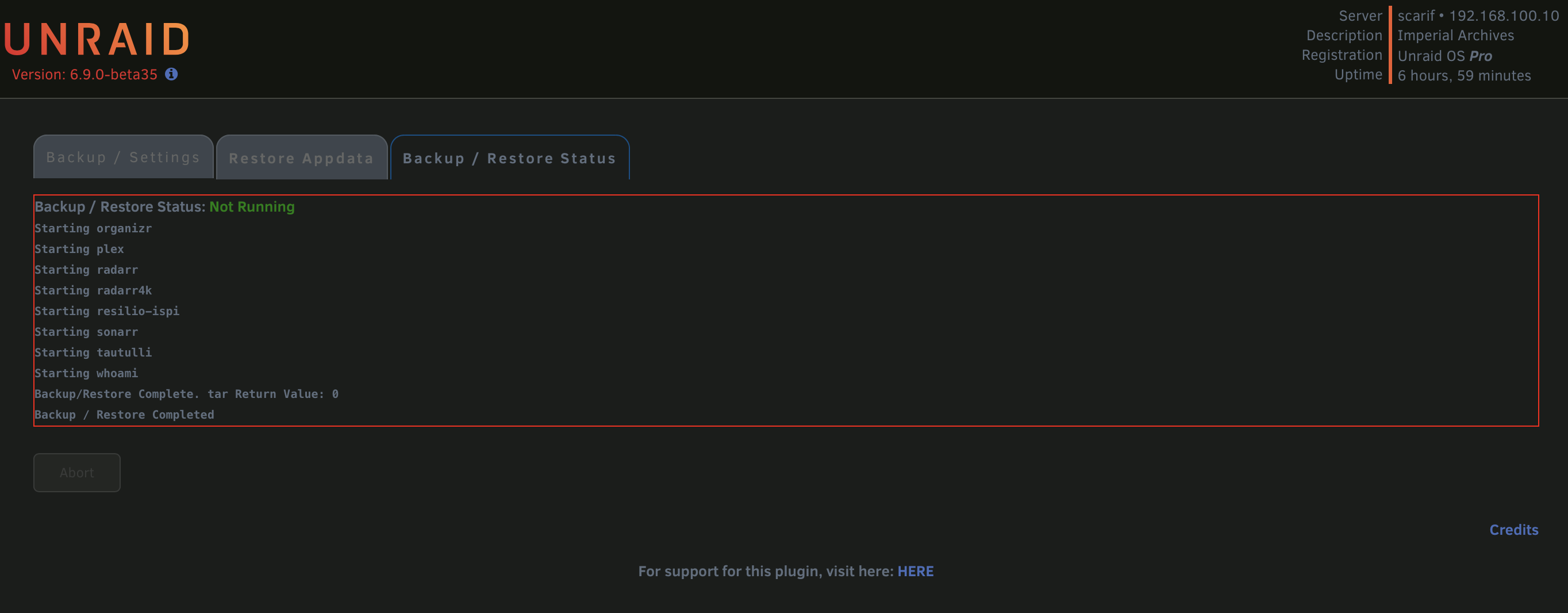

Is there a way to troubleshoot why the backups aren't getting automatically executed? I have the plugin configured to backup everything on Sunday morning at 3am, but nothing appears to be happening during that time. I get no backup files in the defined backup locations or anything.
I also tried a manual backup and it says it completed successfully, but still nothing is generated in any of the defined locations (appdata, vm or usbflash).
Edited by amiskell
A screenshot of the settings, and your diagnostics covering that time period would be needed
scarif-diagnostics-20201205-1408.zip1234117438_ScreenShot2020-12-05at2_05_45PM.thumb.png.11306d9a622b7b7472729e4f3f40ce2a.png2027068954_ScreenShot2020-12-05at12_53_28PM.thumb.png.efaf3e469e654a2a3c14e79b6793986d.png
The diagnostics don't cover Sundary the 29th.  Post new diagnostics Monday AM
But as I mentioned, not even a manual run appears to be working. It says it completed successfully but there's no backup files generated. I took that diagnostics zip right after attempting a manual run.
I suspect that it is actually running at 3am, but just not generating any output of the backup data.
