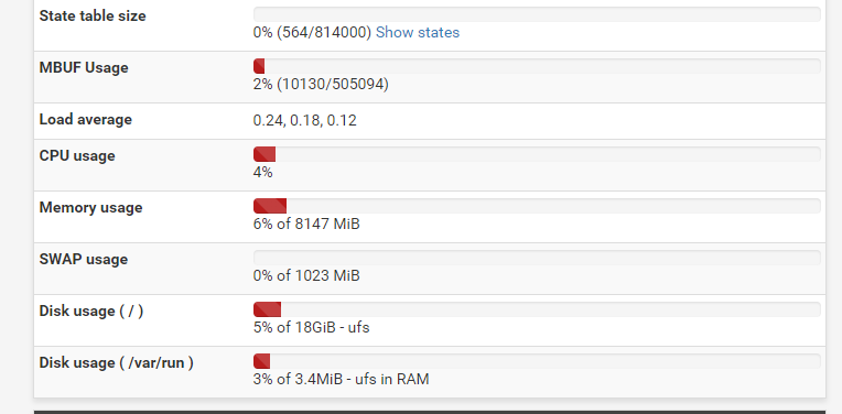

What spec is your unRAID server?  I've just gone back to running pfSense in a VM as I've managed to free up a PCIe slot for my nic that only cost me £60 and it's barely using any resources:
5a06b499b26ce_FireShotCapture4-Woody.localdomain-Status_Dashboard-http___172_30_12.1_.png.a32626ac7db512478e8905b733c08d43.png
I've assigned 2 cores from my server.  Admittedly, this is before setting up squid, vpn, snort etc (I'm doing a fresh install rather than restoring my backup) but they still only took my CPU usage to around 25% from memory.
