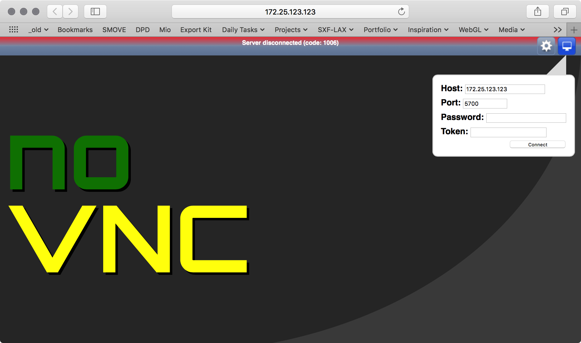

So after finally getting my ducks in a row, to some extent (not by means of a full hardware rebuild, but an incremental hardware upgrade), I got to the point of enabling VM's, creating the necessary shares (and this is where my problems might lie), placing the Windows 10 and Win drivers ISOs in the isos folder, pointing the Windows 10 template at the necessary iso, but when I click the "Create" button with "Start VM after creation" enabled, I get the Windows 10 icon with a green play button, but the install never happens.
When I select the "VNC Remote" option I get the attached screen, but nothing more.
I'm about to hit the sack over here in Berlin, and I know that this is nowhere near enough information to troubleshoot what I have done, but I thought I'd get the thread going before I have to get up at the crack of dawn, take an 8hr train down to Bavaria and then hopefully be back online again late on Sunday to see what I might be able to do, from afar.

tried that just now, but still no go...I get a "Server disconnected (code 1006)" error at the top of the noVNC window, for all its worth.
is the "Token:" field in the noVNC connect pop-up something I'll need to worry about? I am leaving it empty, since I don't even know what it is. I just set up a password for that VM's VNC, since the other one didn't have one, but the behaviour is the same: no go.
