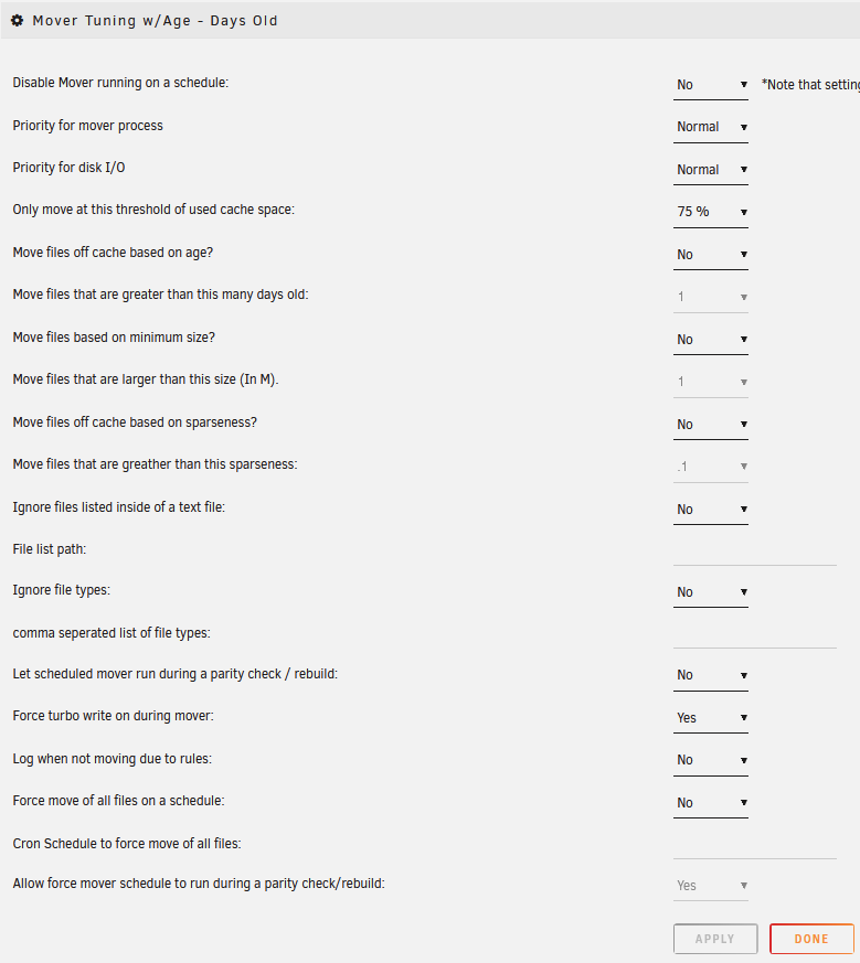

these are my settings and full diagnostic-file
tower-diagnostics-20210309-1632.zip

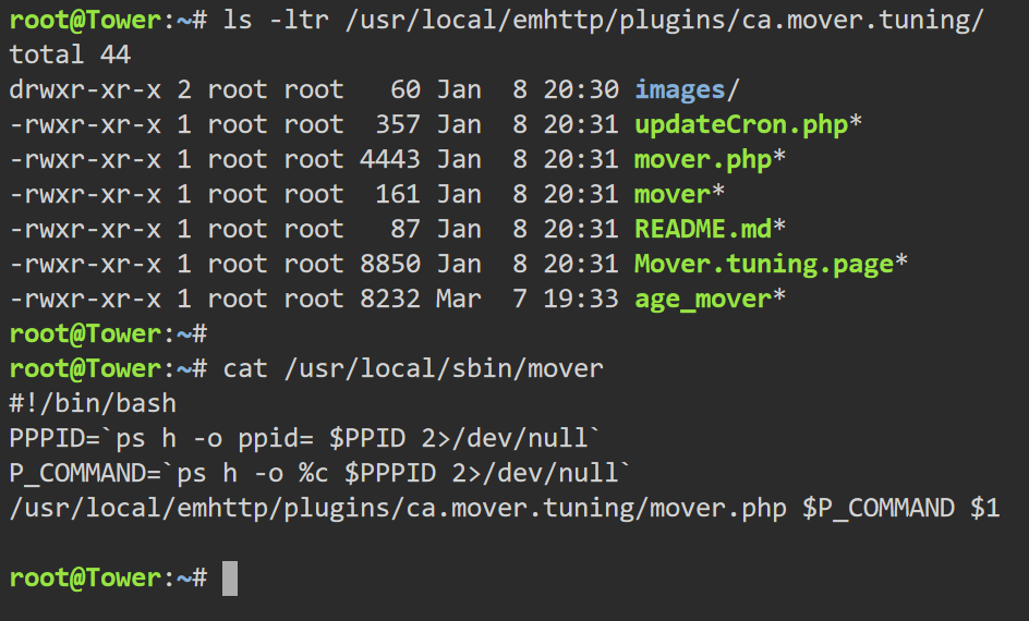

Can you run these two commands from the console?
ls -ltr /usr/local/emhttp/plugins/ca.mover.tuning/
cat /usr/local/sbin/mover
done. here the results:
That's good.

my Permissions look the same, and .cfg file looks okay for me:
root@Tower:~# ls /boot/config/plugins/ca.mover.tuning/ca.mover.tuning.cfg -lisah
5360 4.0K -rw------- 1 root root 281 Mar  7 21:30 /boot/config/plugins/ca.mover.tuning/ca.mover.tuning.cfg
root@Tower:~# cat /boot/config/plugins/ca.mover.tuning/ca.mover.tuning.cfg
moverDisabled="no"
moverNice="0"
moverIO="-c 2 -n 0"
threshold="75"
age="no"
daysold="1"
sizef="no"
sizeinM="1"
sparsnessf="no"
sparsnessv="1"
filelistf="no"
filelistv=""
filetypesf="no"
filetypesv=""
parity="no"
enableTurbo="yes"
logging="no"
force="no"
cron=""
forceParity="yes"
Tried to change some settings and pressed APPLY ==> Mover still runs without recognizing percentage-threshold.
Your IF-Statement seems to be the reason for this Issue. I will wait for your update.
