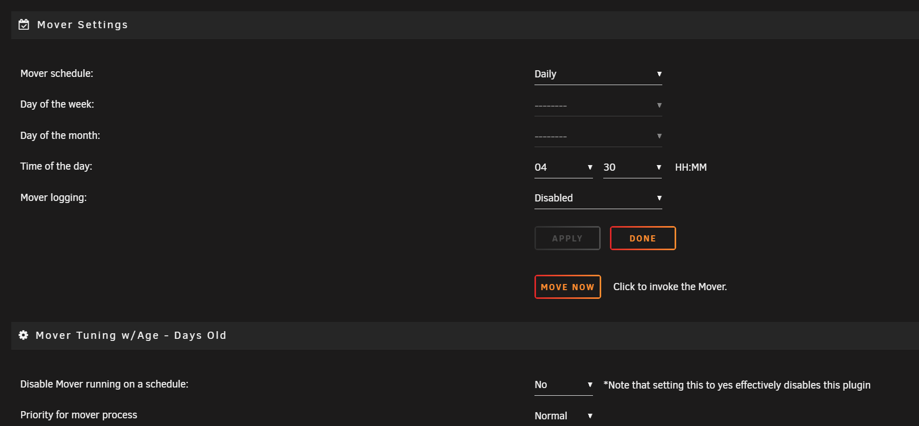

Can you post a pic of your schedule page or let me know what you have in the file ignore box so I can try and reproduce on my end.
Sure. Screen attached. The contents of moverignore.txt is (probably redundant):
/mnt/cache/Share1/.DOWNLOADS/
/mnt/cache/Share1/.DOWNLOADS/*
