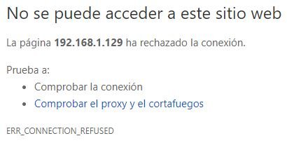

From my iMac, chrome says the connection is refused, and if I go to the server and use the GUI, I can logon using the root user with the password, but Firefox says it can connect to the local host.

Thanks for taking the time to reply.
I can't access it form my iMac. Chrome keeps saying "Connection Refused" (see first attachment)(sorry, it's in spanish...)

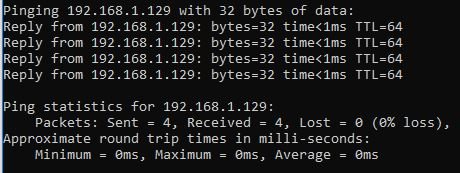

But if I ping to it, it's alive (see second attachment).
