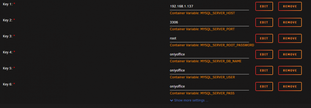

Do we need to create MySQL container and the bridge onlyoffice network like in the wiki
sudo docker network create --driver bridge onlyoffice
Edited by Jidovu Marius Adrian

Well I did manage to get past mysql issue by using an external mysql docker, but i did run into another one.
+ service god restart
Restarting god... The server is not available (or you do not have permissions to access it)
OK

This is the last error I need to fix.
Can I have your Container Config page screen shot? Also can you try enabling priverage mode
Sent from my Pixel 3 using Tapatalk

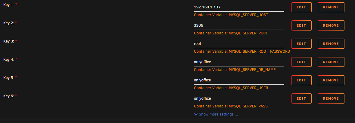

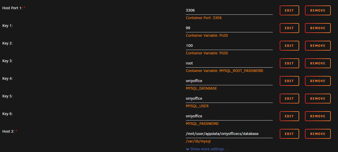

This is what I added extra to your onlyoffice community edition docker as variables and the other one for mariadb docker, same extra parameters were added to the mysql docker but I had another issue with the mysql docker with binding.
First picture is the mariadb and second is your docker extra parameters.
wrong picture
Your docker was running with Privileged mode, but not mariadb.
