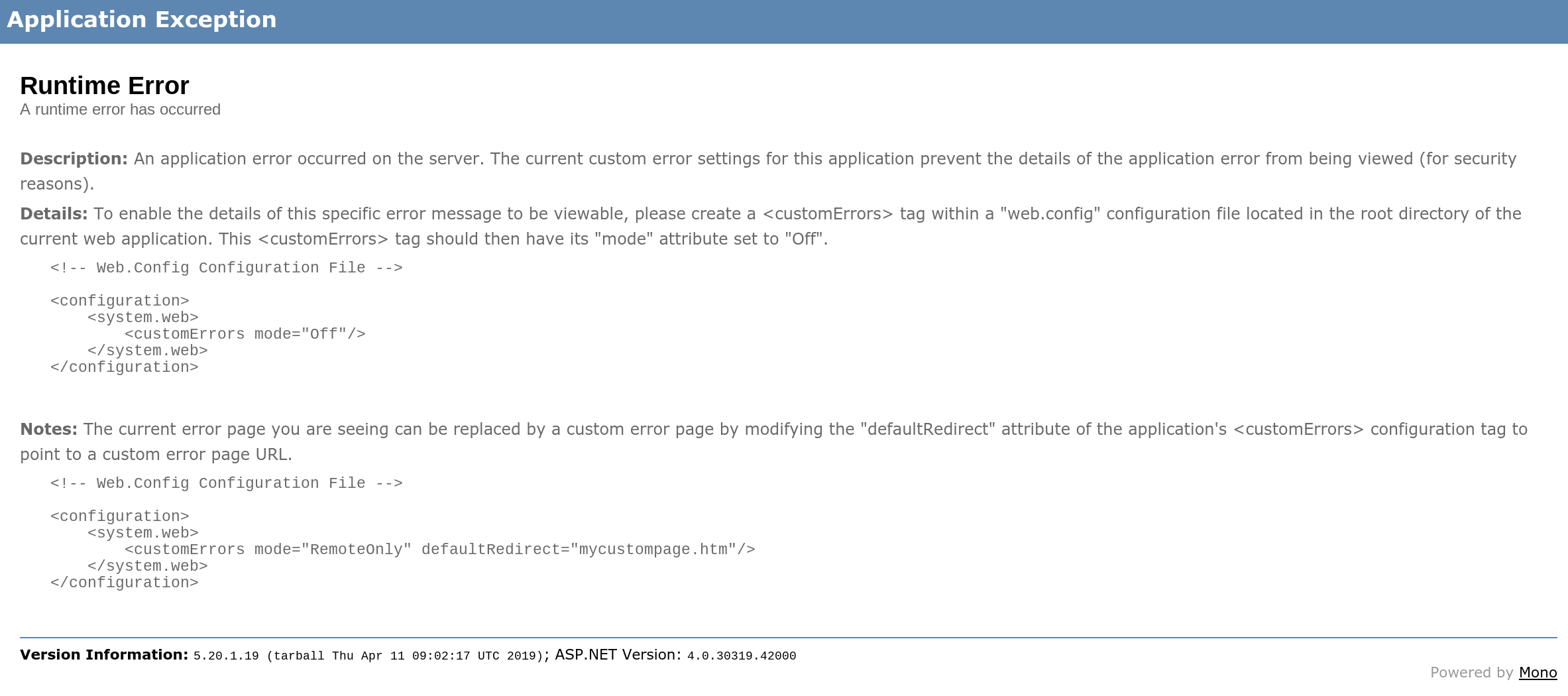

I got it work with Nextcloud and locally (community server); however, today, I get this when I tried to access the community server.
This was working before.

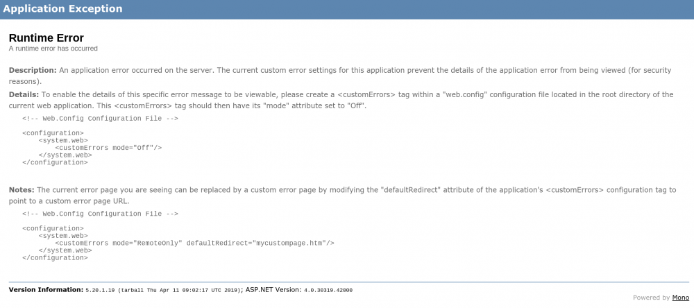

Same issue here after a weekly, scheduled update. Tried a fresh install and still have the same problem.
I tried to reinstall and still got the same page.
Can you try changing the directory
Sent from my Pixel 3 using Tapatalk
Where do you change settings in h265ize, such as changing output format to 720p?
I am sorry I am not familiar with your software. What do you mean by changing the directory?
Can you please be more specific?
Changing the config directory in unraid docker config (used to be/mnt/user/appdata/onlyofficeds or onlyofficecs)
It is still didn't work. My appdata is in cache. I tried to move everything to the /mnt/user/.. but I still getting the same Runtime Error
