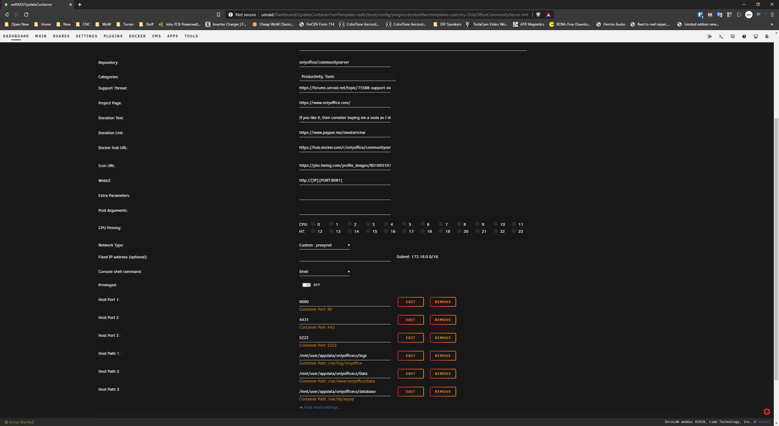

Screenshot the container config for me
Sent from my Pixel 3 using Tapatalk

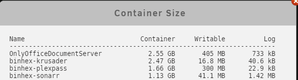

Is anyone elses container size this large for OnlyOffice?
Here it is, I also tried to switch from proxynet to Bridge, same results :(

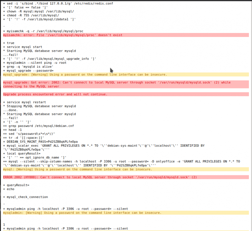

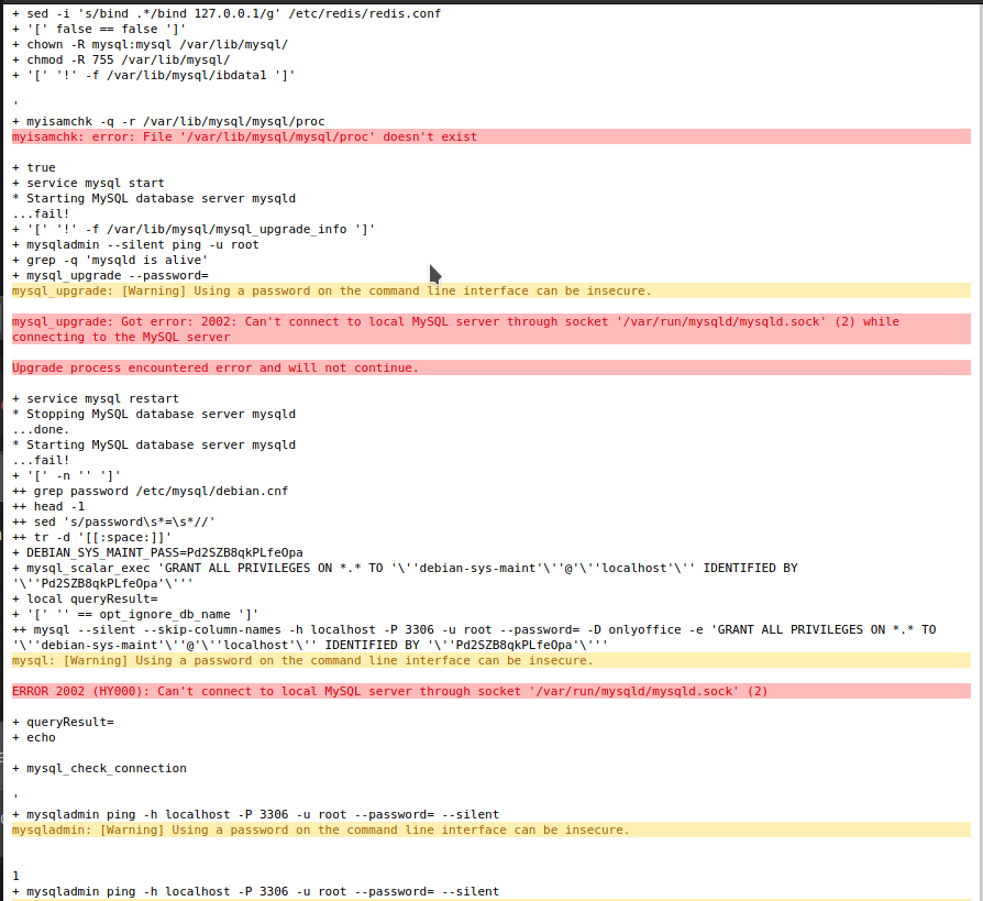

Have most likely the same issue as @jmonteiro, @ndaringer, @Hendricks,@GitBoxer and @Jidovu Marius Adrian.
OnlyOffice CommunityServer wont start successfully from a clean slate. Repeatedly tried a fresh start (btw tricky cleaning up there, with the cleanup plugin you have to run cleanup twice so all remaints are gone), but always the same thing, an infinite initialization screen (as shown elsewhere), with errors in the log and eventually infinite starts of mysqld failing again and again.
Attached is a screen of the log where I think its going wrong (screen because of the colorcoding). What is the purpose of the line
myisamchk -q -r /var/lib/mysql/mysql/proc
and could mysqld fail to start because that command failed? it is the first error in this log, earlier there are just a few warnings:
rsyslogd: activation of module imklog failed
 and
+ service nginx restart
* Restarting nginx nginx
start-stop-daemon: warning: failed to kill 21157: No such process
Edited by 9smtm6
