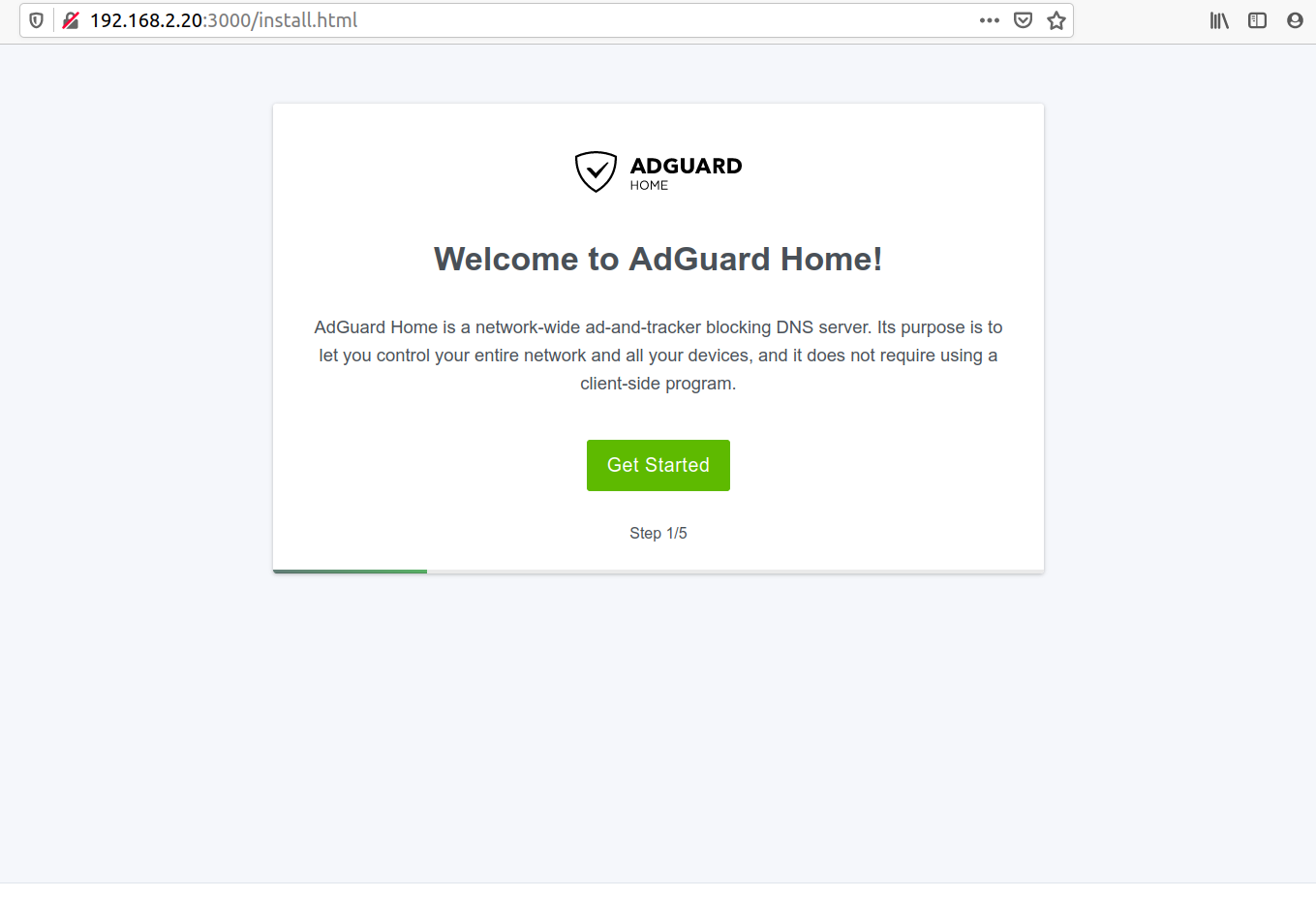

On 9/28/2020 at 6:43 PM, xanvincent said:
Is the Adguard Home container working? Console doesn't work (just a black screen) and WebGUI doesn't load. I don't see anything created in the conf directory either.
Yes i got is working today if you still need some help and can share  some screenshots and tips.
If you have some pointers that could be useful.

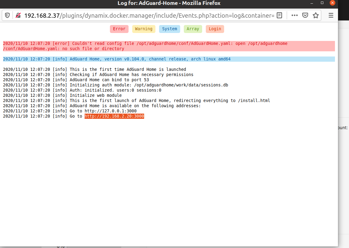

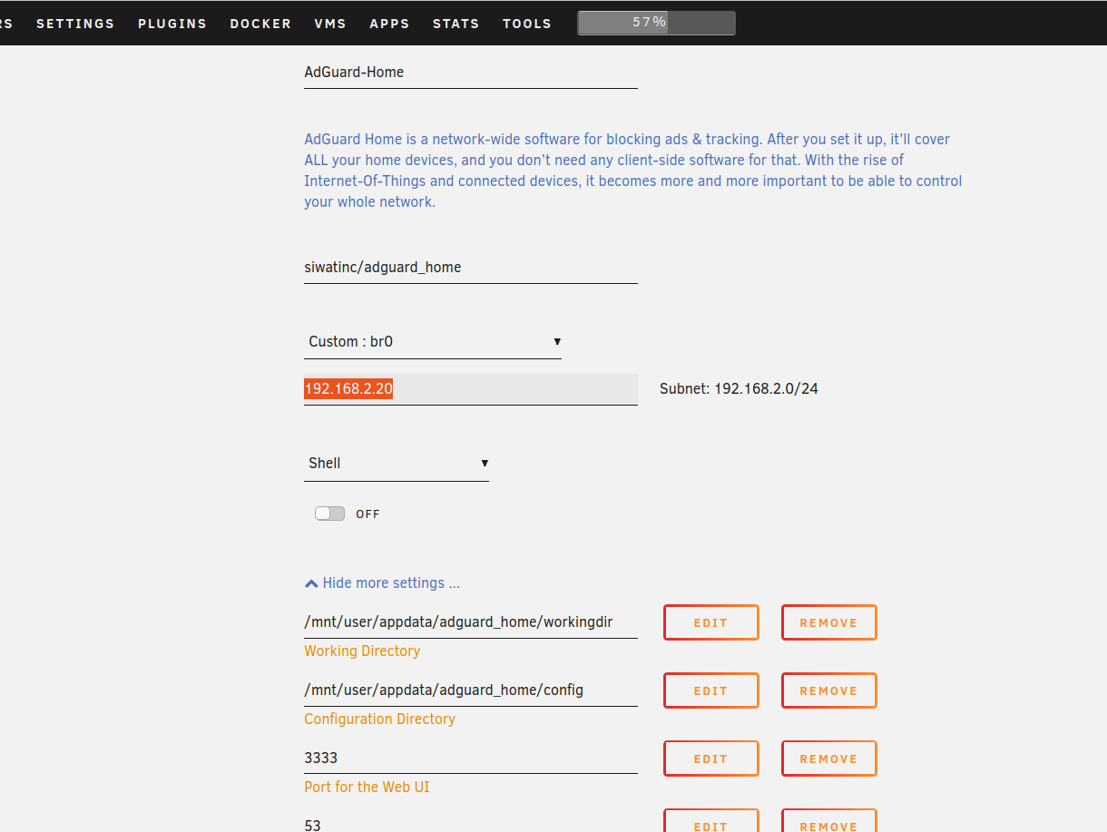

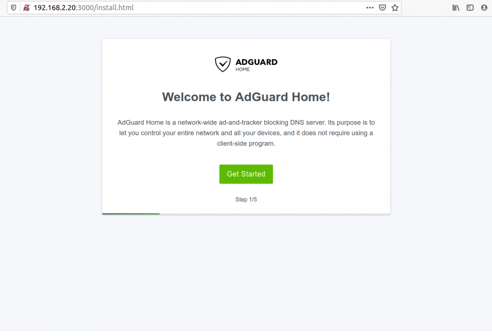

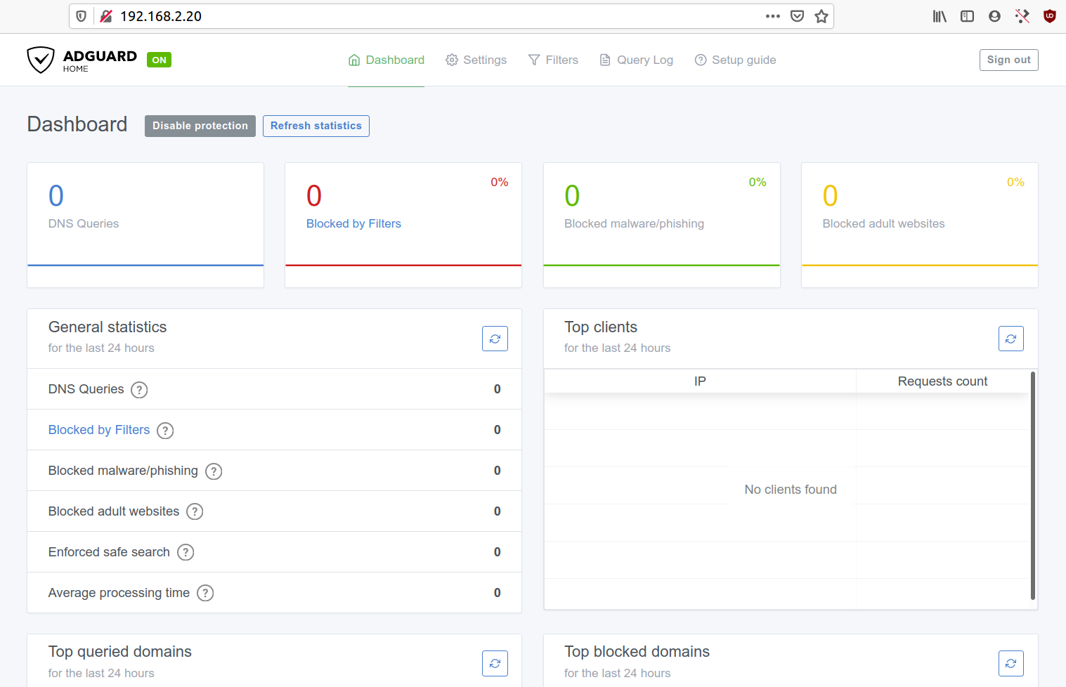

Hi,just give it fixed IP then check the logs will be some errors because missing a file is some directory.
Then just check where is missing the file and create it manual on the desktop and copy and paste in the directory.
Log in in Adguard only with the IP which you set before dont add :PORT number and make the setup of the Adguard and put the ip in your router DNS and thats it.
I stop using it because i buy Pi 3 and install it there because my server sleep from 23h til 07 and i lose internet connection so Pi runs now 24/7 but for a week the docker on Unraid was working and blocking perfect.
Edited by Vesko
Thanks, trying it out now.
You are welcome 😃😃😃
i was on few 🍻 when i got working so i hope works for you.😃
I have given it a IP. The only things I see in the log is:
Nov  9 18:08:58 dragon nginx: 2020/11/09 18:08:58 [error] 25696#25696: *7253 connect() to unix:/var/tmp/AdGuard-Home.sock failed (111: Connection refused) while connecting to upstream, client: 192.168.1.112, server: , request: "GET /dockerterminal/AdGuard-Home/token HTTP/1.1", upstream: "http://unix:/var/tmp/AdGuard-Home.sock:/token", host: "192.168.1.202", referrer: "http://192.168.1.202/dockerterminal/AdGuard-Home/"
Nov  9 18:08:58 dragon nginx: 2020/11/09 18:08:58 [error] 25696#25696: *7273 connect() to unix:/var/tmp/AdGuard-Home.sock failed (111: Connection refused) while connecting to upstream, client: 192.168.1.112, server: , request: "GET /dockerterminal/AdGuard-Home/ws HTTP/1.1", upstream: "http://unix:/var/tmp/AdGuard-Home.sock:/ws", host: "192.168.1.202"
Nov  9 18:08:59 dragon nginx: 2020/11/09 18:08:59 [error] 25696#25696: *7253 connect() to unix:/var/tmp/AdGuard-Home.sock failed (111: Connection refused) while connecting to upstream, client: 192.168.1.112, server: , request: "GET /dockerterminal/AdGuard-Home/token HTTP/1.1", upstream: "http://unix:/var/tmp/AdGuard-Home.sock:/token", host: "192.168.1.202", referrer: "http://192.168.1.202/dockerterminal/AdGuard-Home/"
Nov  9 18:08:59 dragon nginx: 2020/11/09 18:08:59 [error] 25696#25696: *7276 connect() to unix:/var/tmp/AdGuard-Home.sock failed (111: Connection refused) while connecting to upstream, client: 192.168.1.112, server: , request: "GET /dockerterminal/AdGuard-Home/ws HTTP/1.1", upstream: "http://unix:/var/tmp/AdGuard-Home.sock:/ws", host: "192.168.1.202"
Nov  9 18:08:59 dragon nginx: 2020/11/09 18:08:59 [error] 25696#25696: *7280 connect() to unix:/var/tmp/AdGuard-Home.sock failed (111: Connection refused) while connecting to upstream, client: 192.168.1.112, server: , request: "GET /dockerterminal/AdGuard-Home/ws HTTP/1.1", upstream: "http://unix:/var/tmp/AdGuard-Home.sock:/ws", host: "192.168.1.202"
Nov  9 18:09:00 dragon nginx: 2020/11/09 18:09:00 [error] 25696#25696: *7253 connect() to unix:/var/tmp/AdGuard-Home.sock failed (111: Connection refused) while connecting to upstream, client: 192.168.1.112, server: , request: "GET /dockerterminal/AdGuard-Home/token HTTP/1.1", upstream: "http://unix:/var/tmp/AdGuard-Home.sock:/token", host: "192.168.1.202", referrer: "http://192.168.1.202/dockerterminal/AdGuard-Home/"
Nov  9 18:09:00 dragon nginx: 2020/11/09 18:09:00 [error] 25696#25696: *7284 connect() to unix:/var/tmp/AdGuard-Home.sock failed (111: Connection refused) while connecting to upstream, client: 192.168.1.112, server: , request: "GET /dockerterminal/AdGuard-Home/ws HTTP/1.1", upstream: "http://unix:/var/tmp/AdGuard-Home.sock:/ws", host: "192.168.1.202"
Any ideas?

What’s at 192.168.1.202 and 192.168.1.112?

Today i install it on my new installed Unraid and no just works straight away just give it fixed IP and done i think is updated or something.
 Try to uninstall the docker Adguarg then go to Appdata folder and delete the folder Adguard and then install it again and only fill up the ip before pull down the container.Open the logs and look for the last line just copy and paste in browser and should work.add.thumb.png.e91ab3c0f833e8a8a0bc94afb01c111f.png
I just installed it yesterday for the first time. 202 is my Unraid server and 112 was the laptop I was using to access the GUI.
Delete everything how i explain in previous post and install again and will be fine.If 202 is your unraid IP then give another IP 200 maybe to Adguard dont give same IP to the docker.

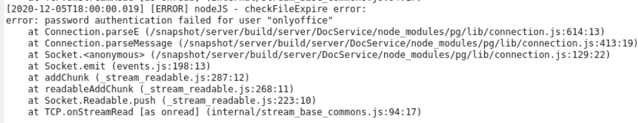

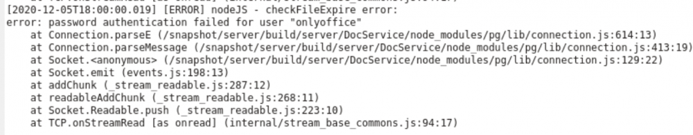

Hello.  I had the OpenOfficeDocumentServer working well until the most recent update.  Now I cannot connect. Not sure what changed. Using reverse proxy through SWAG.  When I try to hit it via command-line, here's what I get:
wget https://docserver.myserver.org
--2020-12-05 11:55:55-- https://docserver.myserver.org/
Resolving docserver.myserver.org (docserver.myserver.org)... xxx.xxx.xx.xx
Connecting to docserver.myserver.org (docserver.myserver.org)|xxx.xxx.xx.xx|:443... connected.
HTTP request sent, awaiting response... 400 Bad Request
2020-12-05 11:55:55 ERROR 400: Bad Request.
Been googling around.  Tried reinstalling container.  Copying over the key files again.  Restarted SWAG.  Same result.  Document Server was working perfectly before the update and its error logs are empty.  SWAG's error logs don't seem to show any problems with the document server access.
Any ideas out there?
UPDATE:
Getting this error too, but unsure if its related...
Not sure what this is referring to...
