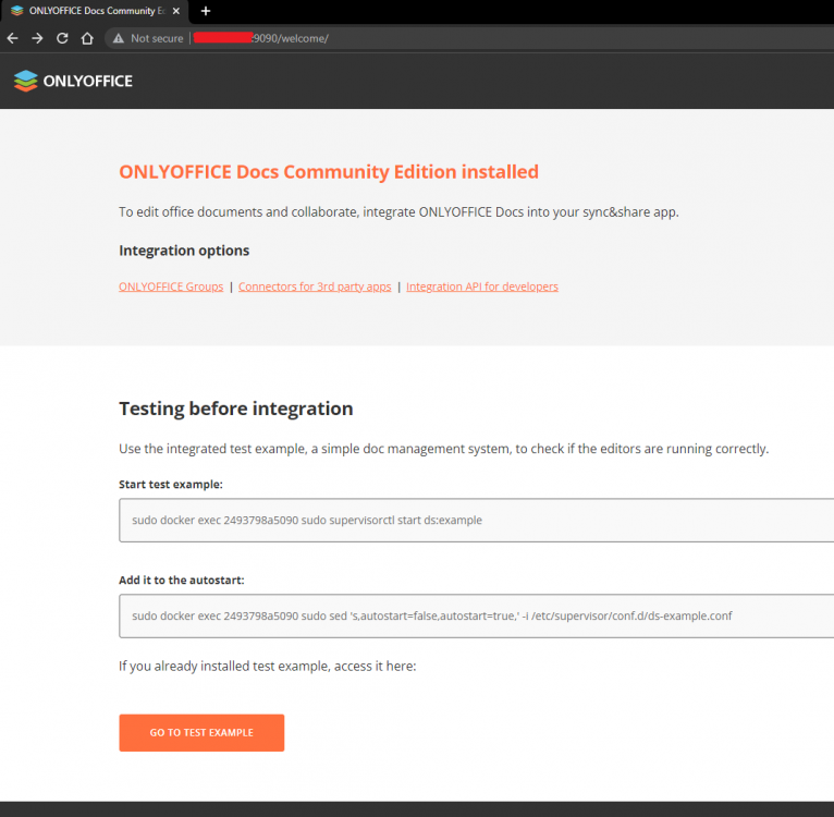

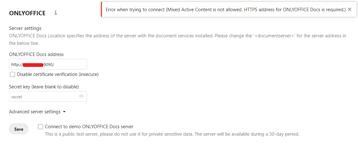

I installed the ONLYOFFICE Document Server. I can access it with http on local but I can't access it using https on port 4430. I want to add this on nextcloud and it doesn't let me add using http on the nextcloud settings. Also tried to check "Disable certificate verification" but no avail.
Did you install the ssl certificate?
Where should I get these? I'm just using free cloudflare free ssl and when I check on it, I only have the .pem file, not the .cert file. Sorry I'm not as technical as you are. 😔
Look at this. https://hub.docker.com/r/onlyoffice/documentserver/ section "Running ONLYOFFICE Document Server using HTTPS"

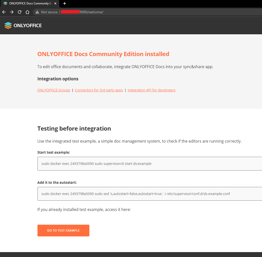

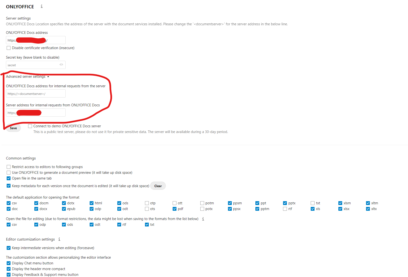

Thanks. I follow the guide and I successfully integrated ONLYOFFICE with my Nextcloud. However, I can only access ONLYOFFICE in http locally. How can I access it in https locally? Because I want to use it on internal request:
This is the files that I followed on the guide. Did I miss something?

I manage to access the webUI through the local IP and https port, but not the http one. And clicking on WebUI from the unraid docker page redirects to the unraid's login page. Is that normal ?
I could even test OODS with the provided example.

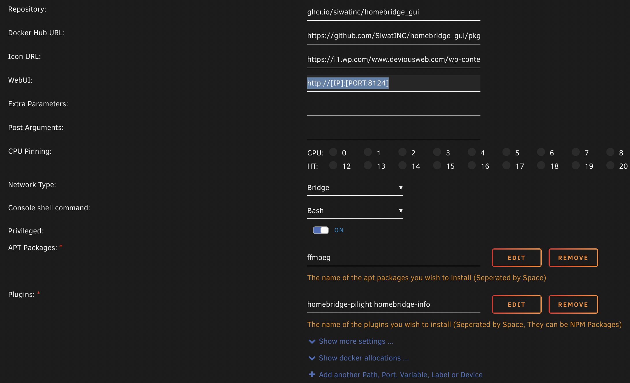

Hey using the homebridge with gui and I feel like this is a really noob question, but how do I access the gui?  I'm seeing that the WebUI setting is set to: http://[IP]:[PORT:8124], but using my local IP on port 8124 is giving me Connection Refused.
Here are my settings
EDIT: Great news, I got this working by adding a new port in the advanced settings.  I just added it with the container port and the host port both as 8124.
