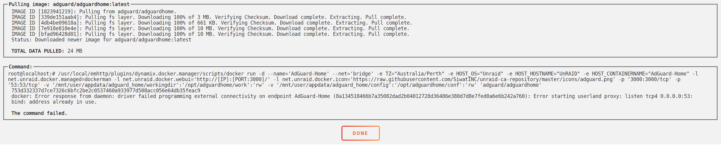

Trying to get adguard up and running using the defaults in the template, it give me the error attached. I have no other dockers using port 53
I can run it with network type: custom but I'd rather keep it clean if I can. Running unRAID 6.10 RC2

    Yeah i have the same. I havent had time to look into this as yet but a quick fix is roll back to the earlier container. In the template change repository to add :6.0 on the end so onlyoffice/

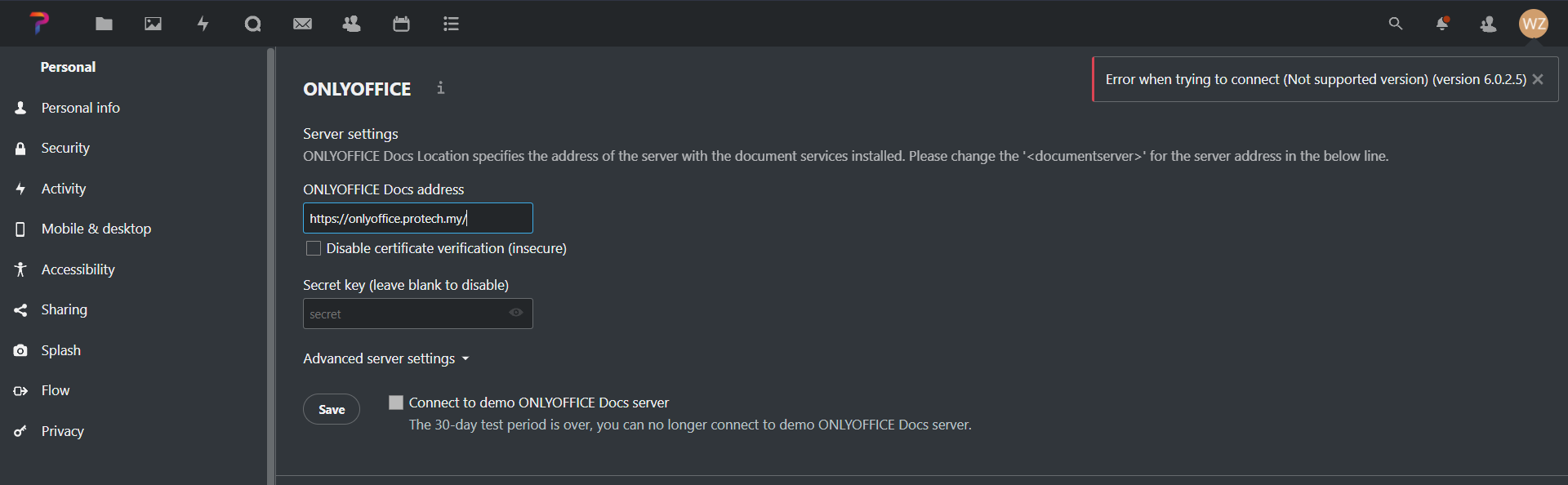

9 hours ago, Wong said:
Error when trying to connect (Not supported version) (version 6.0.2.5)
Does anyone have this same error? I not sure when the error started but I just realized it today. It was working fine for me before.
I got the same issue. It comes from a compatibility issue between the NC oO app and the only office server. You have to manually downgrade the NC app.
I don't remember the details but you can find it easily if you google it.
I remember you need to delete the oO folder in nextcloud/app folder, downloads the right version of the only office plugin and untar it there. You might have to reactivate it from nextcloud admin page. Then it works ! You just have to not upgrade it ;-)
Hope it helps,
Kam
I just ran into this issue this morning upon my first run of AdGuardHome.  FOund this on the home page:
https://registry.hub.docker.com/r/adguard/adguardhome#resolved-daemon
37 minutes ago, Siwat2545 said:
This error will occur when the container is set to use host or bridge network, you must use brX (br0, br1, etc...)
I tried setting it to br0 which does get the docker running, but I could not access the web ui - making sure to set a static IP available on my network first!
Disregard!  I can access it now.
Edited by MrDecepticon
can you try port 443(https://) /80 (http://) /3000?, try all of them.

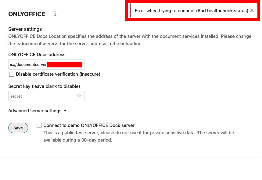

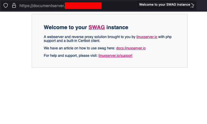

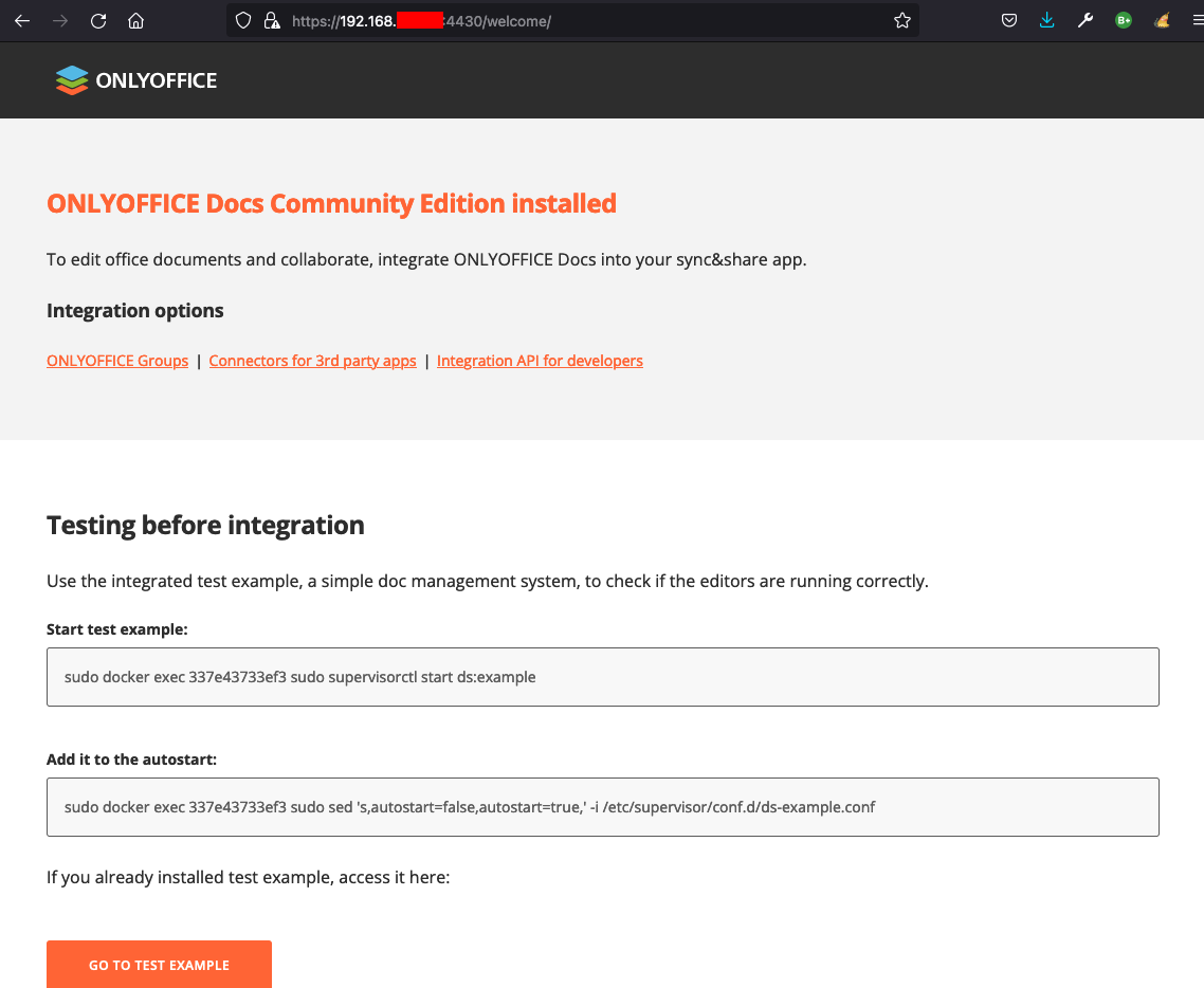

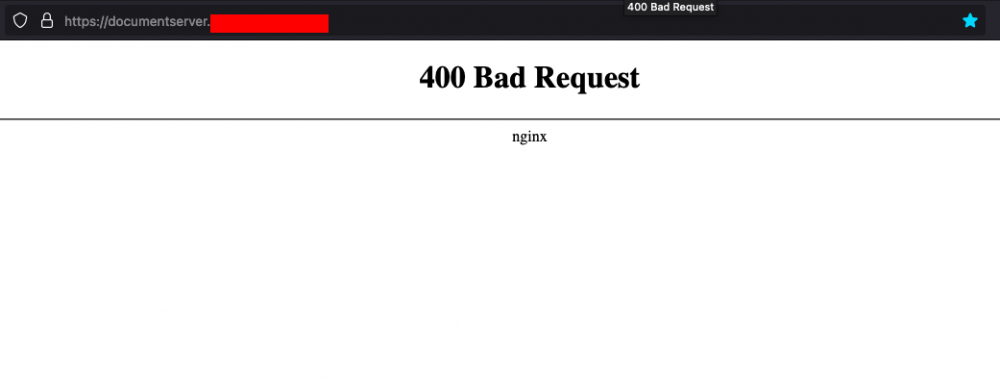

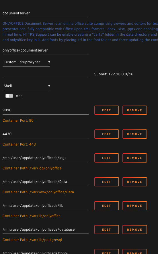

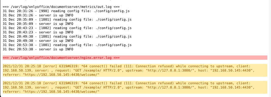

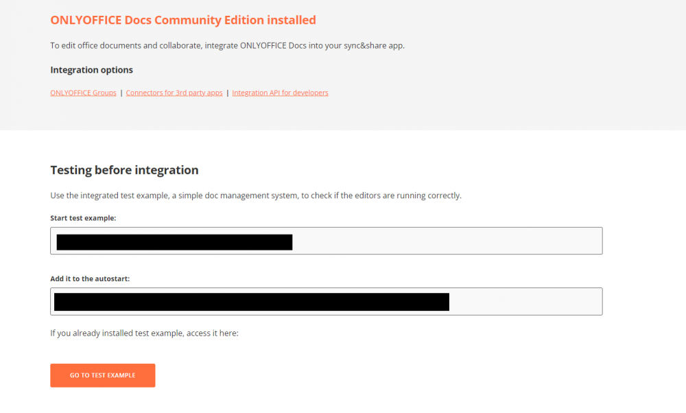

Hi @Siwat2545, I'm having a difficult time finding a solution to get onlyoffice to work.  I followed spaceinvaderone's video and have gone through many posts and suggestions but none gave a full solution. I'm really lost as to what I may be doing wrong,  Can you help shed some light?
My latest status:
I can access onlyoffice uring local url using port 4430
If I have: "listen 4430 ssl;" (In the onlyoffixe.subdomain.conf) and try the subdomain URL, I get  "Welcome to you SWAG instance"
If I have: "listen 443 ssl;" (In the onlyoffixe.subdomain.conf) and try the subdomain URL, I get  "400 Bad Request"
Attached are some screenshots and diagnostics.
Can you please look over and help me to know what I may be doing wrong?
Thanks!

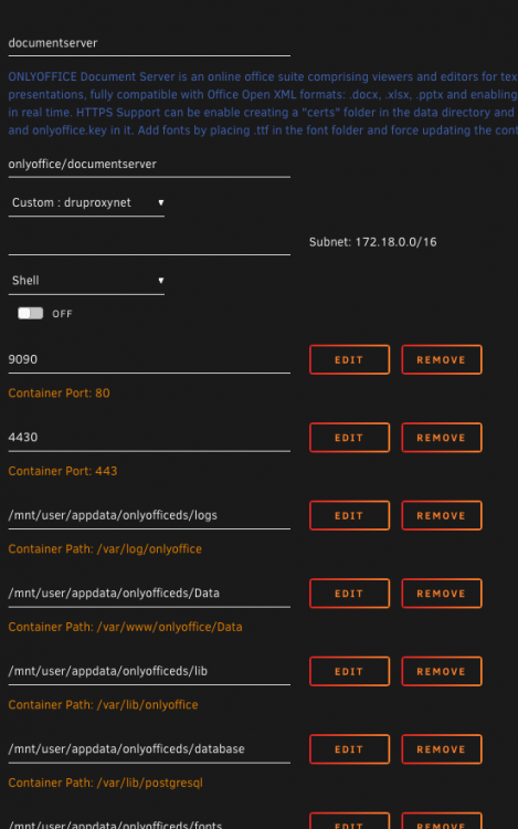

My latest status:
Thanks!

More than likely your .conf file is wrong.  if you are using Swag there is an updated conf file a page or so earlier that worked great for me.  I still don't have this fully sorted out yet, but that should get your reverse proxy working properly.
On 2/28/2021 at 4:25 AM, showstopper said:
# only office doc server
server {
    listen 443 ssl;
    listen [::]:443 ssl;
    server_name external_dns_subdomain.*;
    include /config/nginx/ssl.conf;
    client_max_body_size 0;
    location / {
        include /config/nginx/proxy.conf;
        resolver 127.0.0.11 valid=30s;
        set $upstream_app OnlyOfficeDocumentServer;
        set $upstream_port 443;
        set $upstream_proto https;
        proxy_pass $upstream_proto://$upstream_app:$upstream_port;
        proxy_max_temp_file_size 2048m;
Thanks @dbs179!   This worked for me!
Really appreciate it.

If anyone is having problems with the spaceinvader guide getting the 400 error
***proxy_set_header Host $host;***
This right here is the problem!
Comment that out, and it'll work, I don't know why, I don't know what it does, but that's the problem!
You'll also need to comment out
proxy_redirect off;
Because it gives that line 19 error, not sure what that's about either, but the logs point straight to it so I can see people have worked it out.
But
#                proxy_set_header Host $host;
That's the poison causing the 400 error.
******For bonus points, those wanting to secure their onlyoffice, you need to add the following to the onlyoffice docker*****
