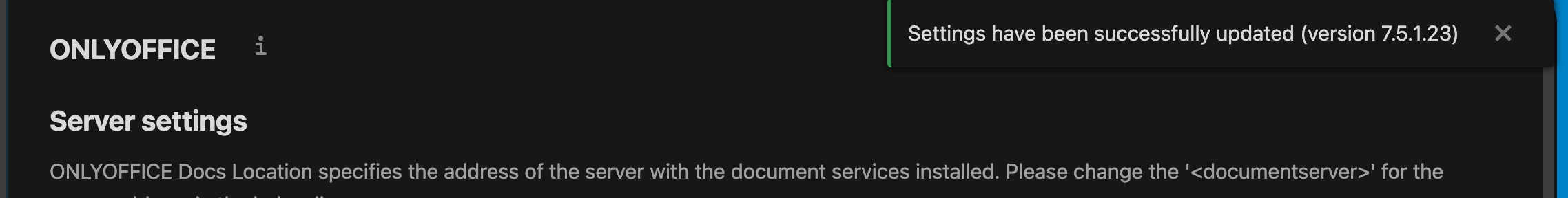

  • I had quite a bit of trouble getting OnlyOfficeDocumentServer to work with nextcloud and letsencrypt. So I had letsencrypt install for plex etc and got it working with nextcloud. The confusing part of
  • So finally, I found a solution ! 🤩 I checked my nextcloud.subdomain.conf and added/removed everything so both files were similar.   In case someone has the same issue, here's my onlyoff

Here is the error I am getting.  Running a reverse proxy.  Have it set up for several other dockers and it works fine for them.
Error when trying to connect (cURL error 6: Could not resolve host: documentserver.XXXXXXXX.com (see https://curl.haxx.se/libcurl/c/libcurl-errors.html) for https://documentserver.XXXXXX.com/healthcheck)
When I try the Curl.haxx link it says This Resource is Gone! I really need to get this working as my wife is now working from home and needs it for her job.
Update, all of my URLS are working.  Still getting the above error.  I thought maybe it's a DNS propagation issue.. not sure. cURL cannot find my server though.  Yet, my browser can, just fine. And the cert is valid at that.
Self-Solved.  DNS was still propagating.  Seems to be working now. 🤞

cant get docs to load on NC + OnlyOfficeDocumentServer + Cloudflare
543776791_Screenshot2024-01-09at11_39_26PM.thumb.png.99fbbc04df1c66c4055f00e5fa5d8eba.png
trying to edit docs result in
docserver.mydomain.com refused to connect
/healthcheck = true
 anyone currently running NC/ODS send help!
Edited by Tolete
